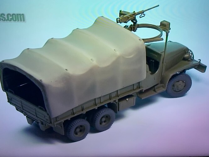

Talking of colors, just watched a “how to” vid on finishing canvas tarps on a WW2 GMC truck.
He used a combination of Vallejo panzer aces paints; canvas, then splinter and stencil to gradually lighten the base.
Has anyone used these on a ‘90’s era truck? (Thinking ODS)
Or is the color completely wrong?
I found this early ODS image for comparison. Not too different to the top image, with maybe a brown wash?
