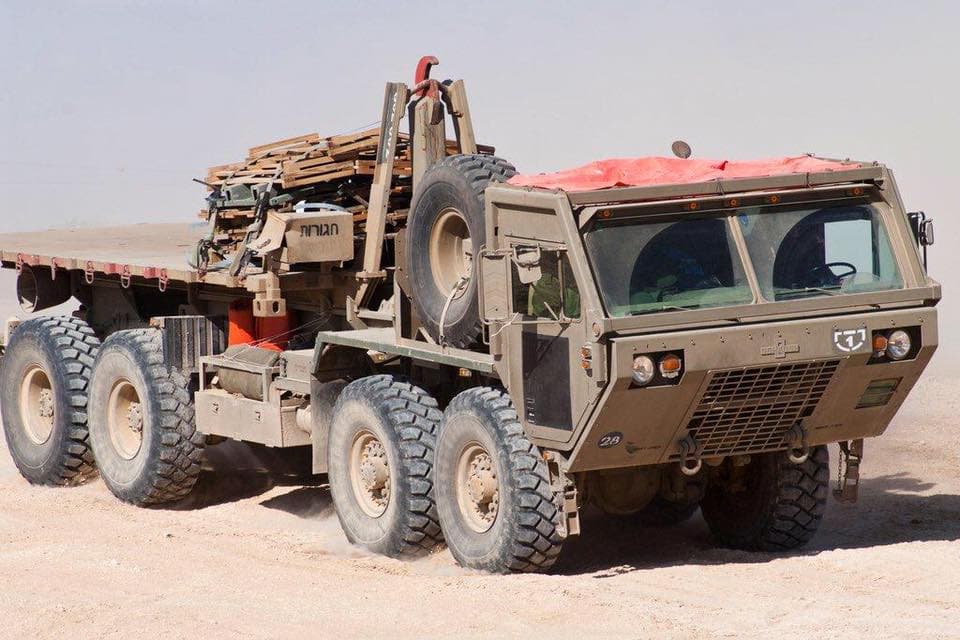

At some point in time the IDf replaced the cranes at the back with a locally produced one
Lots of variants and configurations, I am no HEMTT expert so I cannot distinguish between the variants, I can only recognize the fuel tanker.

Most of the ones you show above are M1120A2s with the arm for lifting flatracks. The one with the locally-made crane is a recovery/wrecker version. That is why it has a shorter bed; to hold an engine or other parts.
The only M977A2/M985A2 cargo versions you show are these.
