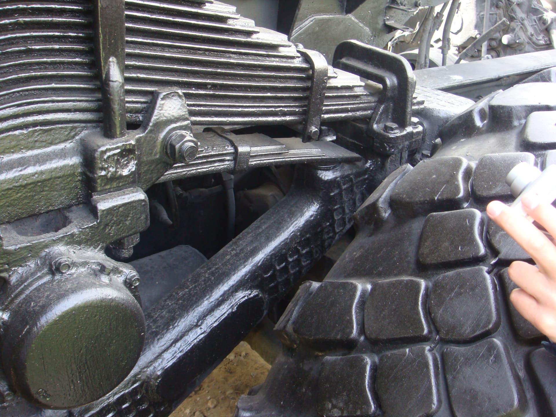

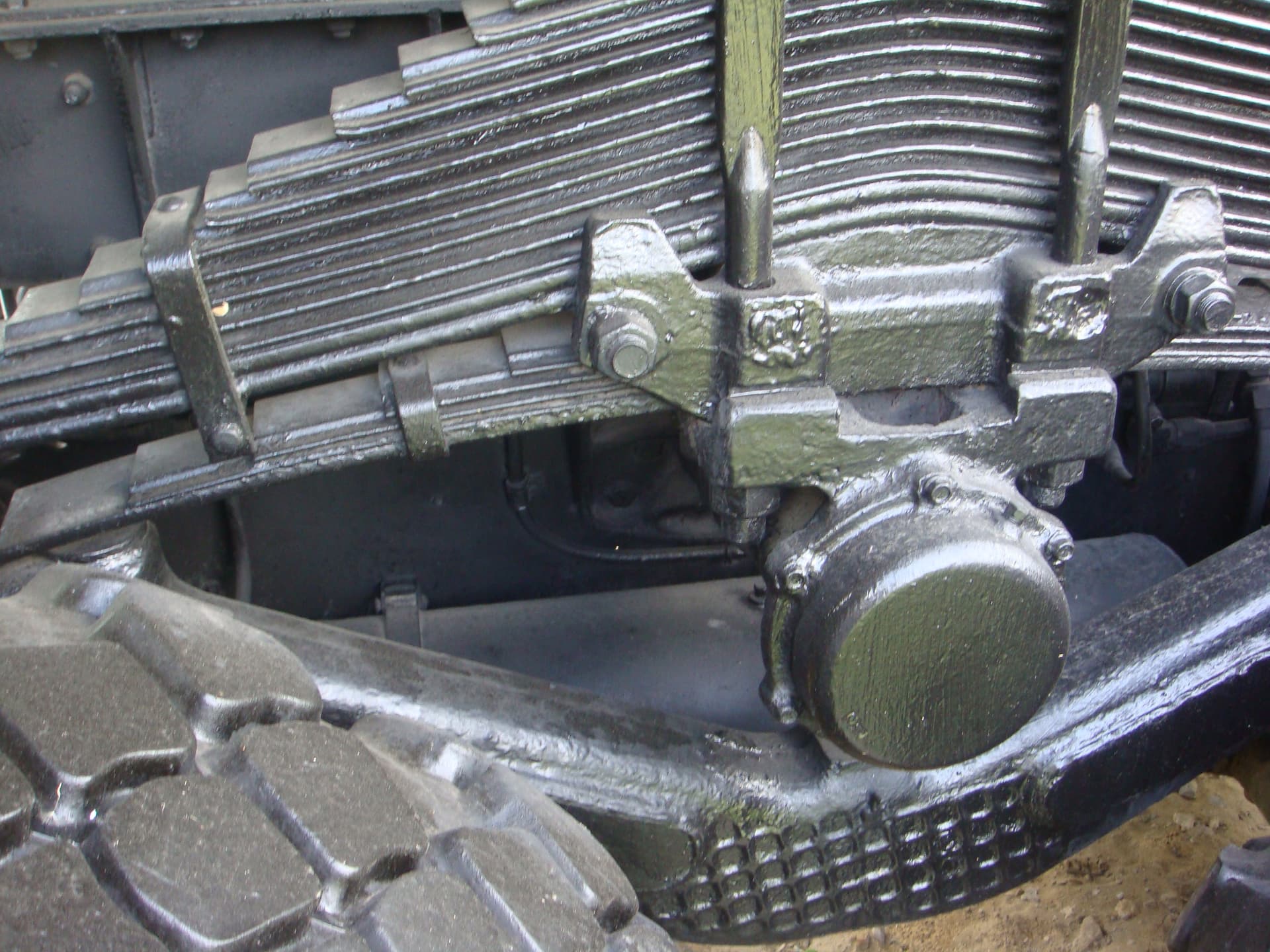

I really like the sprung rear suspension of the 7410 as opposed to the harder riding “Walking Beam” suspension of the 537. I have no explanation, I just do.
I also like the more closely coupled rear axles and those big “Saddle Bag” gas tanks.

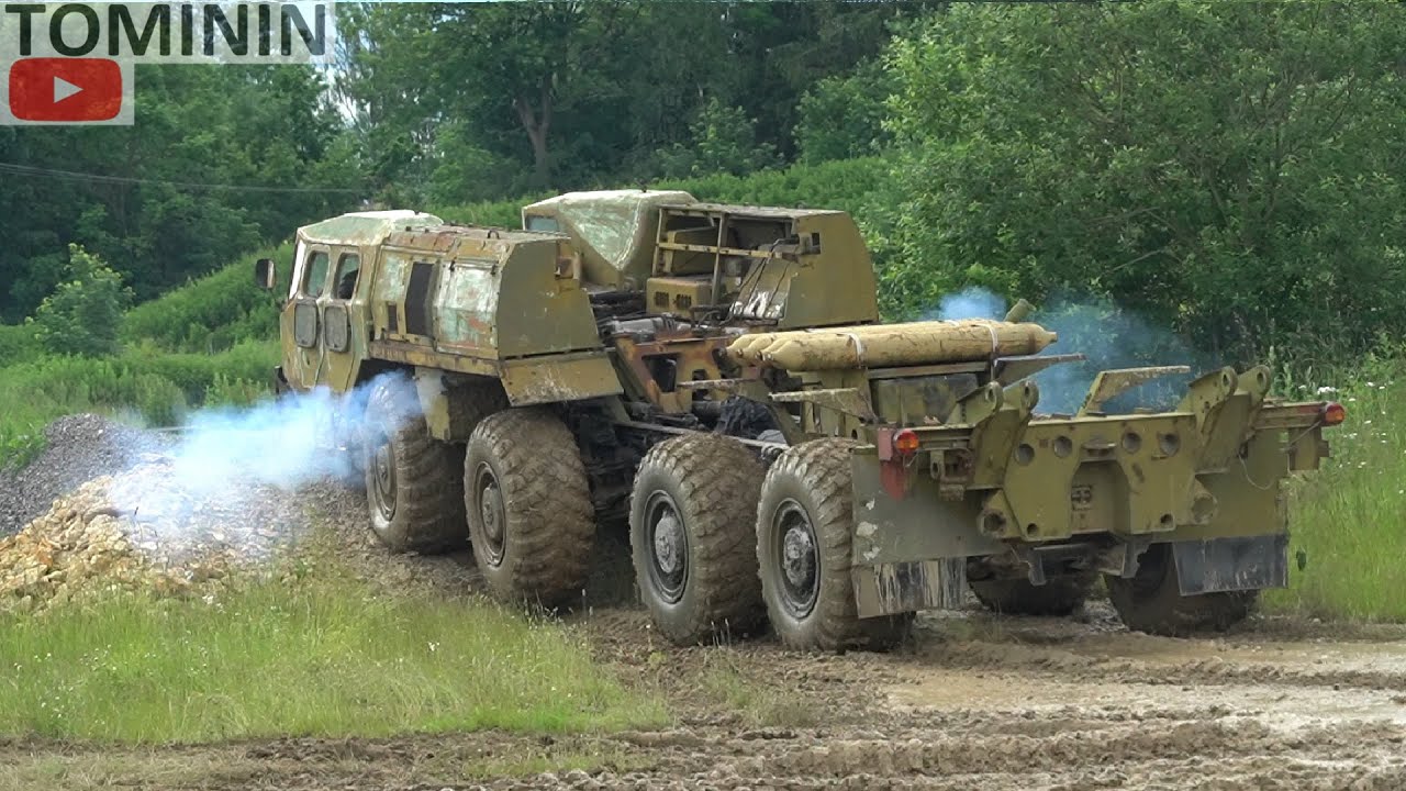

Somewhat interesting YouTube video by Tominin Video on the MAZ-543. I think they might incorrectly describe it as a 7410 but I suspect this vehicle used to be a Scud Missile TEL. It has the longer chassis with torsion bar suspension on all eight wheels. Regardless, that central equipment area behind the cab seems to be totally devoid of anything necessary to the operation of the truck.
