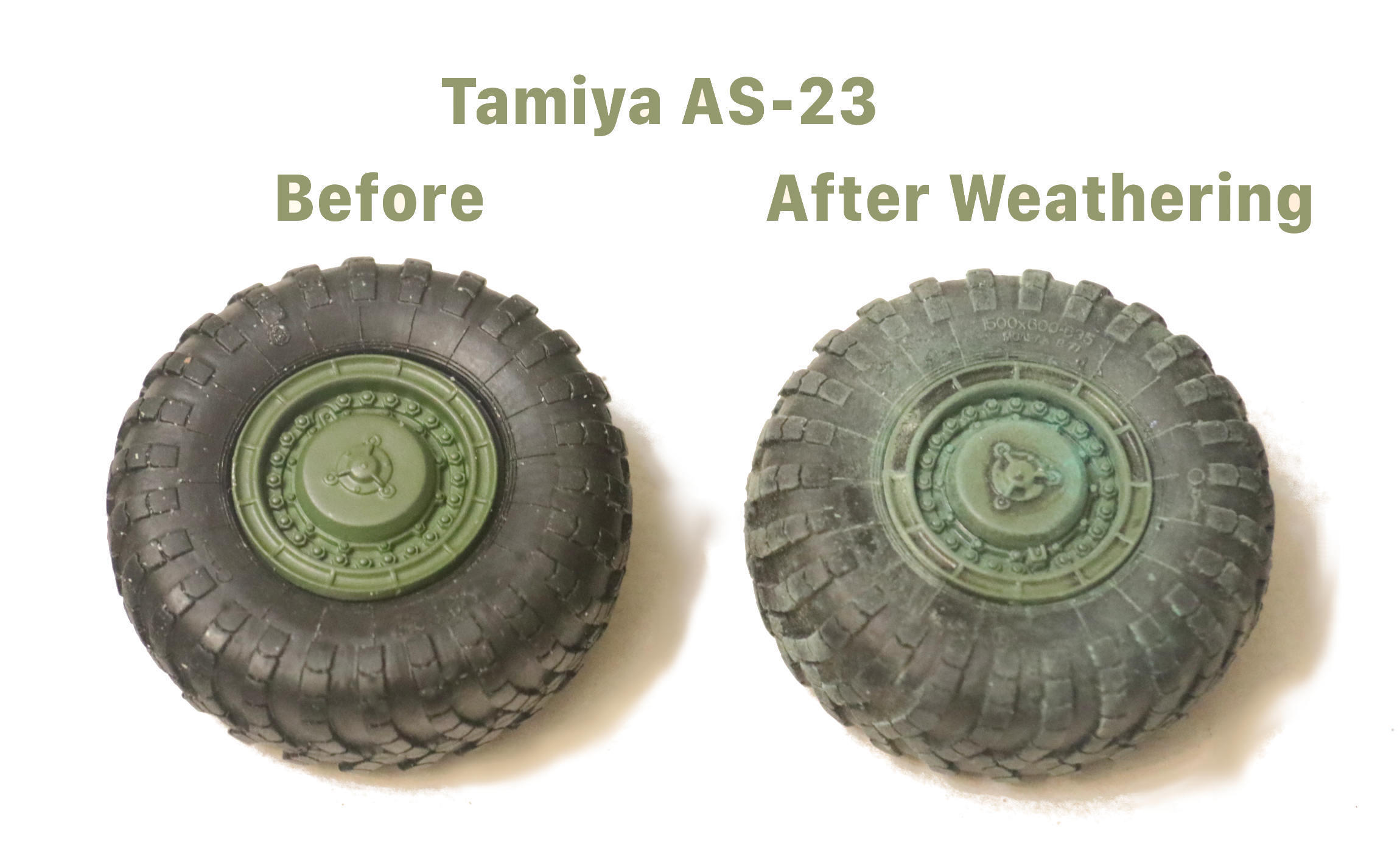

After talking to Brian at Scale Reproductions in Louisville he suggested AS-23 Light Green - Luftwaffe. Saying that the color needed to have more a greenish cast to it. Also he correctly commented that after some of my pin washes and my usual dusting I can probably make the color shift in most any direction I would want.

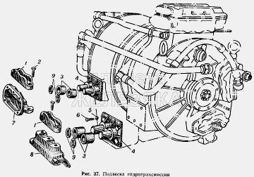

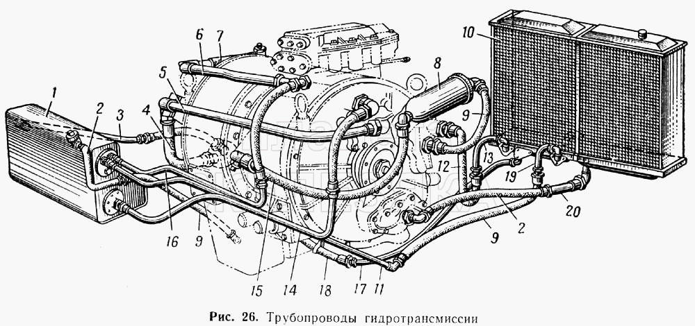

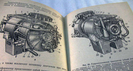

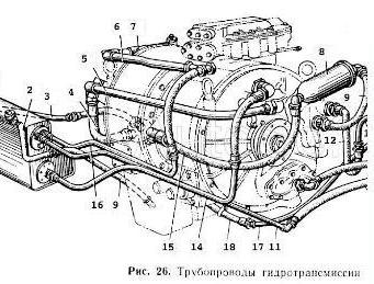

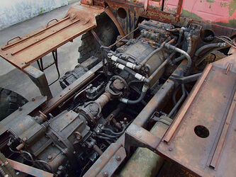

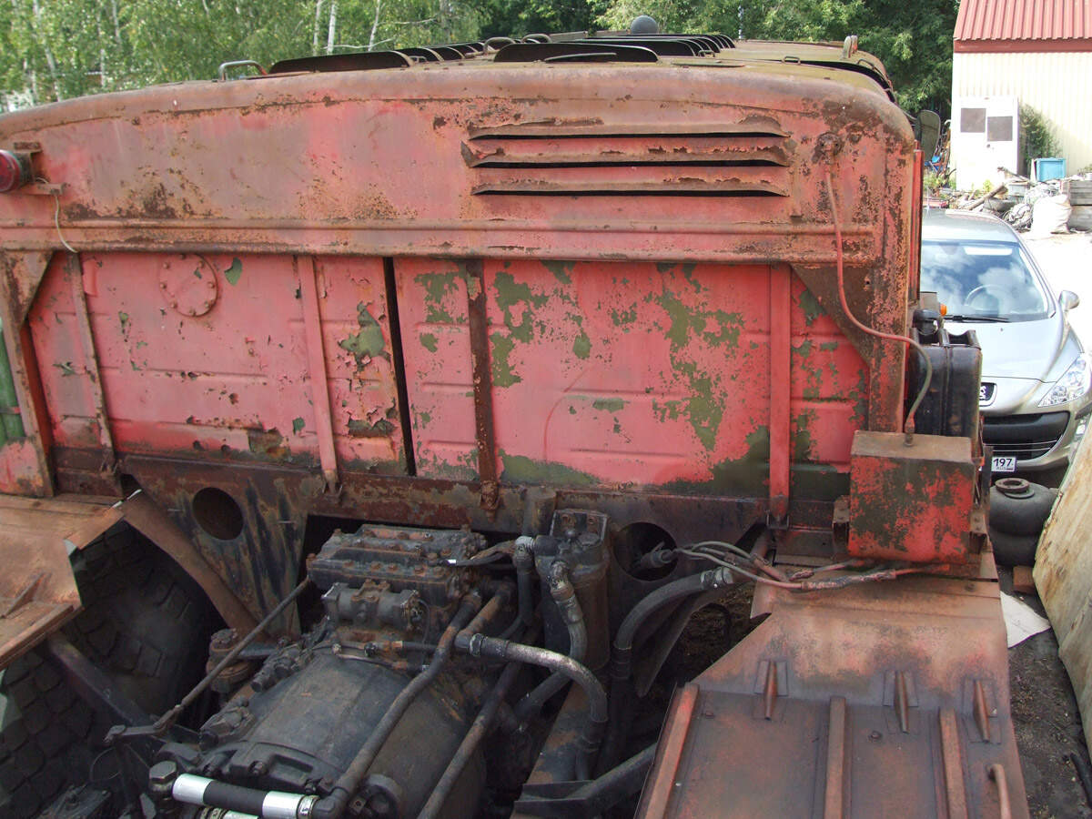

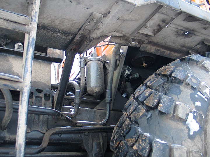

Some Transmission Piping Reference:
10395fb59f961fce6e2d7e64037
The earlier 537 had separate radiators/coolers for both the engine oil and the transmission oil as seen here. So far I have not found evidence of such coolers on the 543 / 7410. but they may all now be built into that one single huge front radiator on the 543.
My Suburban (USAF Surplus) had a transmission oil radiator built into the main radiator but you could not tell it was there except for seeing the additional oil lines running to it.
It may just be that these extra oil coolers where simply considered unnecessary given the large oil reservoir connected to these sub-systems acting as a massive “heat sink” to naturally cool the whole thing.
manual_maz537_280312Crop
Click on the photo to enlarge.

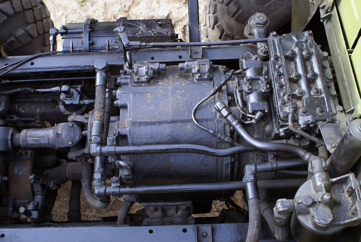

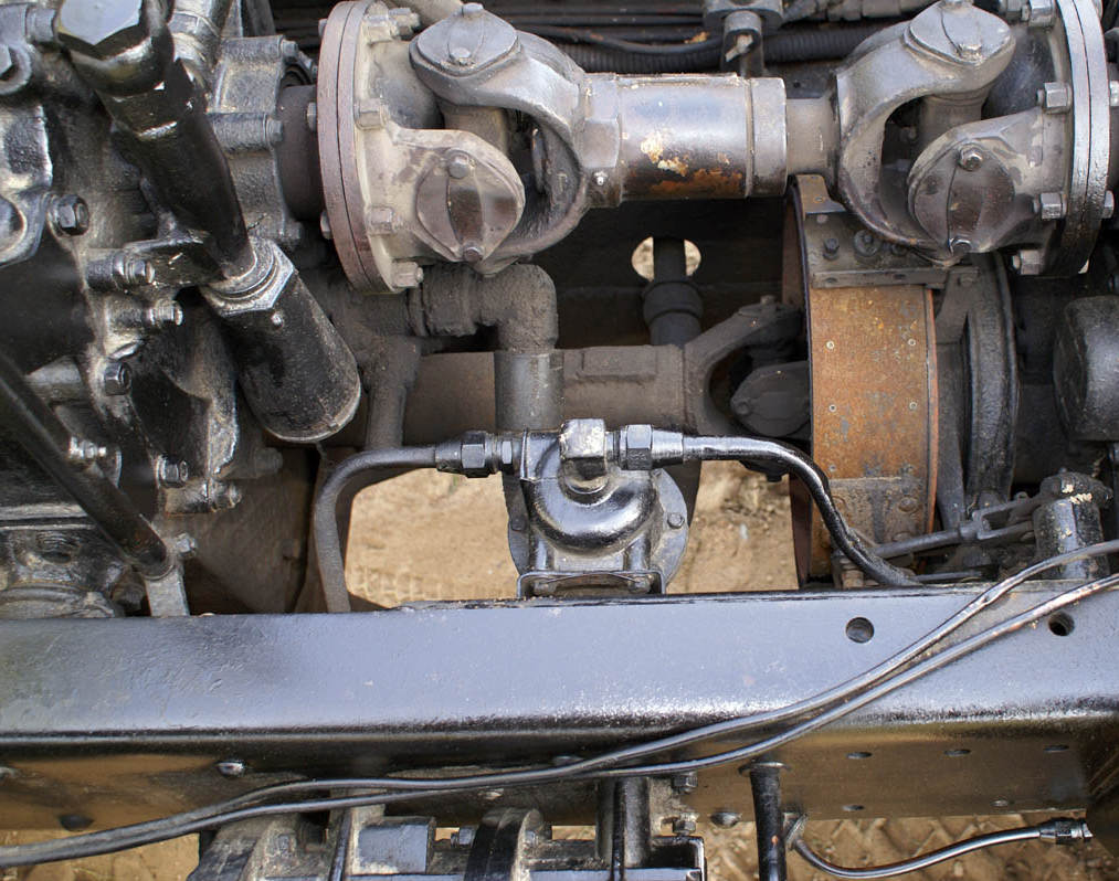

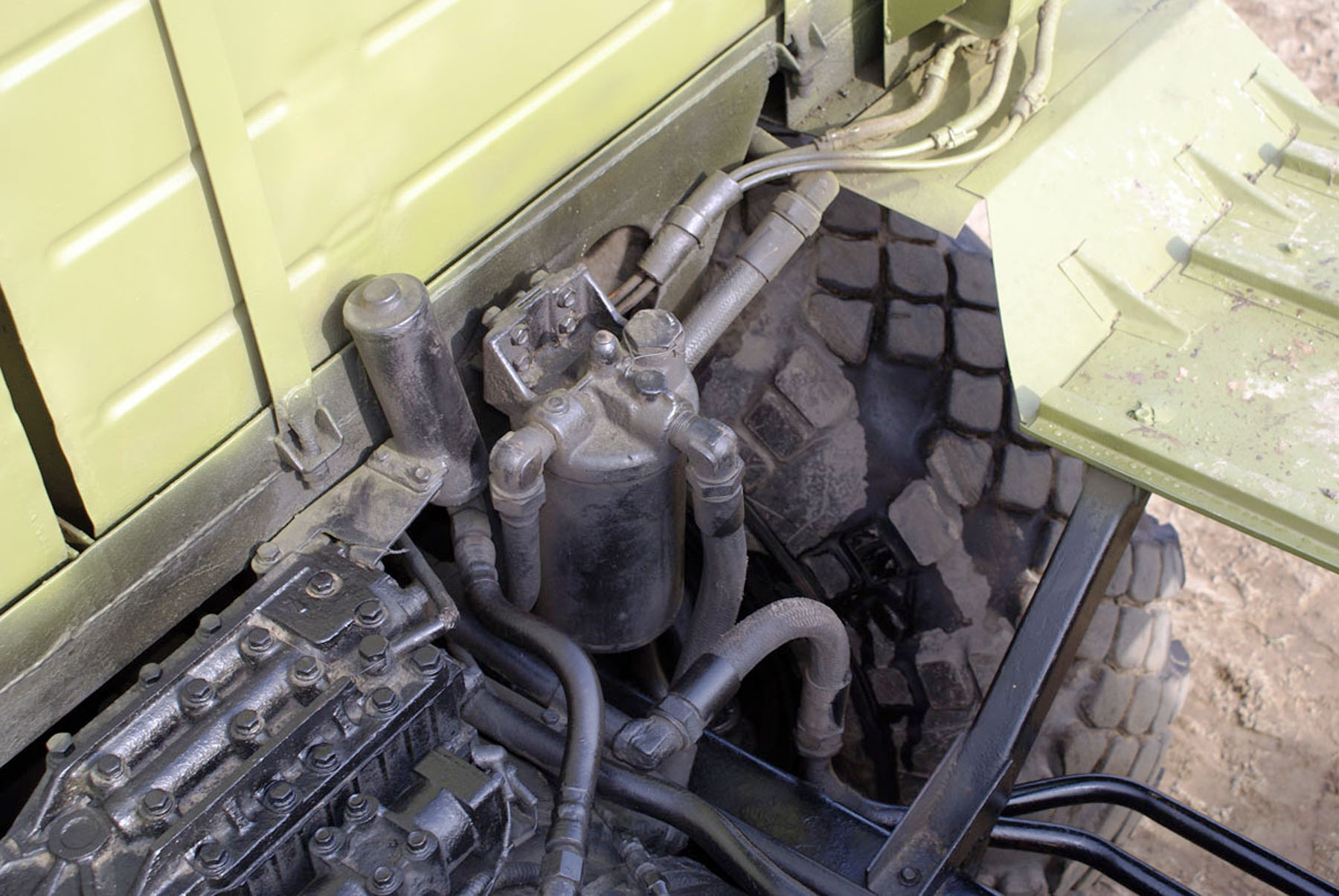

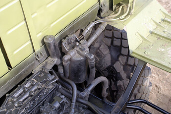

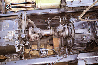

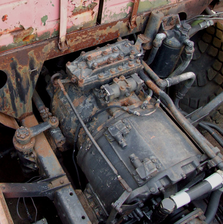

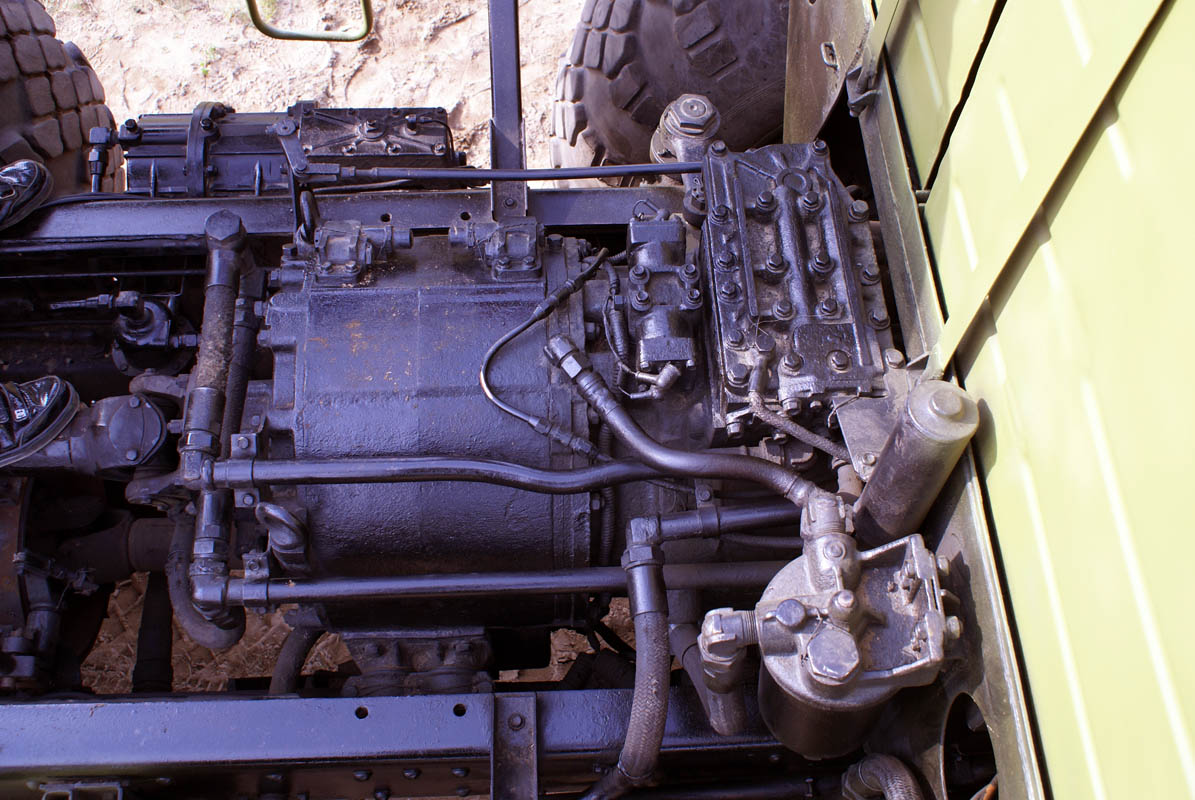

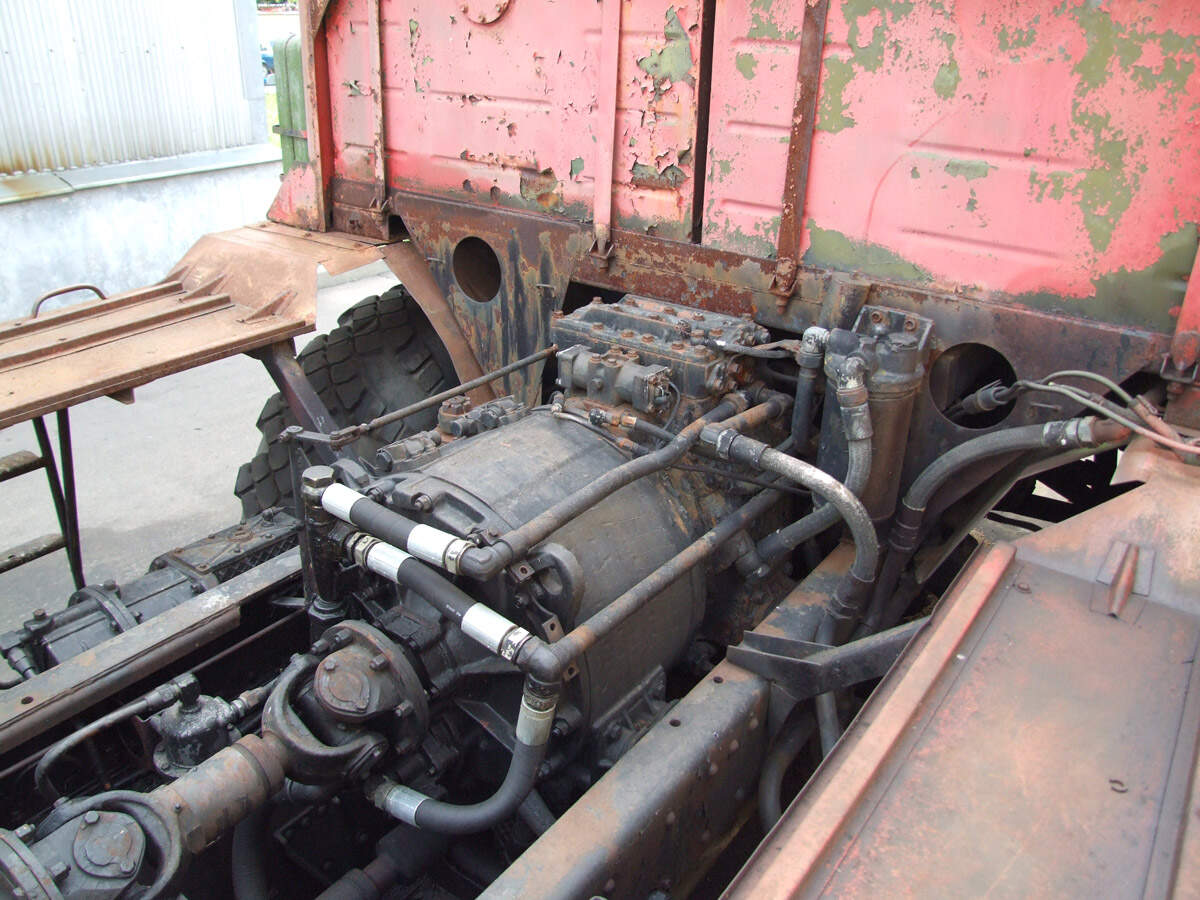

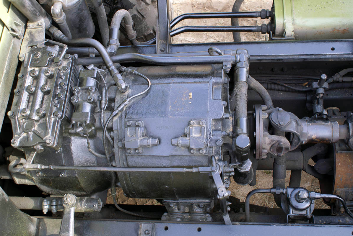

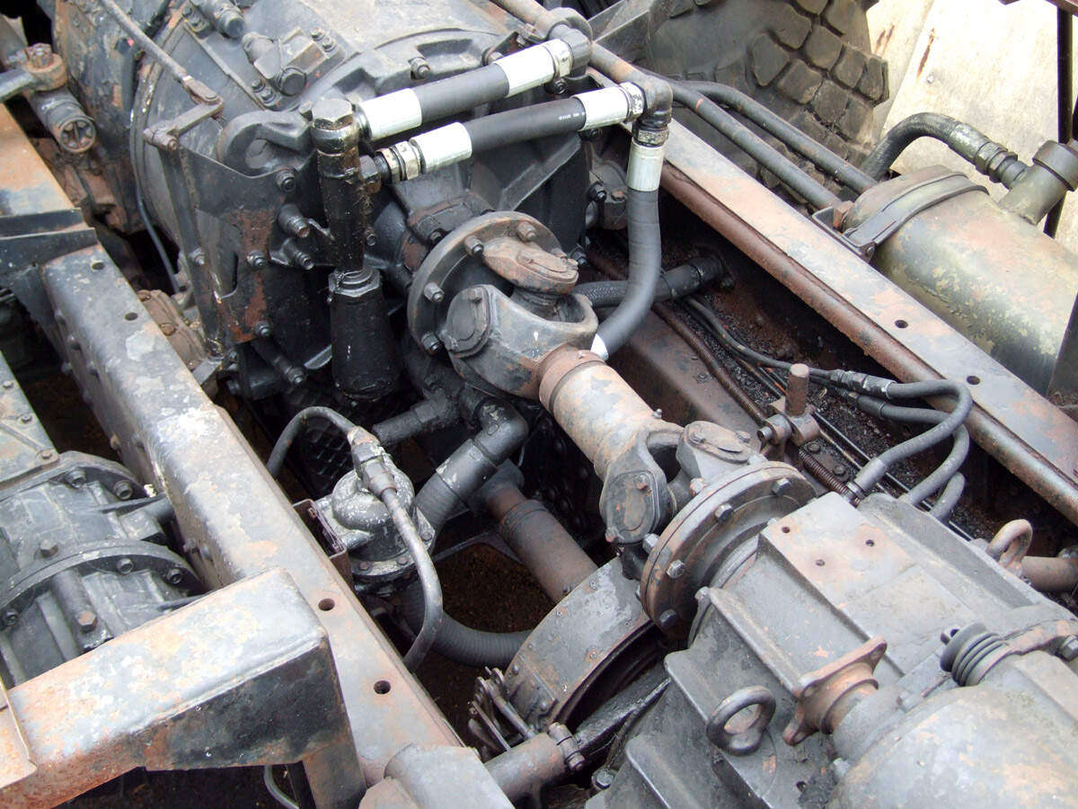

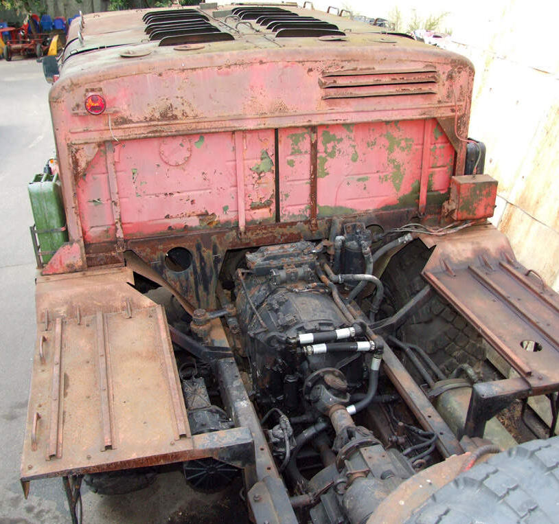

More Reference on those hose connections for the Transmission:
These reference photos are all of the MAZ-537 but the transmissions and transfer cases on both vehicles appear to be of the same design.

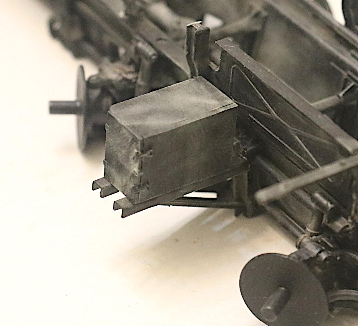

Been doing some General “House Keeping” Chores around the Chassis the Last Few Days:

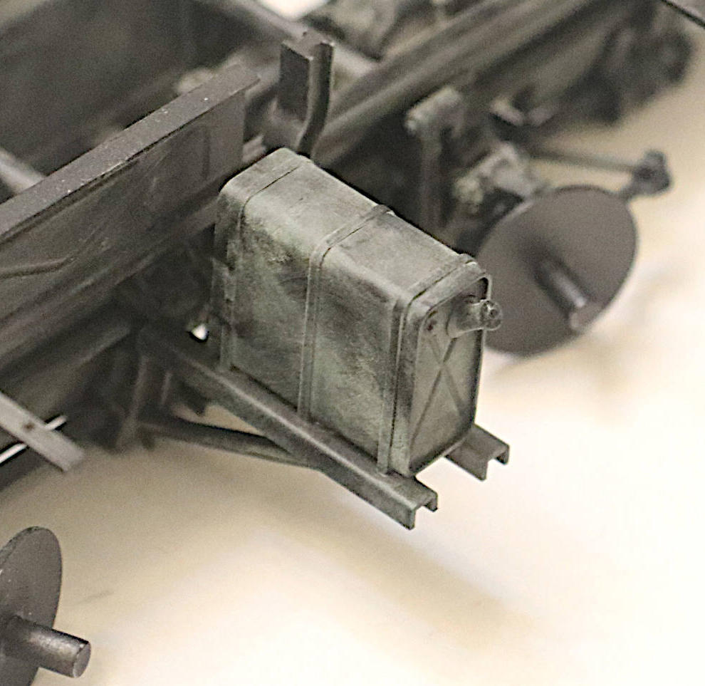

Built the oil reservoir and it’s supports:
And the Tool Box plus the support arms:

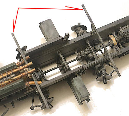

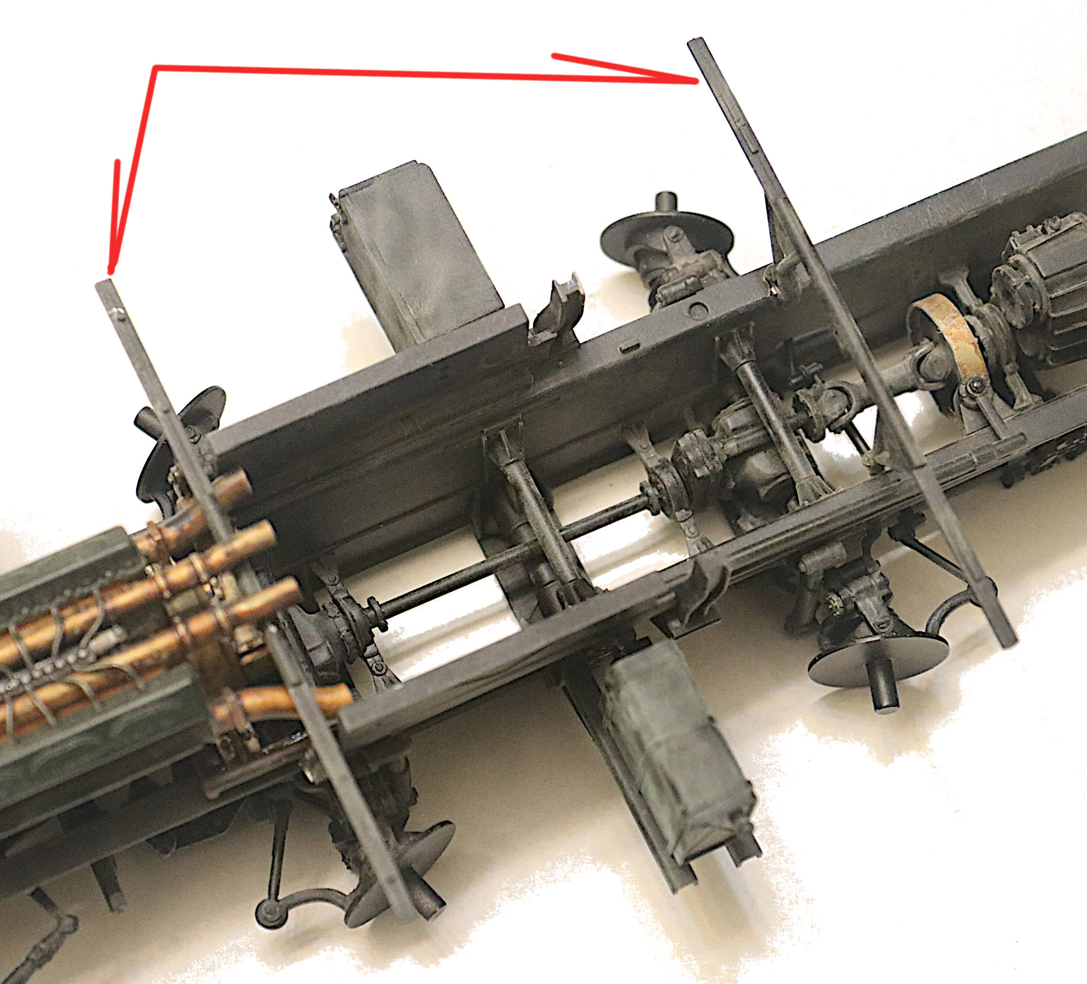

Installed the Fender Braces:

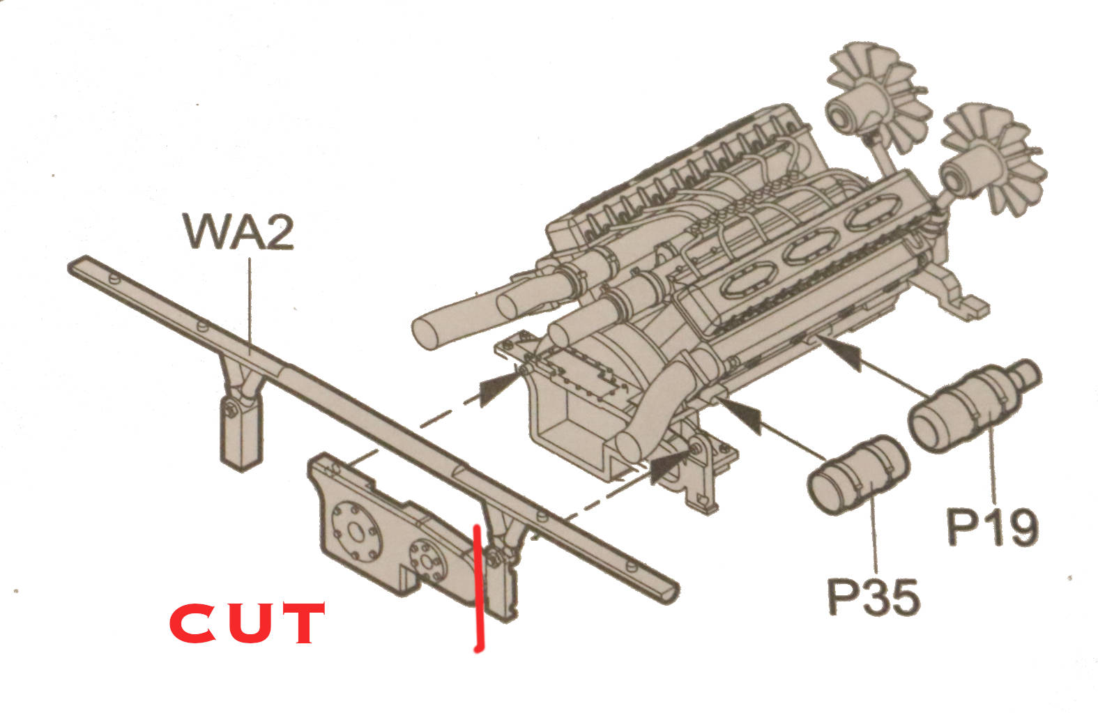

That forward fender brace was actually molded as part of the rear engine gearbox, ?? WHY ?? and intended to be installed much earlier back in Step #9. However, at that time, I separated it from the gearbox because I did not think it was such a good idea to have a thin delicate part such as this sticking out all that time with no other large parts to “protect” it.
- - - Seen here in Step 9:
Minor Detail Added:
I opened up the radiator fill / check access port and will eventually build the radiator overflow tank and cap to be visible directly below it.
I considered hinging that entire forward hood section to allow it to open but there really is nothing of much visual interest under there so I decided not to.

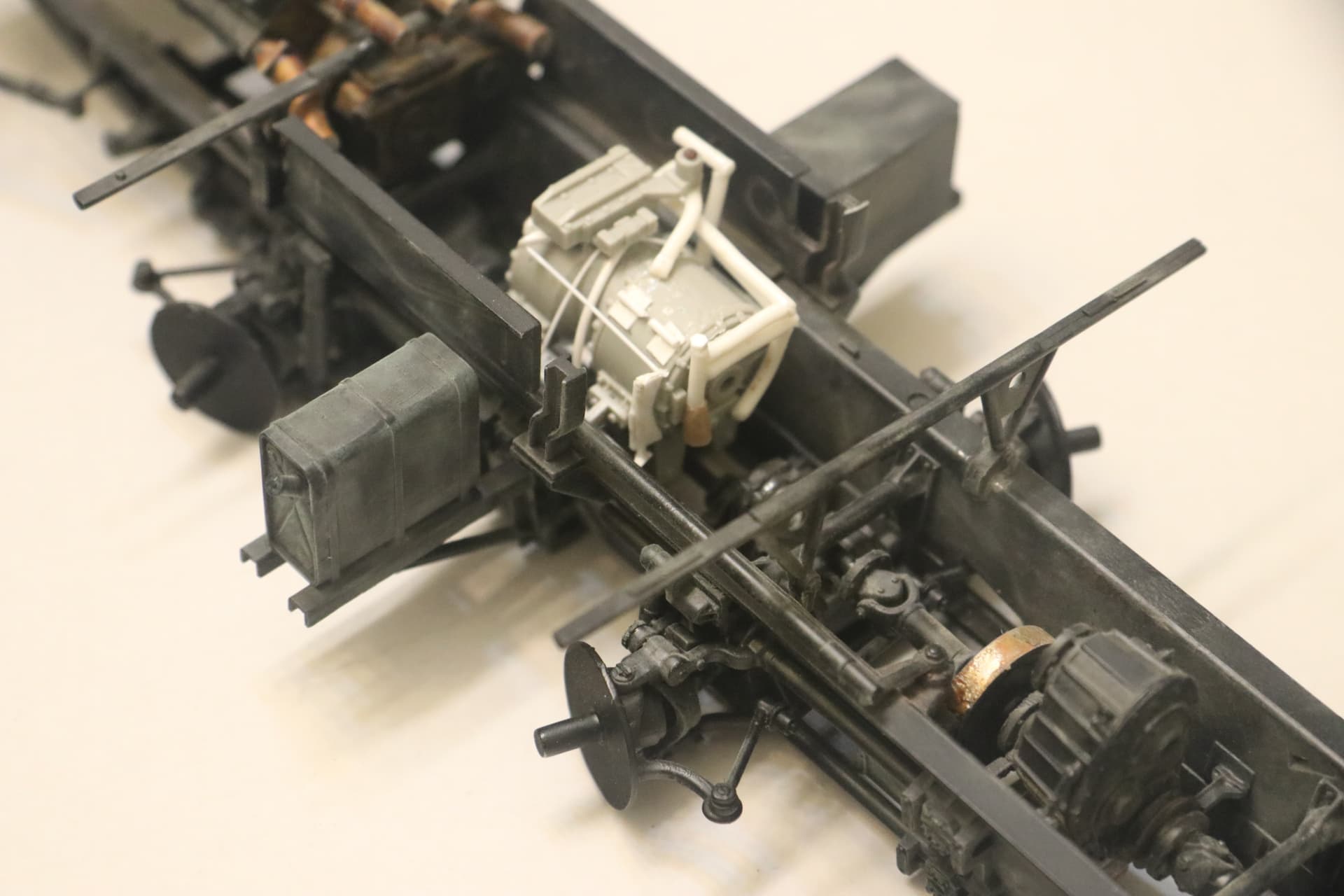

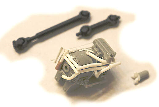

Have Begun Working on Detailing that Transmission:
Next up will be those monster gas tanks - plus some hoses and control rods for the transfer case -
AND building that PTO to add to the top of the transfer case for powering the winch.

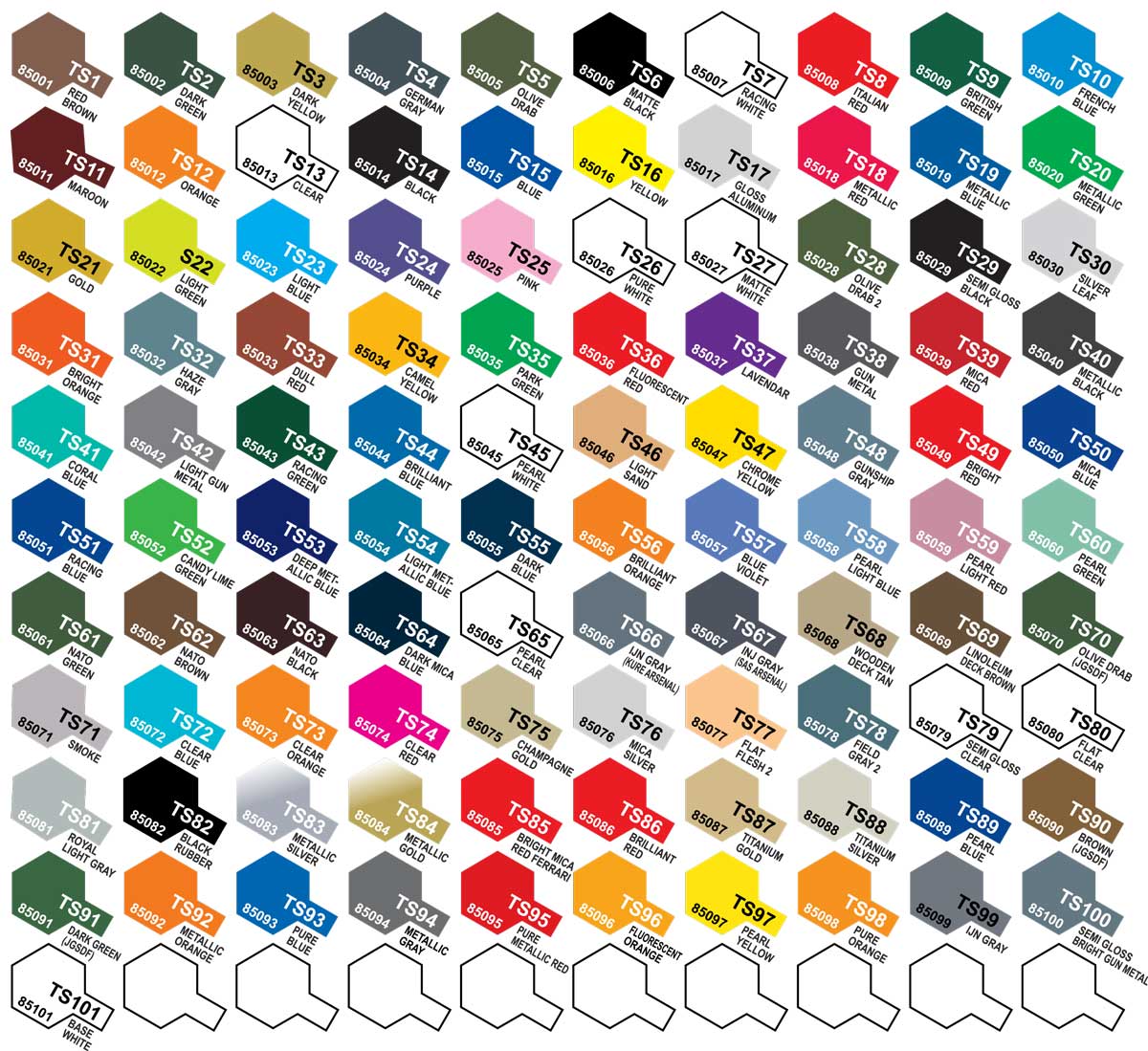

Regarding Tamiya Rattle Can Spray Paint Colors:
Color charts found on line:
Armor (Tanks) - “TS” prefix:
Aircraft - “AS” prefix:

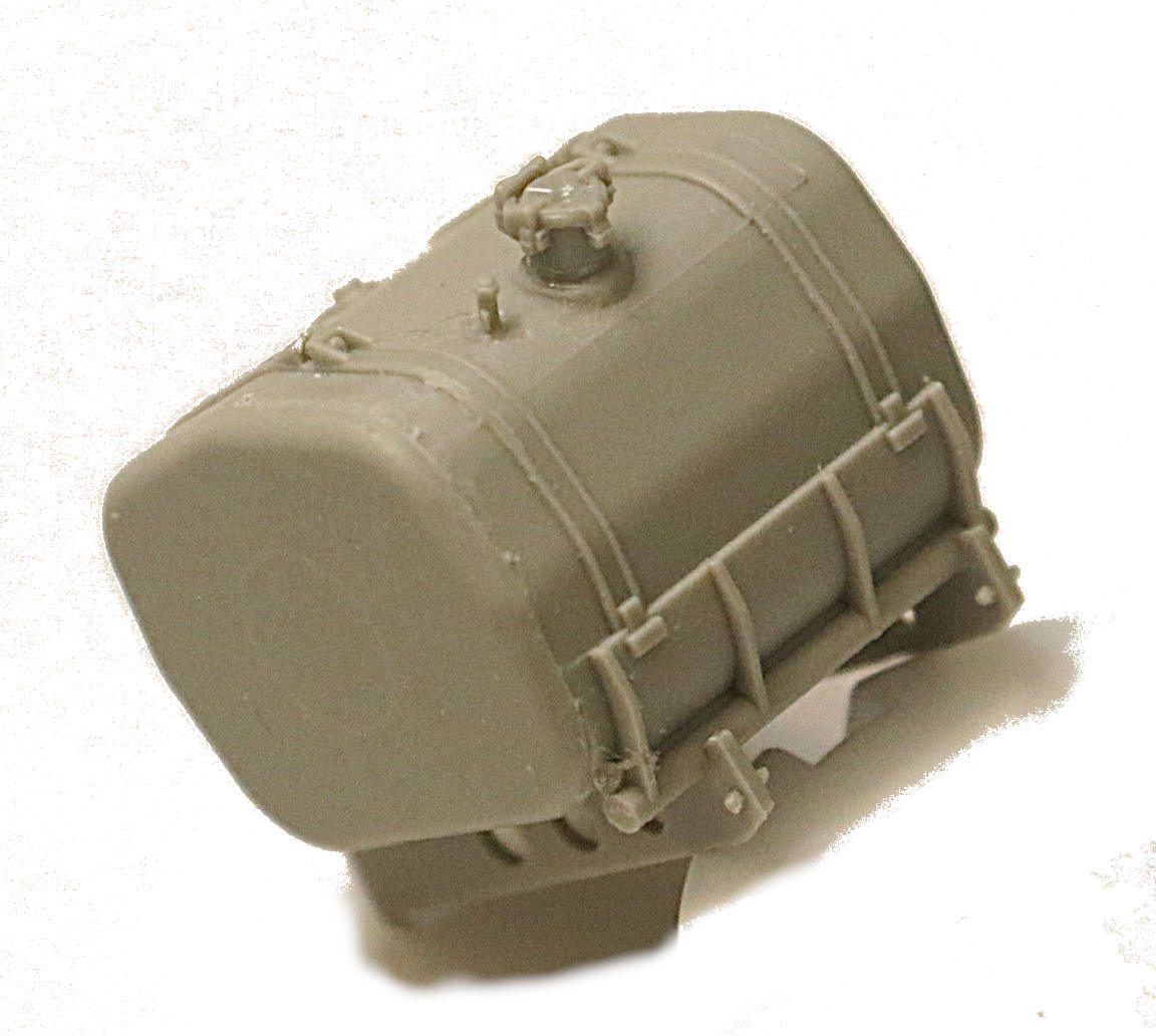

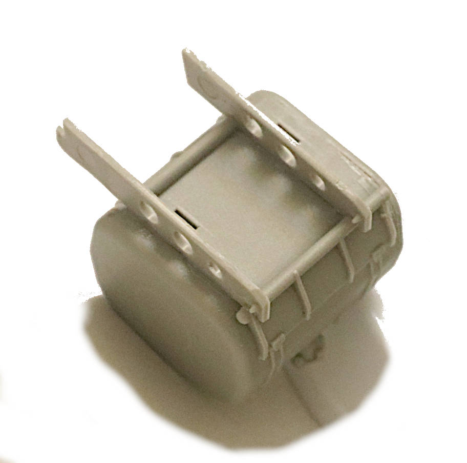

Those Big Gas Tanks:
Warning: Even these two items are left and right handed so use caution during assembly. Trumpeter even goes so far as to separate the left and right sets of gas tank assembly images into separate steps located on entirely different pages of the manual.
