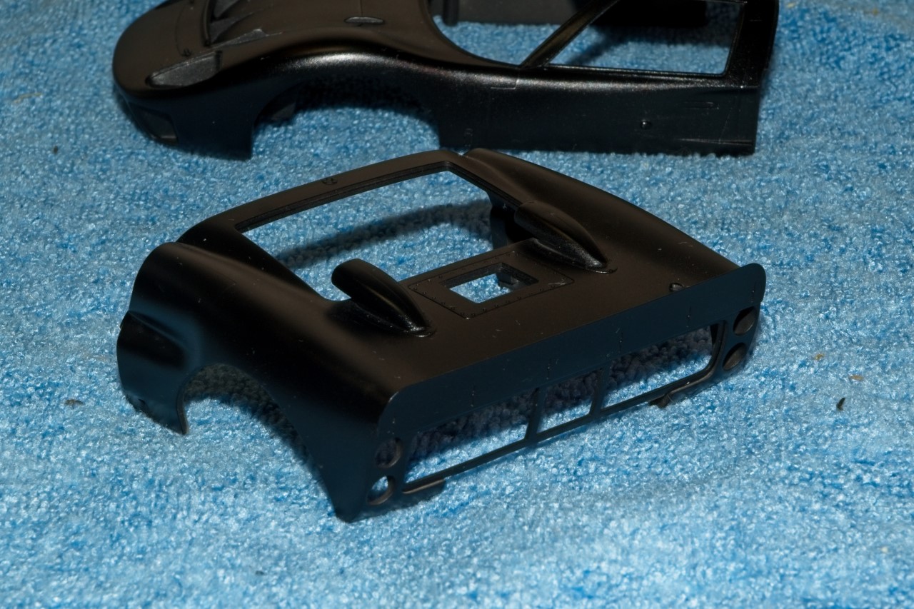

For me every car kit starts with the body right through priming, painting, decaling, and clear gloss.
Cockpit front clip, engine clip, and the chassis tub ready for priming. Wash in Iso Alcohol then wet sanded 3000, 4000, 6000, 8000, & 12000
primed with Mr. color’s Mr Surfacer Black 1500
24 hours later the primer is lightly wet sanded with 6000, 8000 & 12000, then air brushed with Gravity lacquer Anthracite Black
The next day I I once again very lightly wet sanded each body shell with 8000 & 12000
I’m ready for decaling but my Indy Cal details haven’t arrived as yet. I ordered them on 5/23 but just missed Michael’s cut off date as he was heading to Indy and all orders up to the 24th would be shipped on 6/2. So I’m kind at a stand still till I get them. In the mean time I’ll start working on the excellently detailed interior tub.

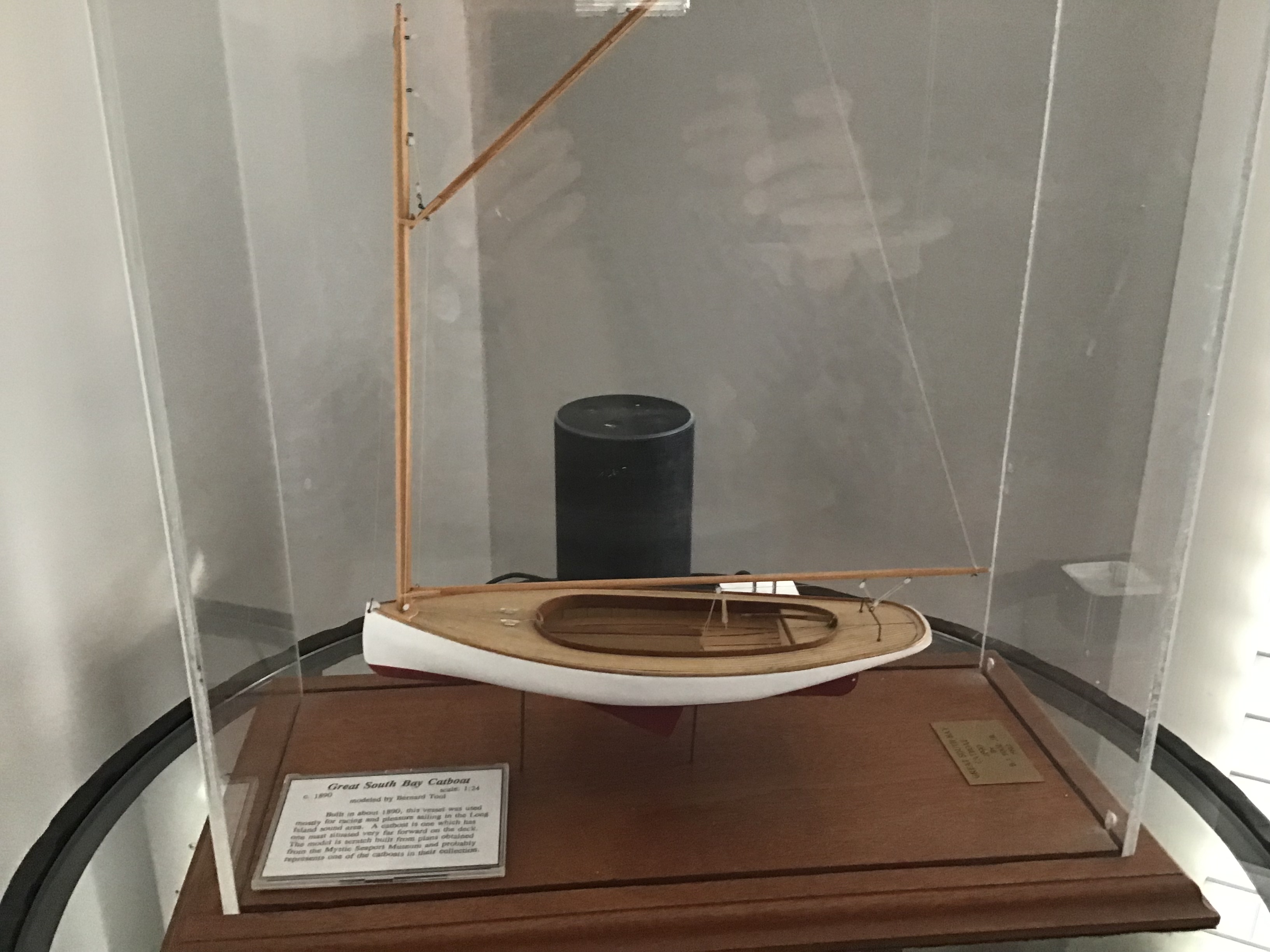

Here are two models that are very important to me built by the man who got me started in model building - my dad.
Like my grandfather , my father was a consummate craftsman - wooden boatbuilder . As a teenager he worked for Mathis Yacht in Camden NJ , later to become Trumpy Yachts when his Foreman John Trumpy bought the company. Trumpy was one of the pinnacle builders of the era . IIRC the US Presidential yacht Sequoyah was a Mathis . At a very young age my dad was given an apprentice and the responsibility of building the small launches and tenders that accompanied the larger vessels. For the war effort he went to work at Philadelphia Naval shipyard working both as boatbuilder in the small boat shop and a loftsman in the Mould Loft .In later years he designed , built and raced both sailboats and power boats . His first Jersey Speed Skiff was National Champion.
I only say all this to set the background for his capabilities and ultimately what they became .
Here is one of his scratch builds - Long Island Sound type catboat . An exquisite delicate model …
… and the last model he built - living in our care with extreme dementia and macular degeneration…
I like to think he enjoyed the last one as much as he did all the others.
I hope you can find some encouragement in my rambling.
I’m rooting for you.
Richard
