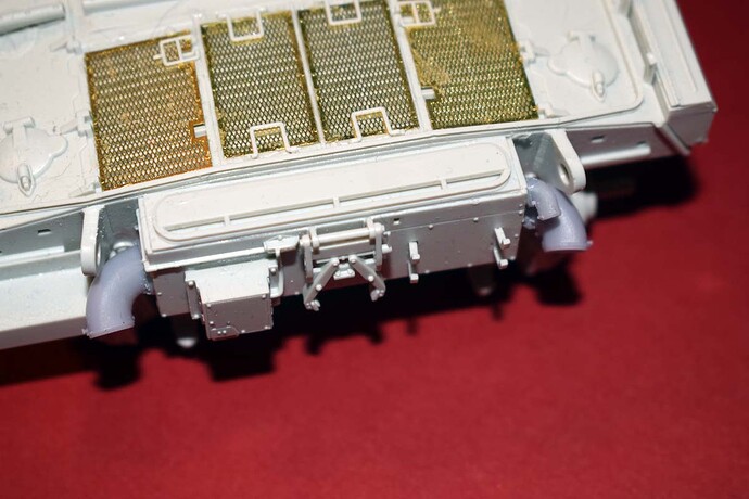

A parcel arrived from FC Model Trend that enabled me to progress with the filter box on the rear of the hull. I have added 3D printed exhausts a review of which can be found at the link below:
I feel they improve on the kit parts and are easier to use and offer some small details missing on the kit parts.
I used these on my Mk10 Accurate Armour one, as the AA ones were woefully underscale. The FC ones do look nice but I personally think they are slightly over scale. They almost hold the correct position, but not quite, and they are not easy to modify as you would probably end up losing the flange. When I say over scale, it is a tricky one as it’s either the exhaust elbows are slightly to big, or the kit scale and shape of certain things is slightly out. The AA Mk10 is I think suffering from both those issues.
Would be good to see the Meng and Takom exhaust elbows.
One of the big differences (that is very small) is the way Meng did the attachment rail for the wading skirt on the front hull. They are the only one to show it correctly
Johnny: These are a tight fit, but then the fit on the real vehicle is not exactly ease of access. As such I believe them to be correct or damn close.
They look good to me, as with everything armour there are going to be differences from vehicle to vehicle and as these are cast items in real life there will certainly be issues. How many times Johnny have you gone to fit a brand new part only for it to need some fettling for it to fit?
Yeah I have had to do a fair bit of fettling or redrilling to get something’s to fit. It might me my eyes or the picture angle but the LH elbow still just looks like it’s overlapping the LH mudguard to much. Might look better with the rear bin on …
I will test fit the bins later and let you know.
The fit is as tight as a gnats knacker but then scale wise that is about right.

Regarding tolerances of the exhaust system and the rear boxes I provide the image below.

It’s building up nicely from the images above, however I am seriously not a fan of those 3d bits of resin … From the images they just look flat with no detail ? Can you see or are there deck louvres on the resin ? If there are no details for the deck louvres then they are unrealistic and I can’t see the point of them. The ones with the PE deck screens are 100% and they should be.
perhaps this is better
Thanks for showing that image Darren.
Honestly, from knowing those hideous decks intimately lol… I still think they are unrealistic if you can’t see the louvres under the mesh grill …
I will go back to the original pic when you showed them side by side. I think the ones with the PE screens look totally the part without question. Your call though matey.
My main reason for liking them is the ease of use but I do understand your point.
The Chieftain chief has spoken… :grinning:
Lol … I would not go that far…
