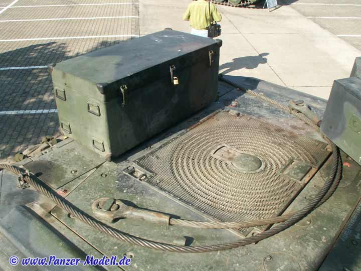

There’s one tiny bit of improvement you could still add: The eyes of the tow ropes on the engine deck are secured to their stowage points by a rotating oblong steel plate, as can be seen here:
This is a common feature on all members of the Leopard family and easily added.

Thank you for the point. The Meng manual was not 100% clear about the towing cable placement but due to lack of reference photos I simply tried to follow Meng’s drawing somehow.
I am afraid that the cable is already glued onto the engine deck, so it might be impossible but will try to correct it.

You don’t have to move the ropes from their correct (!) positions - all you need do is cut pieces of plastic sheet in the shape of the stud that fills the towing eye (= round the ends of appropriate strip styrene) and cement them across what you have there. Here’s how I did it on my Italeri Leo1A4:
Peter
Hi Peter,
Thank you for the clarification, this is easy to fix as I see. Will deal with it.
