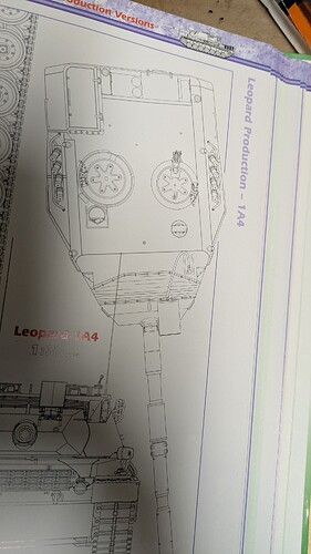

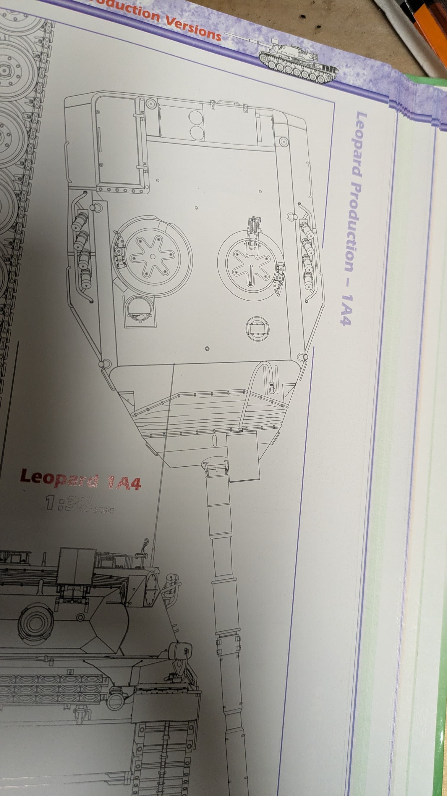

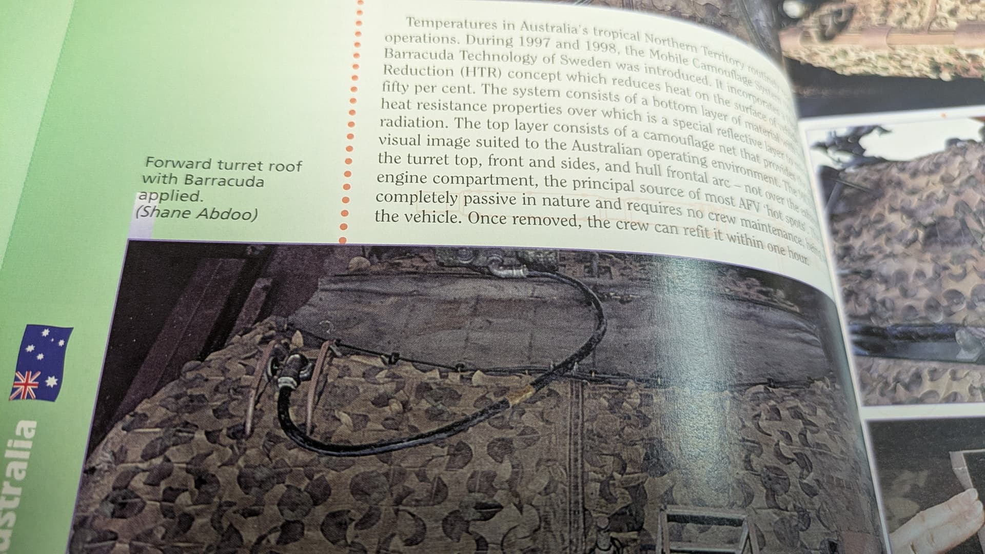

It’s not too late to add those cables! Each one plugs into the turret roof behind the respective device, into sockets that have those bars either side to protect them. The cable has a metal “elbow” into the socket. The searchlight has a similar elbow into the back of the box, and I forget how the PZB cable enters it. There’s plenty pics out there on the web! I’d use suitable brass wire, and just paint the ends silver-grey to represent the elbows…

I think the cable is a bit longer than you seemingly describe Tom; I think it sort of loops around those stanchions before connecting to the socket. I always use solder for the cable on mine. lead wire - if chunky enough - would also work.

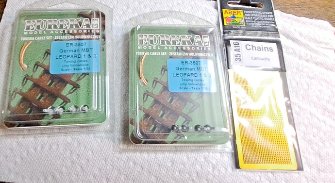

Identify a really decent tow-rope

Add chains to smoke discharger caps

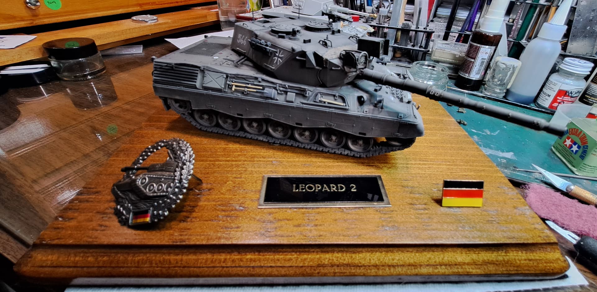

If I incorporated the beret into a display base for a Leopard 1 or 2, should the beret be to the left of the name plate? To left in general? Here’s a mock up minus ground work of what I had in mind.
Obviously, I have to get a Leopard 1A3 name plate.
Thank you.

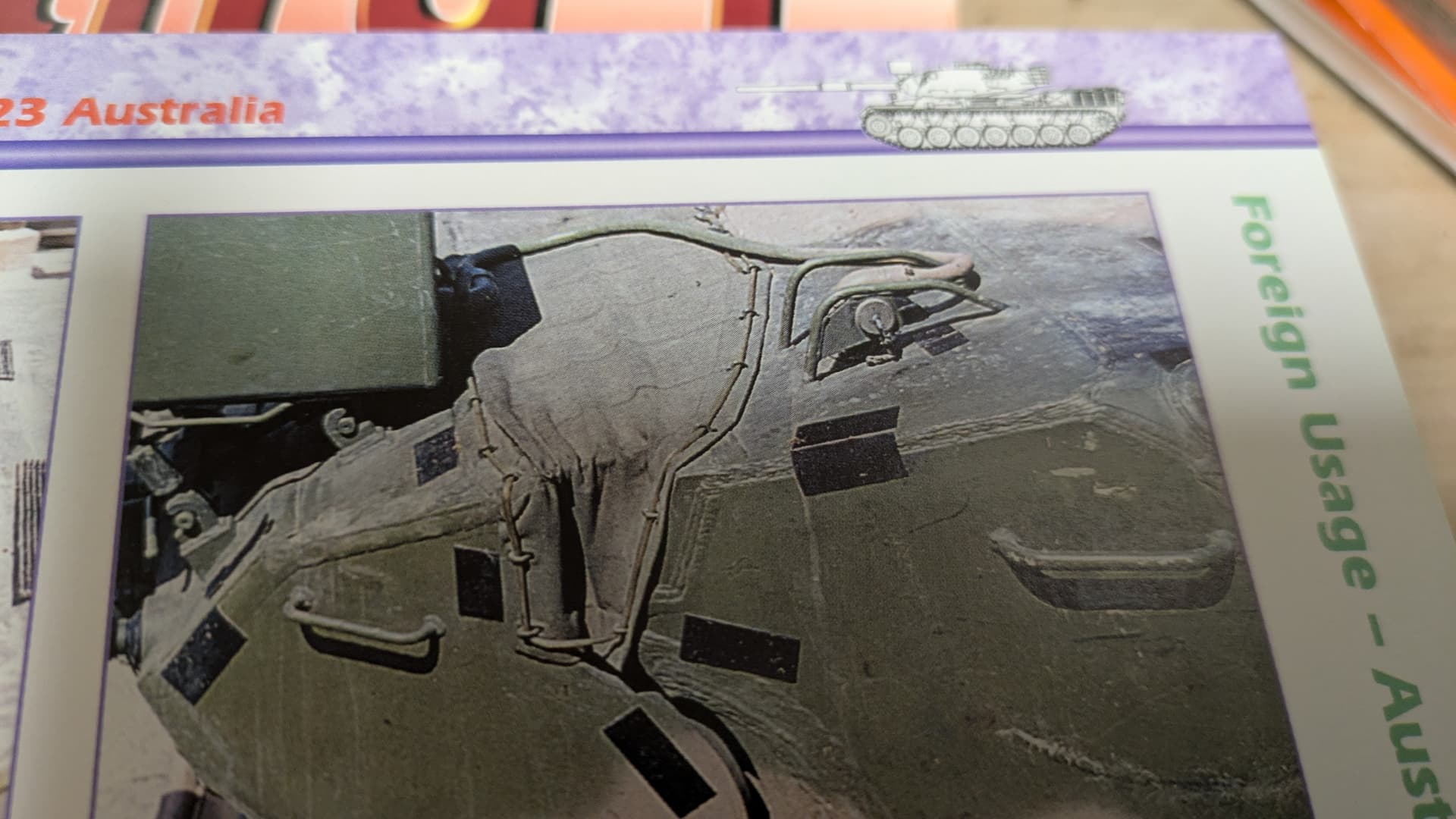

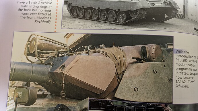

I’d started to add the cover & chain for mantlet but couldn’t find a picture of where to anchor the chain.

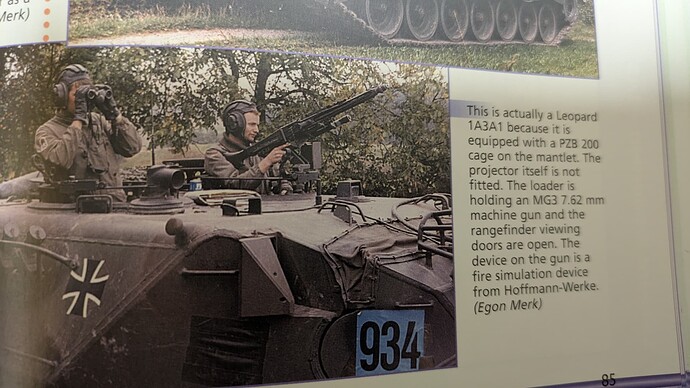

Likewise, there’s an antenna like thing in the Meng kit I couldn’t identify. It’s apparently the power port for the PzB 200 & infrared search light etc.
Likewise, that fantastic engine deck picture makes my day.

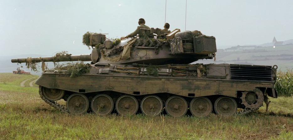

@Barney Steve, that Leo looks like an A5. There’s a Revell-a-gram in the stash and a Meng if memory serves.
Ready for the next Leo…
The picture was taken in 1977. At that time we had the 1A2. We didn’t start the 1A5 upgrade until 1996.
Hi Steve, Wasn’t the 1a2s on loan for trials / training till The improved A3s were issued, in 78-80, then a5 turrets, swapped later in 96 as it was a cheeper upgrade
I think the left of the name plate and since the beret already has the German flag, I would save the pin flag for another base. Wouldn’t be efficient to have two German flags on the base. That would be very anti German.
Frank, yes you are right on the initial loan from Germany. I was not a tanker so my data is from Canadian info sites.
We still used the 1A5 alongside 2A4/6 in Afghanistan. The troops liked gthe 1A5 for the ability to fire HESH rounds through thick mud walls, etc. This info I can 100% verify. I did 5 tours in Afghanistan, my unit was responsible for bringing Leo’s into theatre. Plus a family member was a tanker and my son was an infanteer over there.
Wade, personally I would keep the cap badge left, plaque centre, unit right (if applicable).
This would be how most military presentations would be done.
@Tank_1812 Ryan, that’s an excellent observation. I think you’re on to something

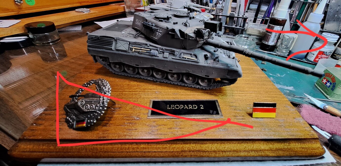

Removing the flag pin may allow tweaking the beret and name plate plasement to suggest an arrow to the right in the direction the tank faces.

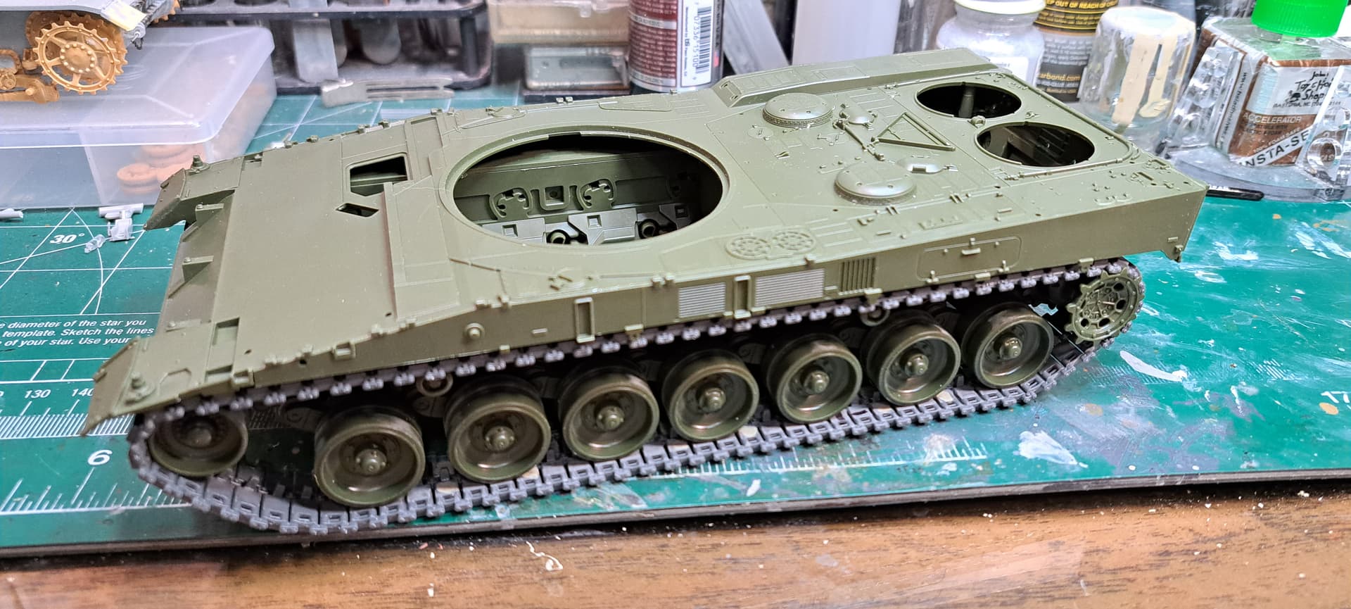

Sidenote due to circumstances my road trip was delayed and I had too much spare time yesterday…idle time & the Devil’s Workshop…
Interest in a stock near stock build thread on Tamiya’s new trick Leopard and Kaizen?
I think the new kit is pretty amazing and definitely “not your father’s Oldsmobile” so to speak.
