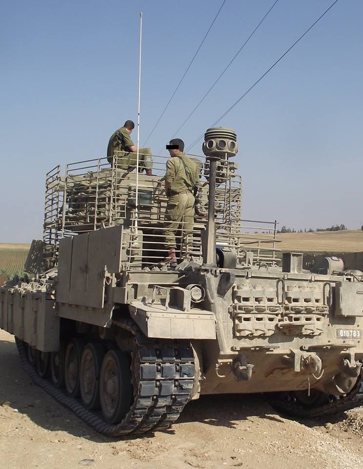

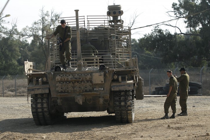

Beware that Tiger Model Nagmachon late has a couple of major mistakes. The most obvious is the double smoke dischargers per side. There was only one.
The tracks in the kit are correct for the decoration option as stated previously. If you intend to go for the standard Centurion tracks don’t use the decals. Don’t forget to shorten the ends of every 6th link.
