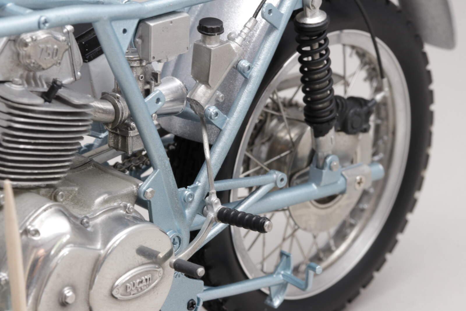

Moving on but not without mishap.
Got the rear fender and seat hump in plus the shocks. I had laced up the wheels some months ago but not fitted the tyres because I didn’t want them to attract any dust. So fitting the rear today I drop the hub on the floor and sprung some of the spokes. After much gee whizzing, I re-attached the spokes.
I had also made the chain last year when I did the wheels, MFH said 102 links would do it but it is much too loose so probably 100 or 99. I will take the wheel off and finesse the chain.
cheers
Michael

Not much time for progress on the Duke and what time I had was taken up with the rear wheel. After dropping it and reattaching the spokes once I got it on the bike it was clear the hub was no longer straight so a complete strip down, all 85 parts, cleaned up the old glue, redrill the holes to clean them up and reassembled. Still took a bit of finessing but got there.
Did get the rear brake on, surprisingly its on the left, gearchange on the right. I have been riding bikes since the 70’s and I have never had that. Our classic bike specialist Richard may know whether that was common on older bikes or just an Italian thing.
Centre stand installed but not yet effective.
cheers
Michael

Michael,
Outstanding job on stripping, repairing, and rebuilding the damaged rear wheel.
Joel
