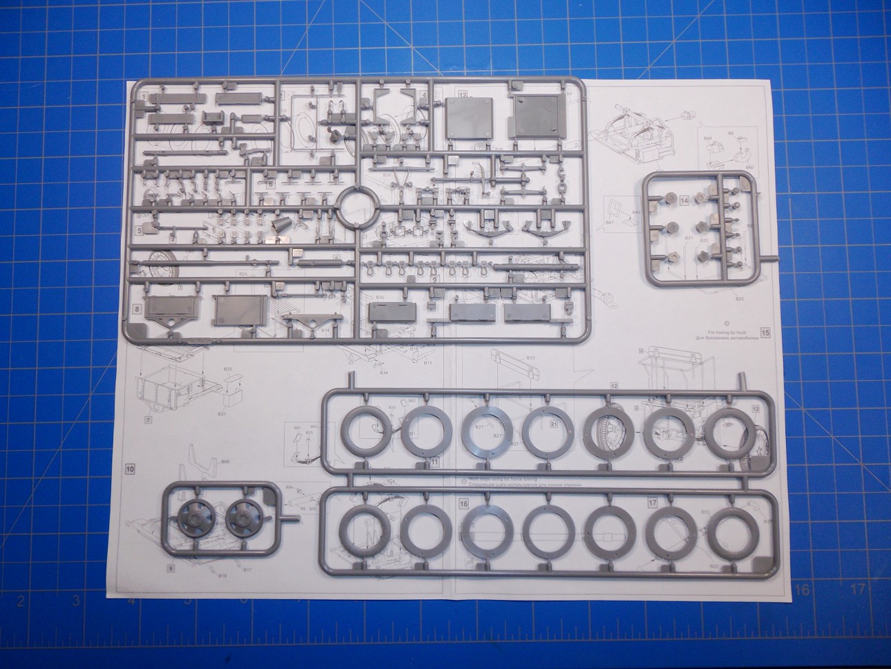

Sprues:

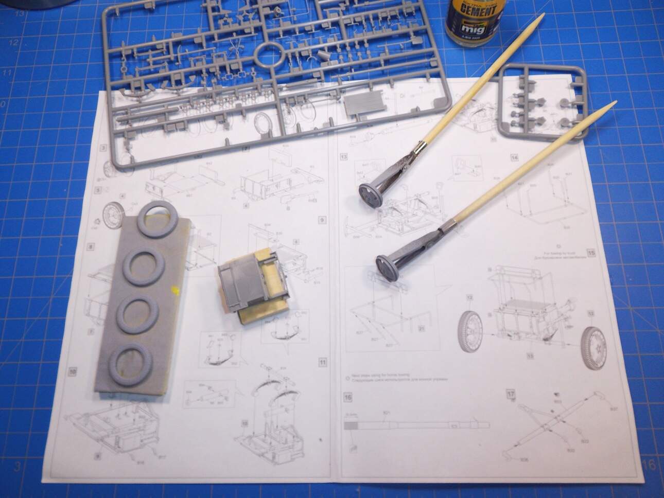

Work on the tires, rims, and “box.” Tires/rims primed (I really like how they do their wheels - separate so they can be painted apart).

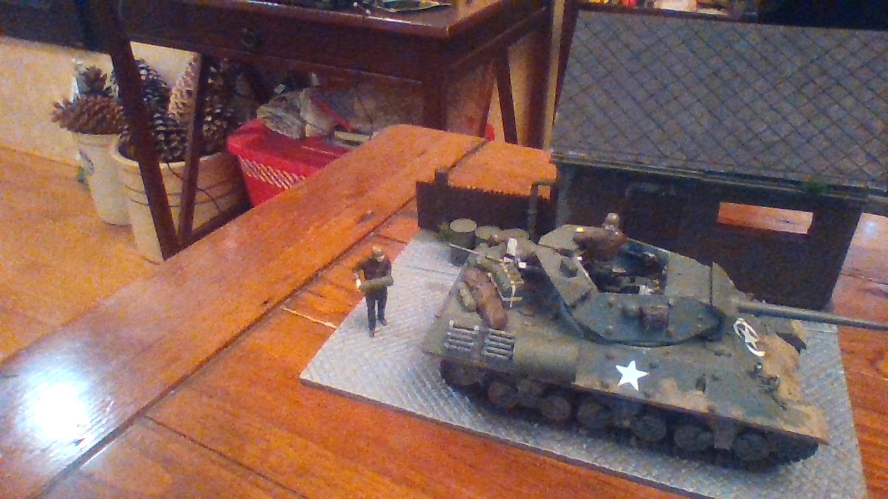

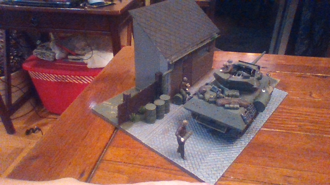

so, I have finished the dio base and painted it a little. there’s a couple of oil drums and one has been turned over to act as a seat. i personally think it is going great!

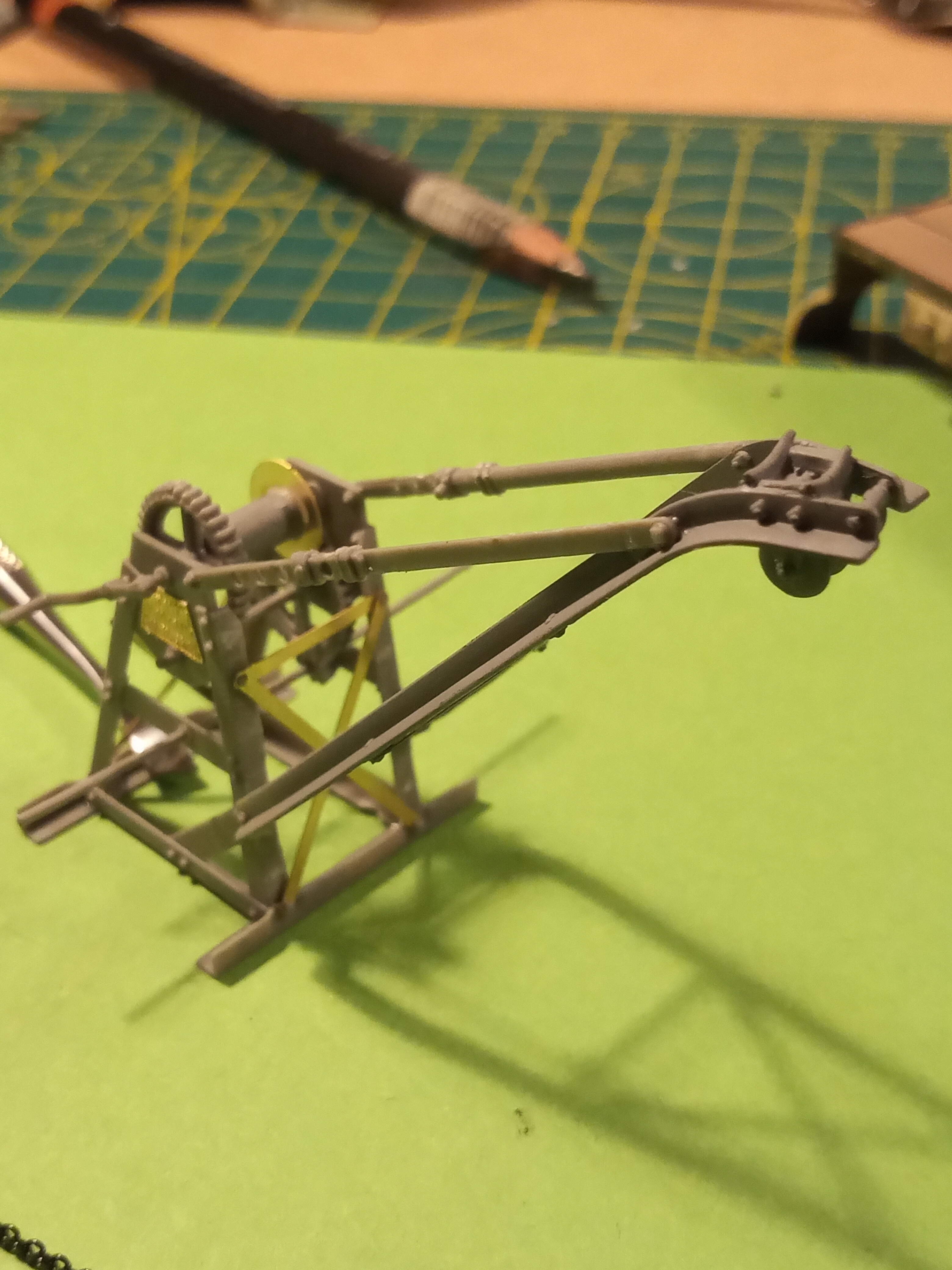

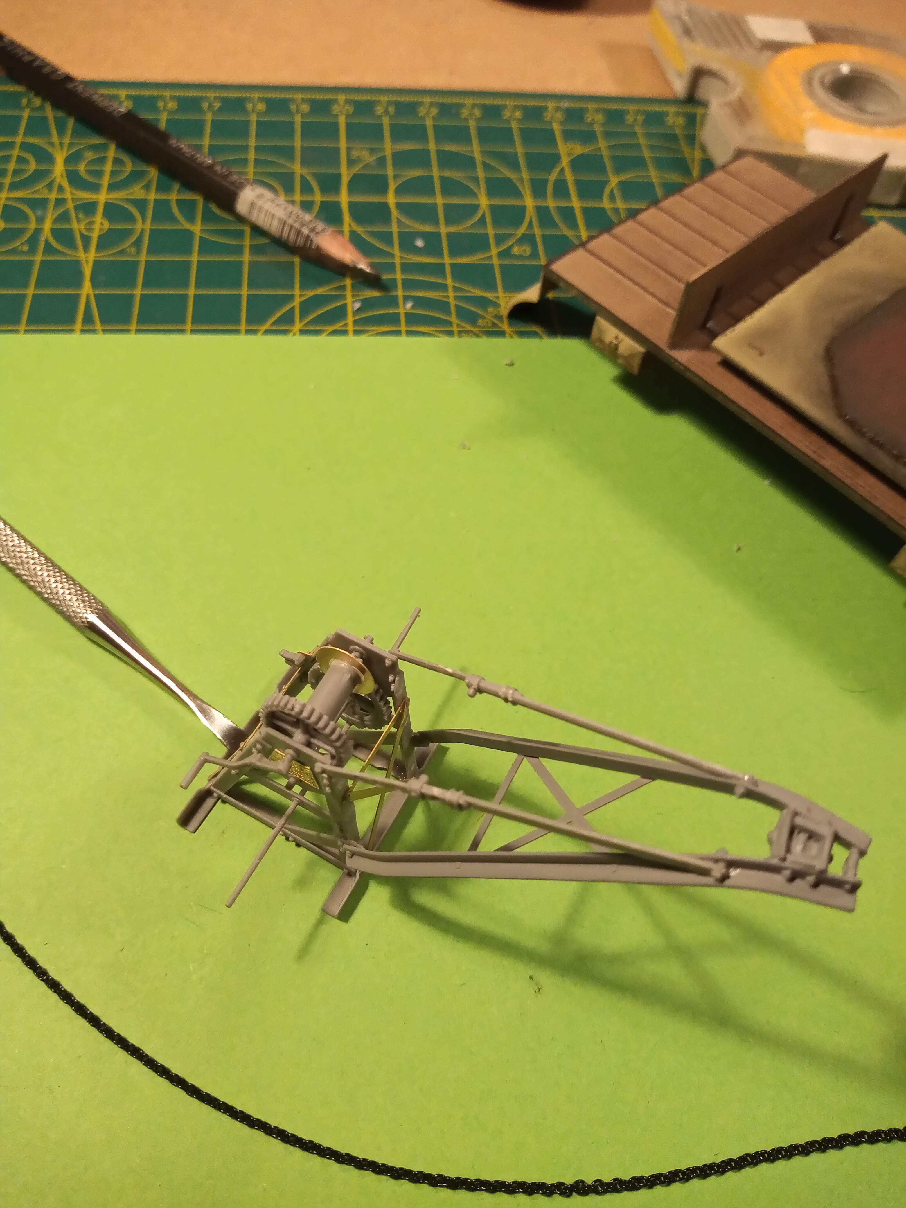

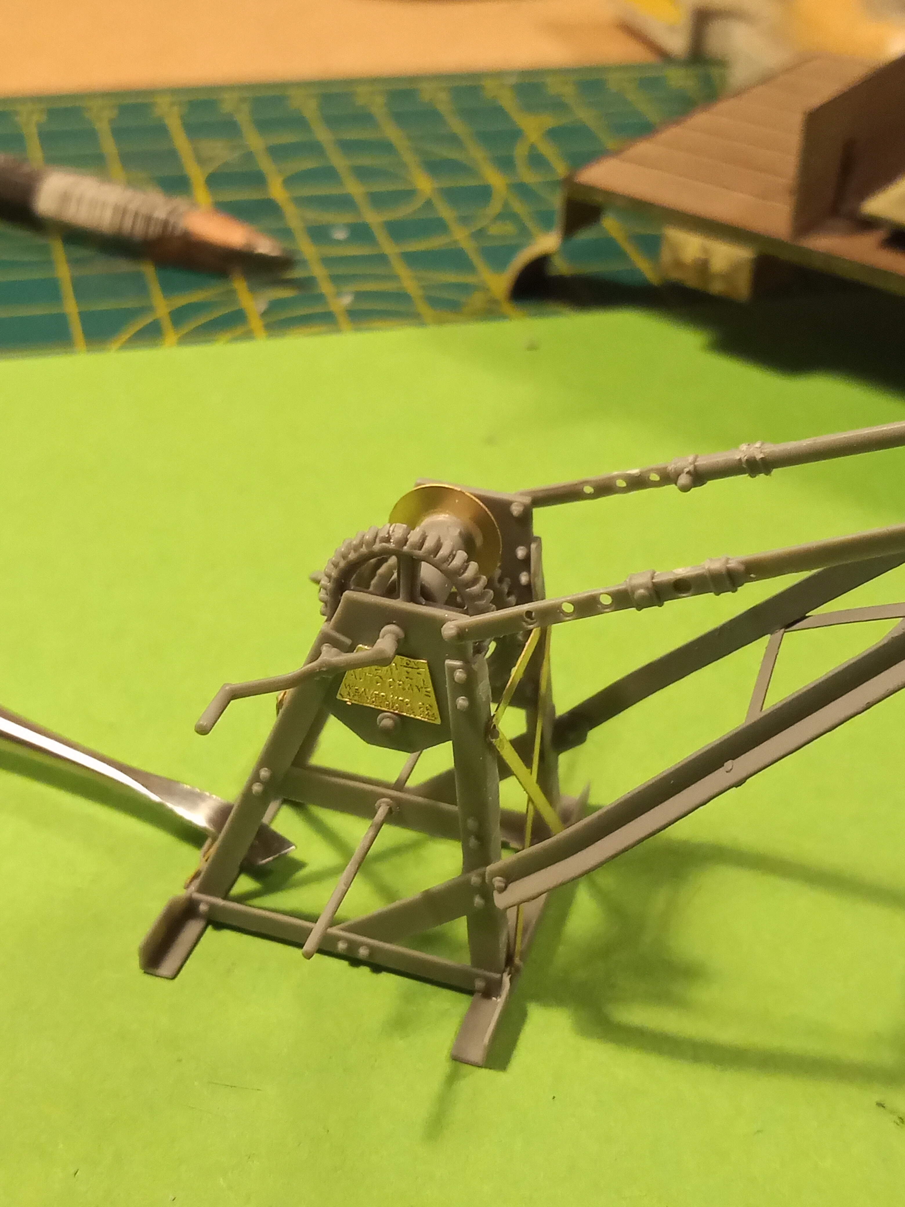

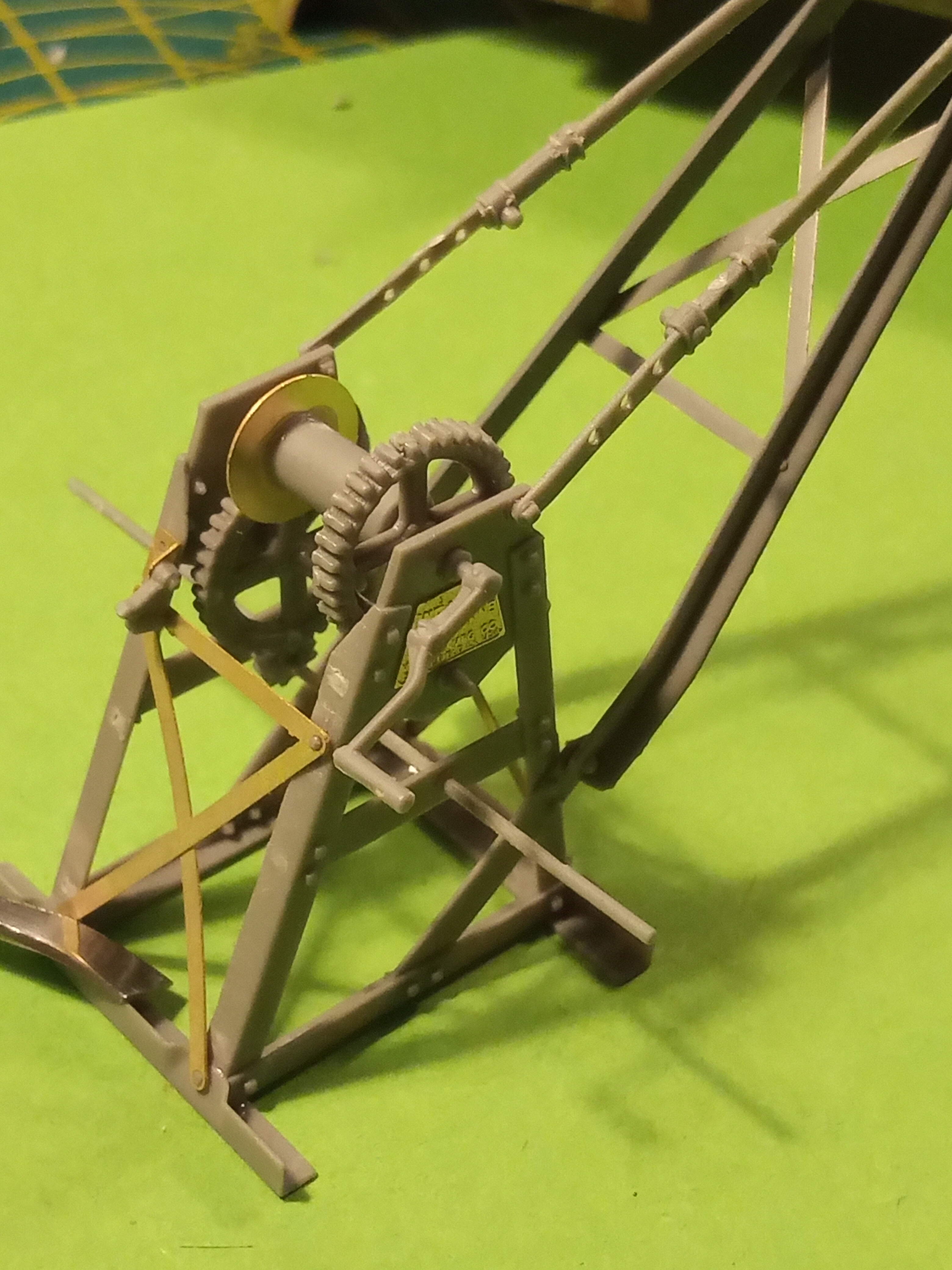

A little bit of progress on the crane and turntable.
The crane is now assembled apart from the chain and the main hook.

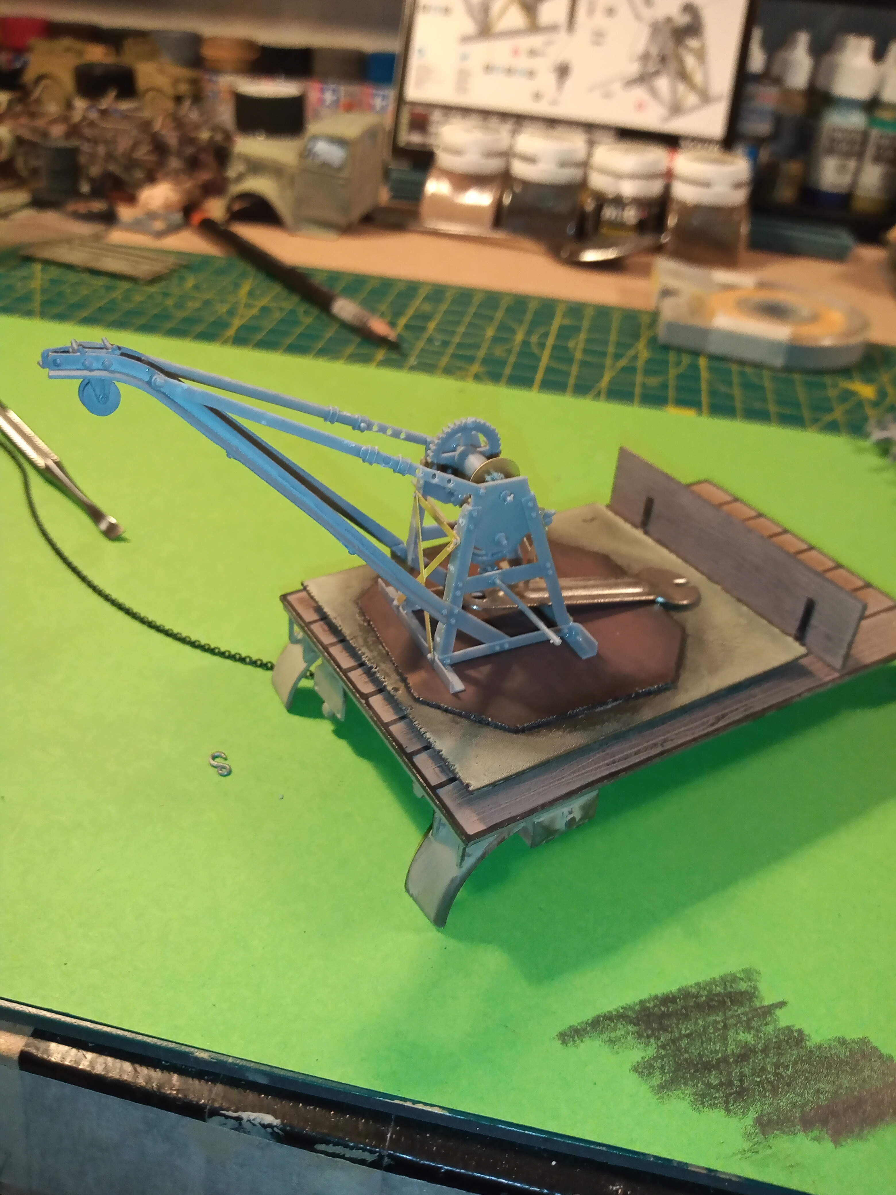

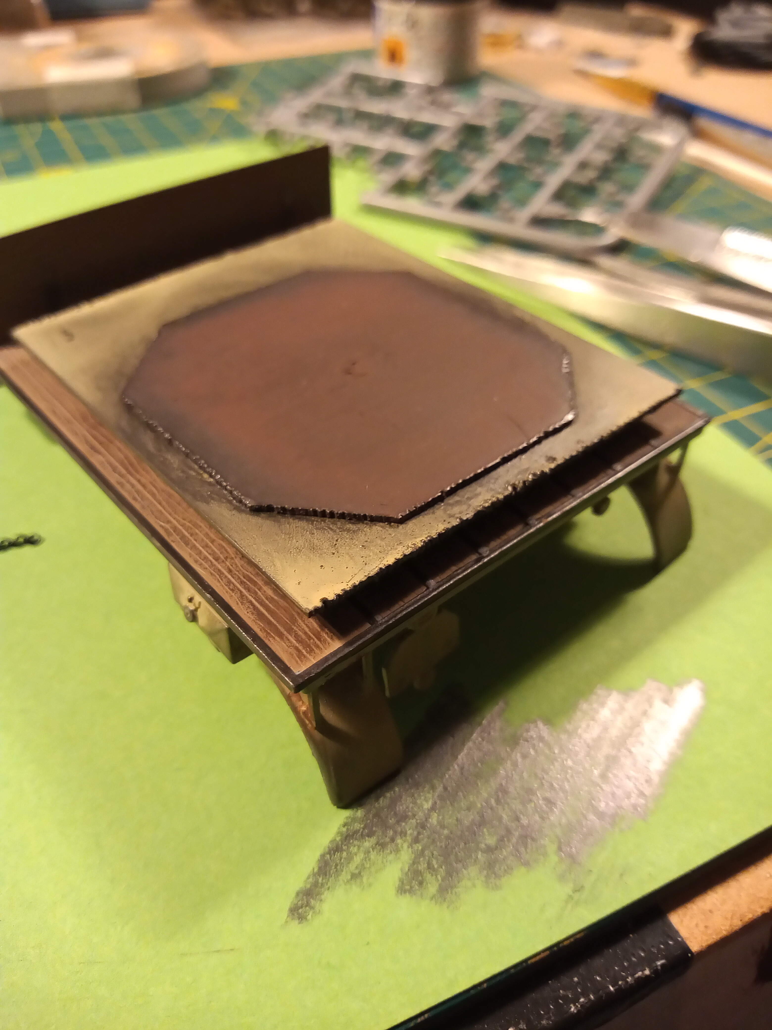

Roughed up the turntable… And painted the rotatable base with a mix of hull red and dark iron. Then worked in some H7 graphite to imitate where it turns on the base.

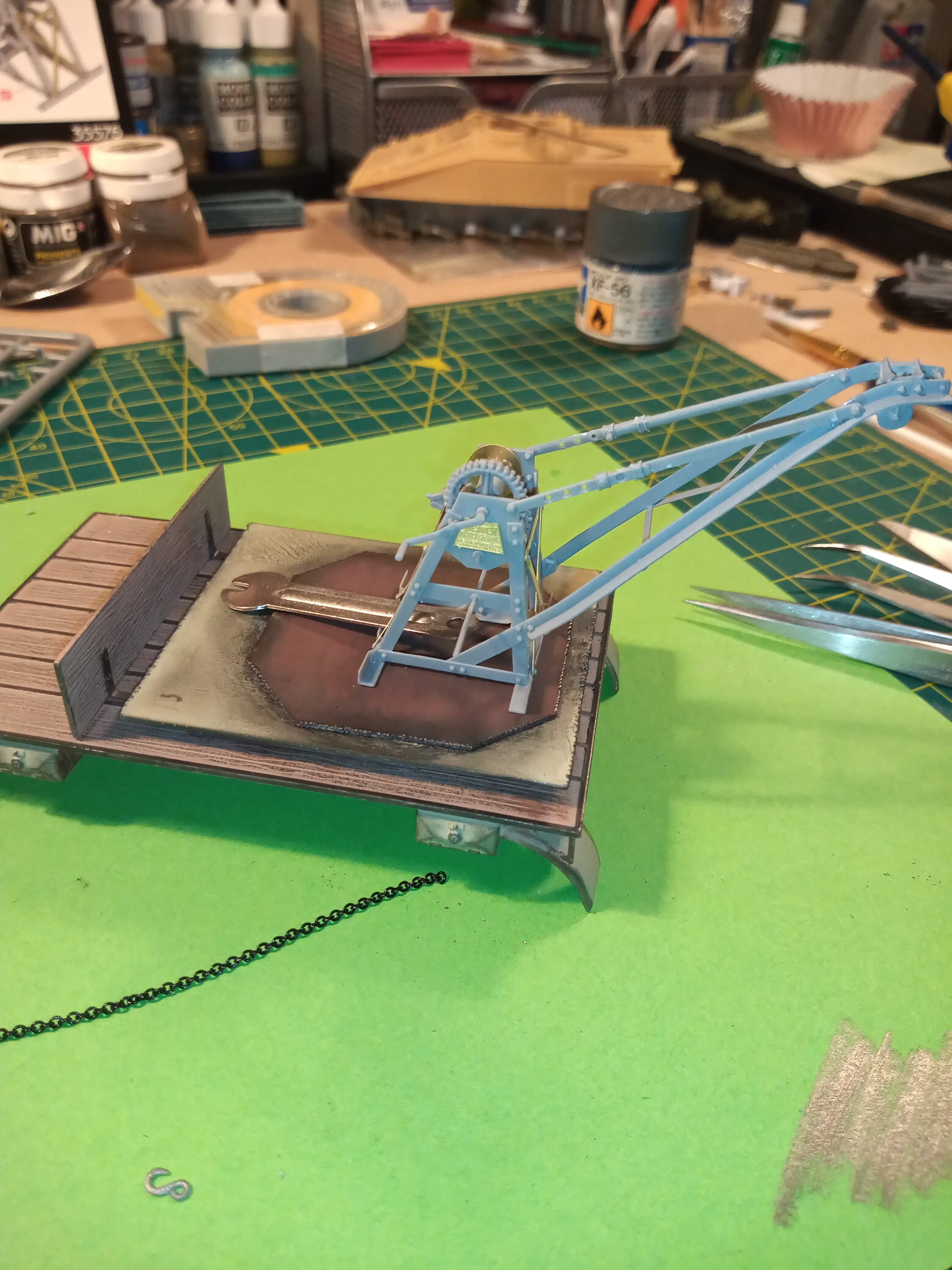

Then with the crane dry fitted for effect.

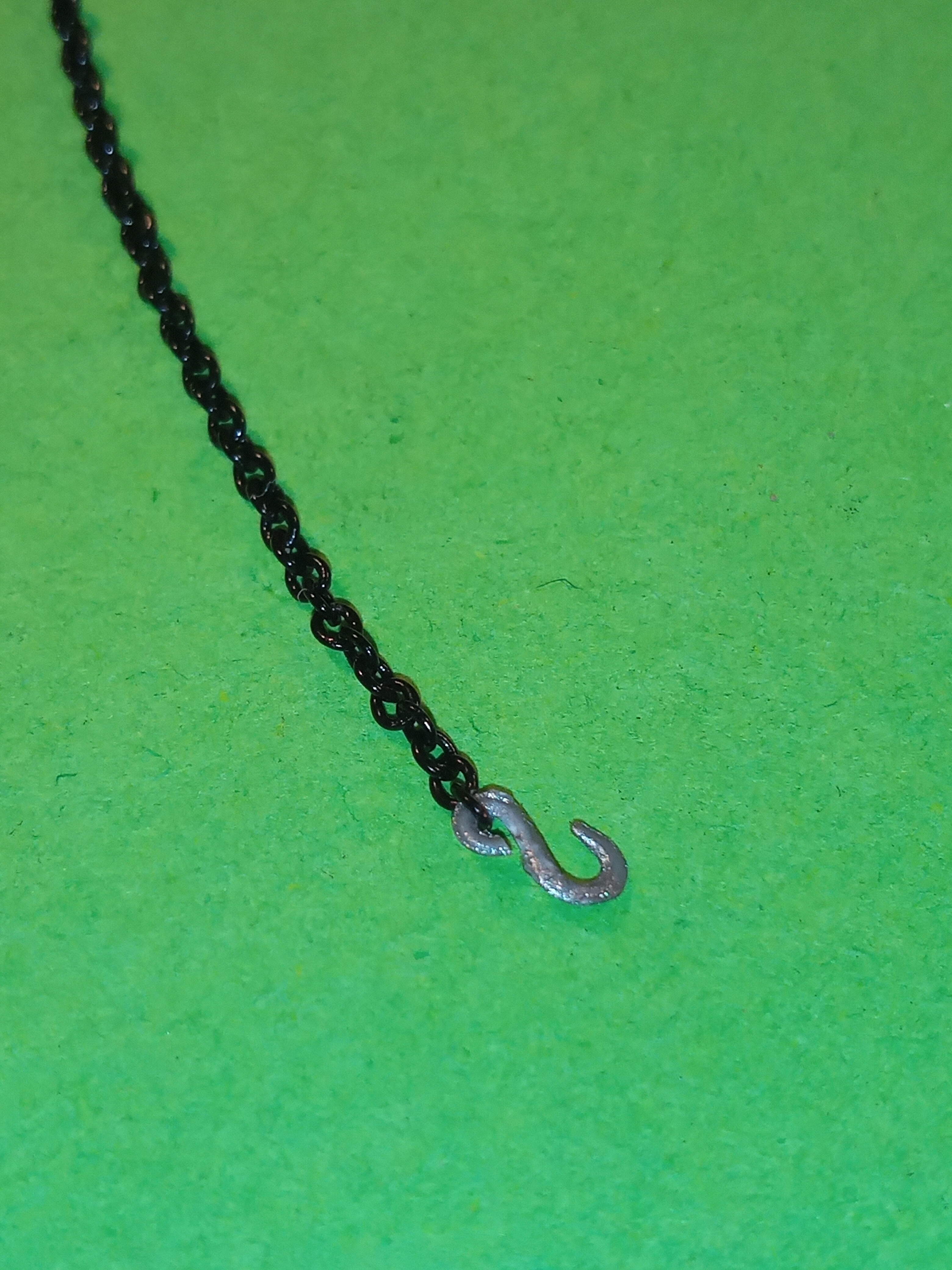

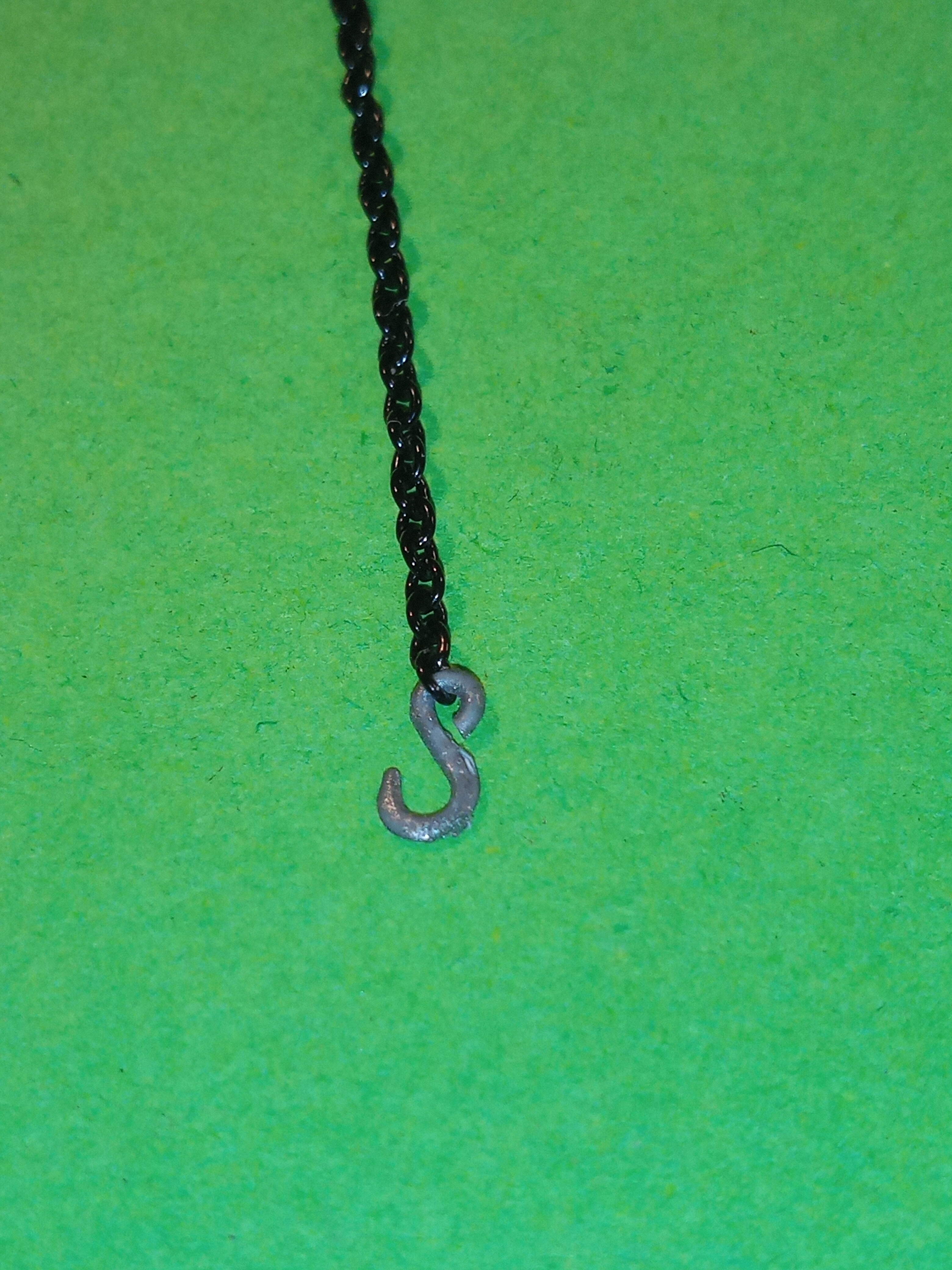

Last couple show the anchor hook attached to the chain. A simple cut into the hook and slid the chain into it. Will secure the cut with a small bit of super glue.
I quite like the finish on the chain as it is so may just a very small brushing of light rust at the end to give it an older used look.
Looks good. Cannot wait to start mine soon, have to finish the Ho-I by Monday so that is my only focus. I did a mix of hull red and dark iron for the exhausts on my Ho-I and T-80 build and used dark iron on the tracks for both kits.
The crane is a really nice little kit Ryan… it would fit into alot of different Dio’s. I will try and do mine in a mix of hull red and either flat red or dark iron, depends which I like most.
Dark iron is my go to paint now for a base coat on tracks…
I agree on all accounts, the T-60 w/crane keeps calling me. The crane kit is very versatile. Dark Iron is my track goto also.

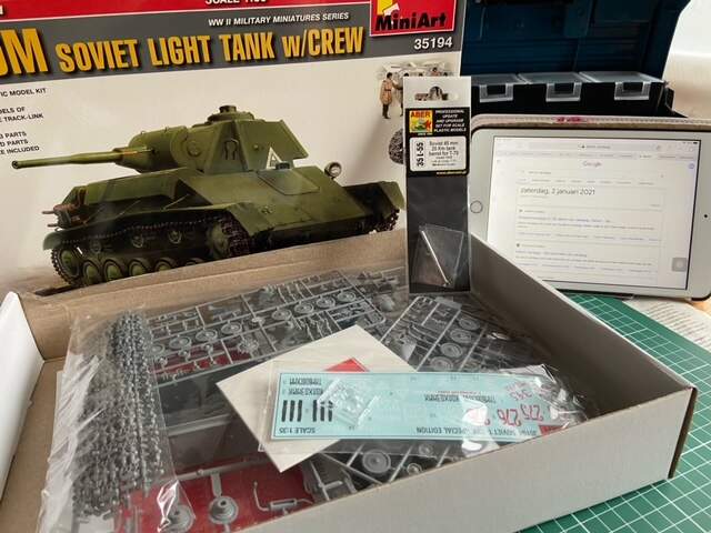

Didn’t post a proper picture of the starting point of the T-70 I will be building for this campaign. I got an Aber metal barrel for it as well and am starting the build today. The included figures will be used to practice my figure painting.
T-70_20210102
Good to see 2 more getting ready with James and Erwin, both look like great kits.
