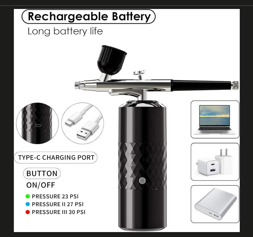

For what it’s worth, there are these: https://www.aliexpress.com/item/1005008805174537.html?spm=a2g0o.cart.0.0.763438daMeyQ6r&mp=1&pdp_npi=5%40dis!CAD!CAD%2020.87!CAD%2019.99!!CAD%2019.99!!!%402103244b17557331235813128ebe4d!12000046738285084!ct!CA!2553906158!!1!0
:smiley: :canada:
$8! How long does it work? That’s a little too bargain basement for me.
I got the $30 version sold on Amazon and it works great. Is now down to $19.90. Shoots for over an hour on one charge. .35mm needle is good for all uses. Great for travel or outdoor spraying. I have no idea how long it will last though. I suspect one day I will pick it up and it won’t hold a charge, or will shoot funky. But it wasn’t a big investment in the first place.
Can you select the pressure, or is it all one pressure?
P.S. It seems that there are: 23 psi, 27 psi and 30 psi
It’s one pressure, I’m pretty sure it’s 30 PSI.
One of the product images suggests 3 different levels.
On the version I have, because you attach with a hose you can use whenever airbrush you want. So a MAC valve could come in handle. You could also attach a gauge if needed. Easier to play with the distance to model than pressure. I might not be refined enough to appreciate the air pressure differences from my experiences.
I personally don’t like the airbrush that close to the compressor as it adds additional weight and bulkiness when spraying at different angles. Also if you like/used to a trigger style that setup doesn’t allow you to do that. If that setup works for you, that is great.
