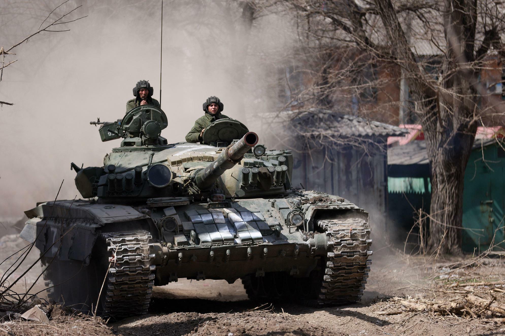

A few T-72s have been seen without ERA
Others with minimal ERA

All look to be T-72B except for that last one, the AH kit is the export version of the T-72A.

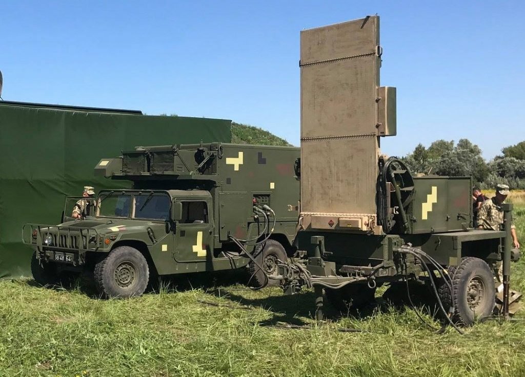

US-supplied AN/TPQ-36 Firefinder radar
