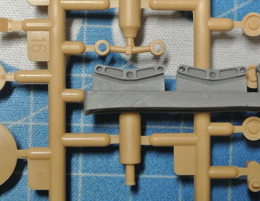

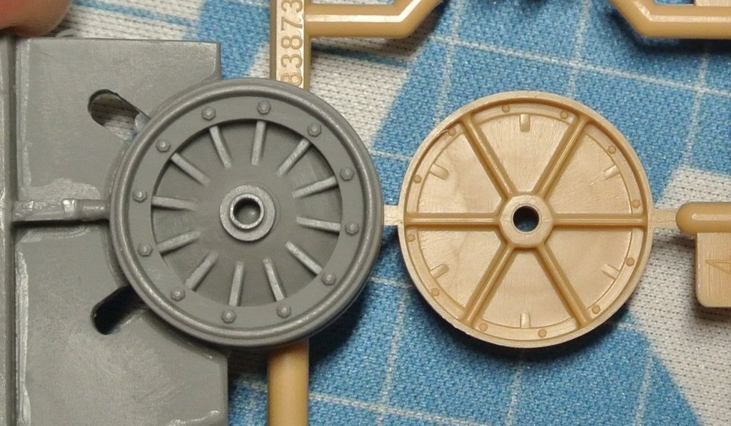

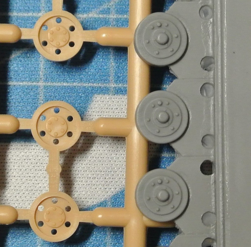

All chassis is wrong.You can see it in comparison chassis from the kit and resin one from SPM.
