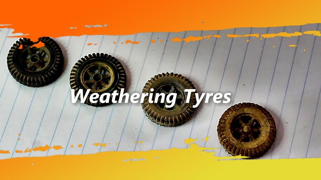

My messed up tyre painting
could anyone give me a idea of what colour to weather mud on tyres
heres what happened to mine
The color of mud all depends upon local conditions. Grays, browns, yellows, reds… soil composition in one area might not match an area a few hundred meters away.
Depends on the type of tyres too. Vinyl tyres will not take paint of any kind very well and nor will they take acrylic, enamel or oil based weathering products. Best bet with vinyl is to use pigments of earthy colors. Resin and plastic tyres will take paint and weathering products with no bother. My advice is to use not just one earthy shade or product but at least two for variation. You’d also need to identify the type of mud you want- is it very wet, a bit damp, dry, dusty etc.

hi folks thanks for your help and ideas nice one
Keep as is.
Use some flat black oil paint and mix with enamel black and dry brush the side and tread of the tyre.
If you dont have oil paint black or grey enamel will be fine.
Its just that the oil paint seems to make the wording on the tyre stand out.
Brush the paint onto some paper towel until there is a small mount on the bristles of the brush tip and highlight the sides and tread.

hi folks thanks again for your help maybe i should leave the painting at the moment as ive 2 cataracts and can hardly see waiting for a operation but waiting list is long thanks for your patience and time
