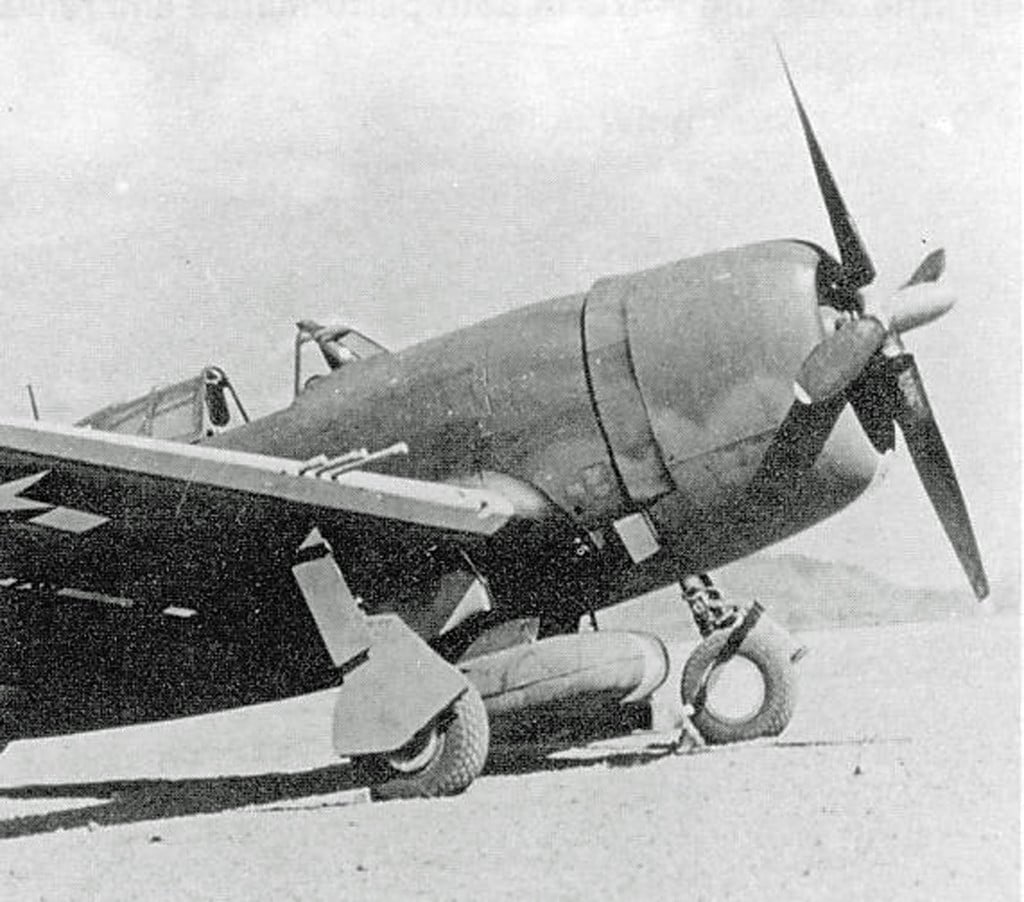

This photo of a P-47D of 1º Grupo de Aviação de Caça in Italy in1944 shows what looks like an unusual centerline tank. It looks like a smaller (narrower) version of the "flat " 200 (allegedly) gal.tank. ( As far as I’ve found the flat tanks were made in the UK and used only by 8th/9th AF… Did any find their way to the MTO? ) Or a wider version of the 75gal.one. Was this a locally made tank, like 5th AF’s “Brisbane” tanks? Or just an optical delusion?

So my research about fuel tanks led me to consider the same depiction you posted. My plane was from the 62nd FS/56TH FG based at Halesworth UK and I depicted it with the 200 gallon flat tank. My best guess (but I have no definitive proof) is that the Brazilian Air Force had their own fuel tanks for their P47s. Here in fact we see a different example from the one you posted that appears to mount the same tank.
Secondly I tend to believe that, given the difficulties of refueling on the battlefield, these aircrafts were equipped with a non-specific tank for the P47, adapted to the needs. In any case I don’t think it’s an optical illusion.

yellow bordered blue circle. Very colorful.) Also have and Iranian D-30 and a Mass. ANG 47N. In my snooping around ,it looks like the 200 (215) gal. flat tanks did not come in till Feb(?) of 45. As far as I can tell it was 8th/9th AFs only. “Brisbane” tanks were 5thAF only,and only for Cs and Early D Razorbacks. Later versions used “issue” tanks. As for the Jambocks, they did use locally fabricated 100(?) gal tanks that were 75gal.tanks ,split,and with a section added to the center. Some had the fill cap on the left (Like C-5,above) ,others ,cap was in the center. One thing I saw said it was a Brazil only thing but I did see a US marked (350th FG?) carrying one. There are a couple resin ones. https://www.model-monkey.com/product-page/1-48-drop-tank-100-gallon-for-p-47-thunderbolts-in-italy. Now to figure out the wherefores &whys of the strike camera on the left pylon. D-5,above has it. (K-25 strike camera was mounted in a fairing onthe left pylon. But not on all aircraft.)

As Orville said to Wilbur, “you’re Wright.” … I know what the flat tank looks like. That is why I said the "mystery " tank looks like a narrower version. The flat tank also looks like the “Brisbane” tank. (5th AF only, Made by Ford Australia up till mid 43. Flat tanks did not enter service till Feb. 45 in ETO only)

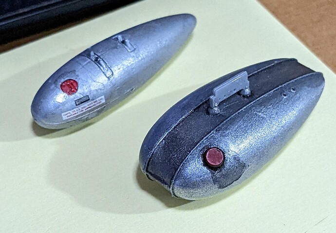

Well,found out Model Monkey makes the field mod. 100 gal. tank. (Shown with a 75gal. tank) Still befuddled as to if this was a Brazilian brainstorm, 350th FG or 12thAF.
(Rack on 100 gal is the Tamiya P-47 centerline. Model Monkey is mountless.)That’s what I was thinking. This was a field mod - would be nice to find some source just for interest/conformation. Maybe Model Monkeys has some story?
Most of the photos I’ve seen have been on 1º Grupo de Aviação de Caça birds … errrr Pássaros… they were attached to350th FG as the 4th Sqn. Seen a couple pics of 350th birds with them too. So,not sure if the 350th’s shops made them or 1.º GAvCa had them made up and the gabachos filched a few. Or if 12th AF was involved. (In the Pacific Gen.Geo. Kenny’s 5thAF had “custom” designed “Brisbane” tanks made up… 5thAF designed and Ford (Australia) produced them. )
