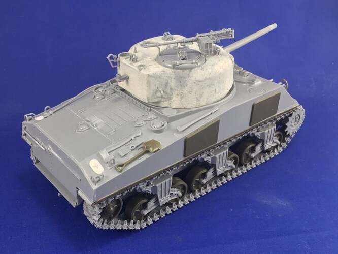

Speaking of the T-49s in the 75mm kit, why are they backwards and how did you fix them? Those images and suggestions could help me tremendously when I complete that build. I did notice when I first looked at the sprues that the T-49 track has some sag molded in, which is probably why I wasn’t going to use them anyway, LOL! but they do look crisp and nice, too bad more manufacturers don’t do link and length, although Tamiya seems to be heading in that direction with some of their newer releases.
I found this video online of this gentleman building the tracks on his, did he put them on backwards too?
Jakko, I found this photo online and it seems to have the tracks on like they are shown on the kit? is it possible that the tracks were completely reversible? I’ve seen images of a tank with T-54E1 tracks were one or two links were reversed.
Yes, all M4 VVSS tracks could be reversed without detrimental effects.

See this thread on Missing-Lynx for everything I found that needs fixing on the Zvezda M4A2 (75 mm) kit. I maintain that all (or at least nearly all) of it’s within the capabilities of most modellers, even though apparently some people disagree with that assessment :slight_smile:
They’re backwards because Zvezda moulded them that way, and I didn’t fix them — I decided to use the Red Army markings for the model, on the basis that they would be much more likely to put the tracks on backwards than the USMC would (which is the other marking option in the kit).
Again, I figured Red Army crews would be more likely to have tracks too slack, so I did use them.
TBH, I don’t like link-and-length tracks :slight_smile: You either have to fit them before painting, which makes painting the whole suspension much more difficult, or fit them after and somehow have to conceal the glue. Which is why on this model, I attached them before painting and then just sprayed the whole underside in a dirt colour.

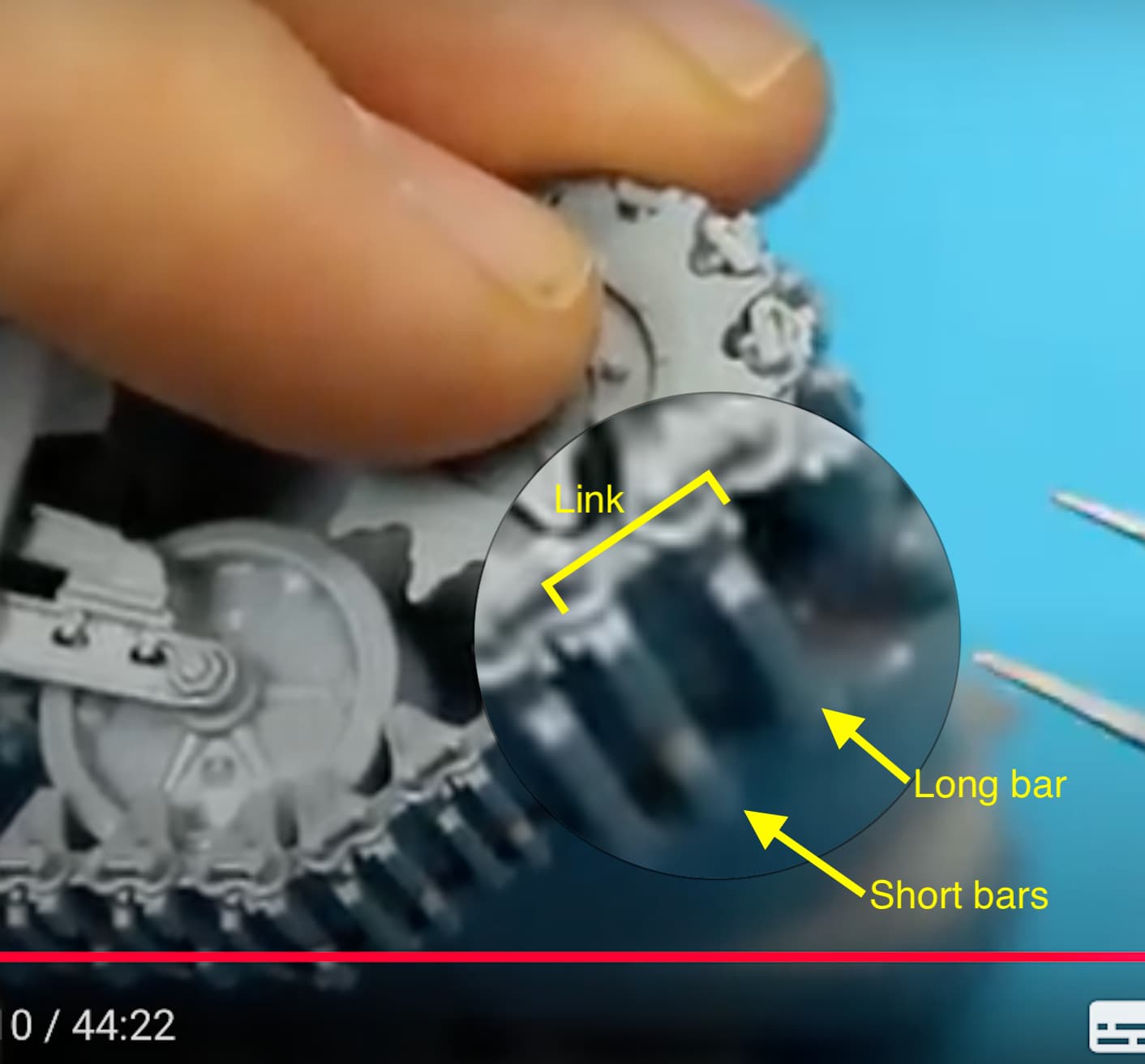

Yes, he has:
At the front, like here, the long bar should be at the bottom of the link. He has it at the top, per the kit parts.
That has them the right way round:
All Sherman tracks are reversible, if you ignore the profile. Though, of course, for T66 (the early type for HVSS) and CDP tracks, you would need to reverse the whole track, not just individual links.

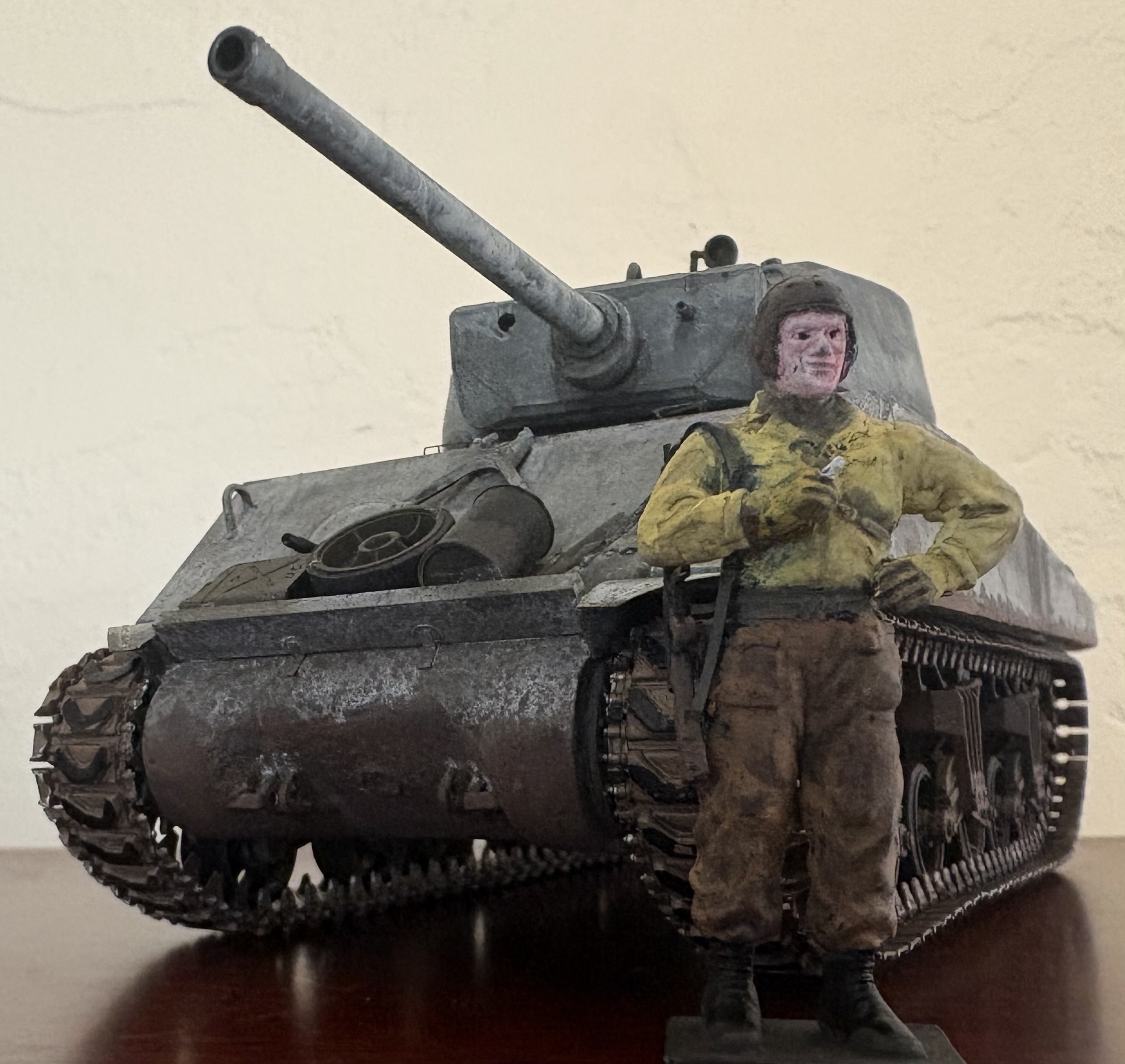

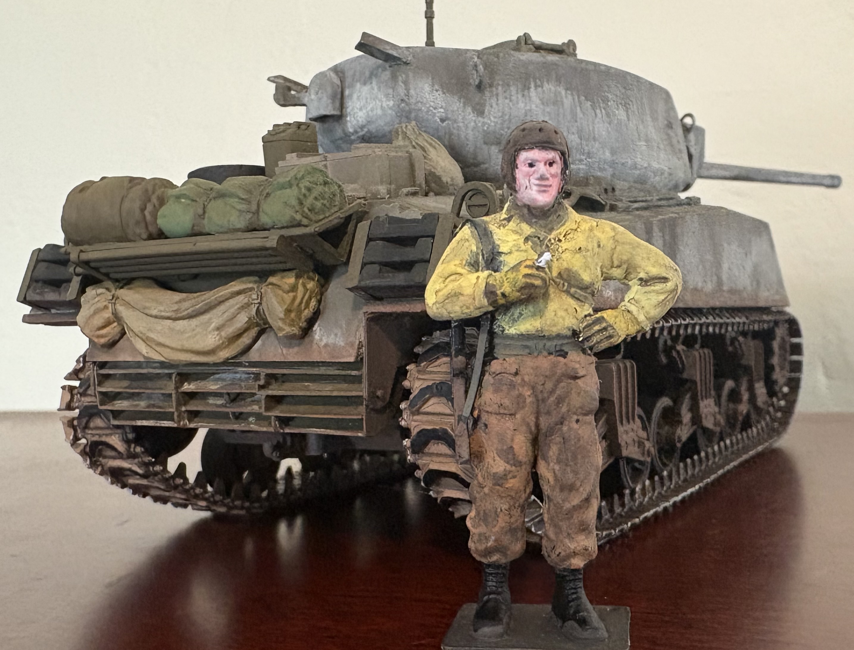

After a LOT of dusting, here’s my Monogram Screamin’ Mimi. There’s a story behind it, as it took two decades to complete! When I was in Junior High as a young teen back in the 70s, a local hobby shop (we had three in easy bike-ride back then!) started a contest. I entered a Tamiya Panther, lovingly given a three-tone stripy camo (OD green, brown, and moulded-tan bare plastic), dry-brushed to within an inch of its life, and festooned with Tamiya’s Panzer Grenadiers - it won a prize! Bouyed by success my next entry was a Tamiya 8-RAD kit-bashed into the earlier 6-RAD (long before the Italeri kit) and I was so happy I left it unweathered in panzer grey - it got nothing. I realised what was happening and vowed revenge - I’d build the crudest old kit and decorate it with catchy details to show that “quality” had no place in their judging! So I grabbed the ancient M4A1 and a bunch of figures from the Tamiya set that was meant for their half-track, along with Tamiya and Italeri weapon sets and some ESCI fuel cans, and went to town. I even made the hatches workable by melting doll-house hinges into the plastic. It was almost complete, when I discovered all the distractions of High School - cars, girls, “hanging out”, etc, and it sat in a box for the next twenty years. But eventually I dug it out for final assembly!
Bear in mind these were the days before the internet, and as a teen my knowledge was limited, so the applique armour is a guess, the crew aren’t tankers, and the weapons are an odd mix - no excuses for the Sten gun or the Boys AT rifle!

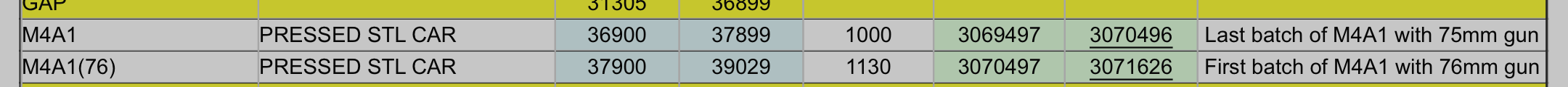

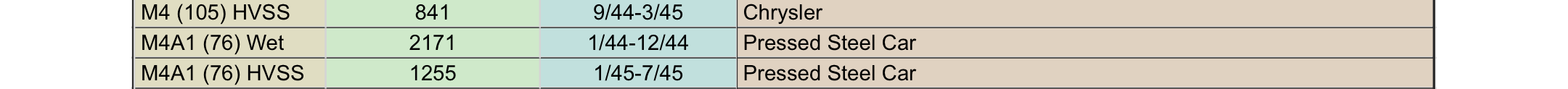

The first batch of (76)w were made at PSC.
A total of 2171 were made between January and December 1944. We know ITM II was one of these when he had several successful engagements in August 1944 around the Falaise Pocket/Gap.
That tank was severely damaged by what is reported widely to have been a P-38. A reminder that a 20mm can do serious things to the top of a tank.
ITM III was lost to history, or maybe rebuilt by enterprising Frenchmen to honor the Allies, all.
Our tank:

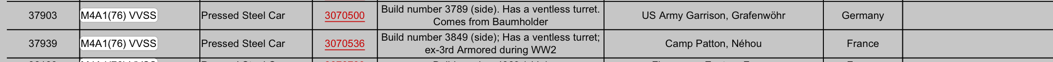

You’ll notice the ventless turret. Well, we haven’t validated the hull/turret RNs or SNs yet (!), but we know of only two VVSS tanks so-equipped that were in American hands:
So, both those RNs come from that very first batch of PSC M4A1(76)w VVSS tanks. All the remaining tanks from that group (8) are in foreign hands. We think.

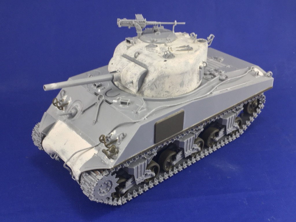

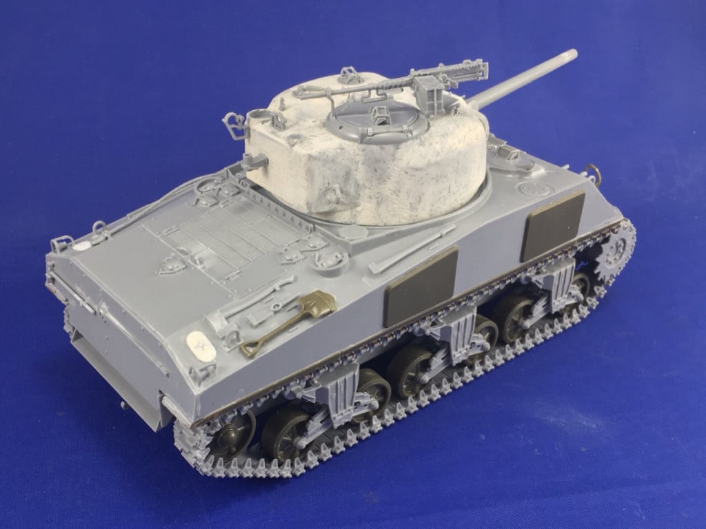

So tonight I played around with the Border Models 76w for about about an hour…the correction on the front of the hull removing the molded on ventilator cover is done. It took about 25 minutes to complete it because I found a shortcut to make it easier…on the inside of the kit the raised outside portion was created by a pushed up indentation on the inside…the indentation was the exact size needed to portray the unfinished look on the those Cobra A1s. I scored the inside corners of the indentation until the “lid” popped off. then I used a small piece of very thin styrene to cover the opening. then I cut the border off of the “lid” section. Finally I glued the lid part back on to the back part right in front of the turret ring area and on top of the tab I place inside the vehicle. I also started the rear hull angle correction. I learned a couple of things, you don’t have to cut that rear hull face completely off because the top edge of the upper rear hull is already at correct length from the measured from front of the tank. All I did was make a cut straight up from the bottom of the hull. Then I trimmed about a small tab from each section and then I just folded the bottom until it became flush with the bottom…I will be sanding and filling tomorrow, the flap is easy to place correctly by using the lower hull tub to align the bottom edge of that lower rear hull.
