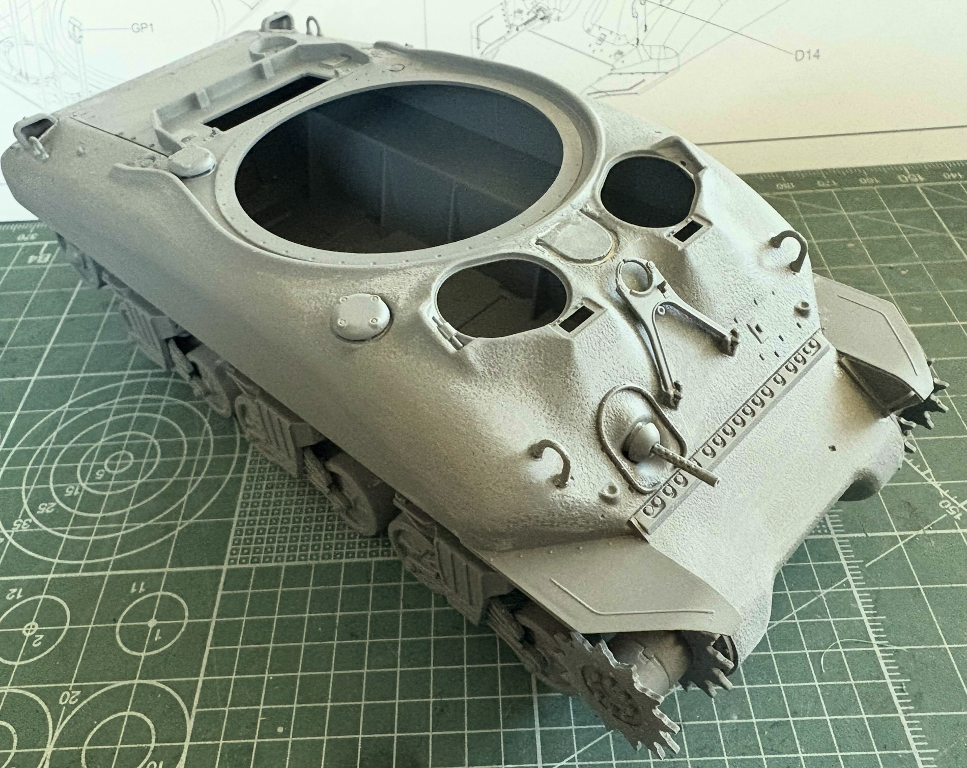

I still think this BM will look decent once it’s finished.
Some progress today

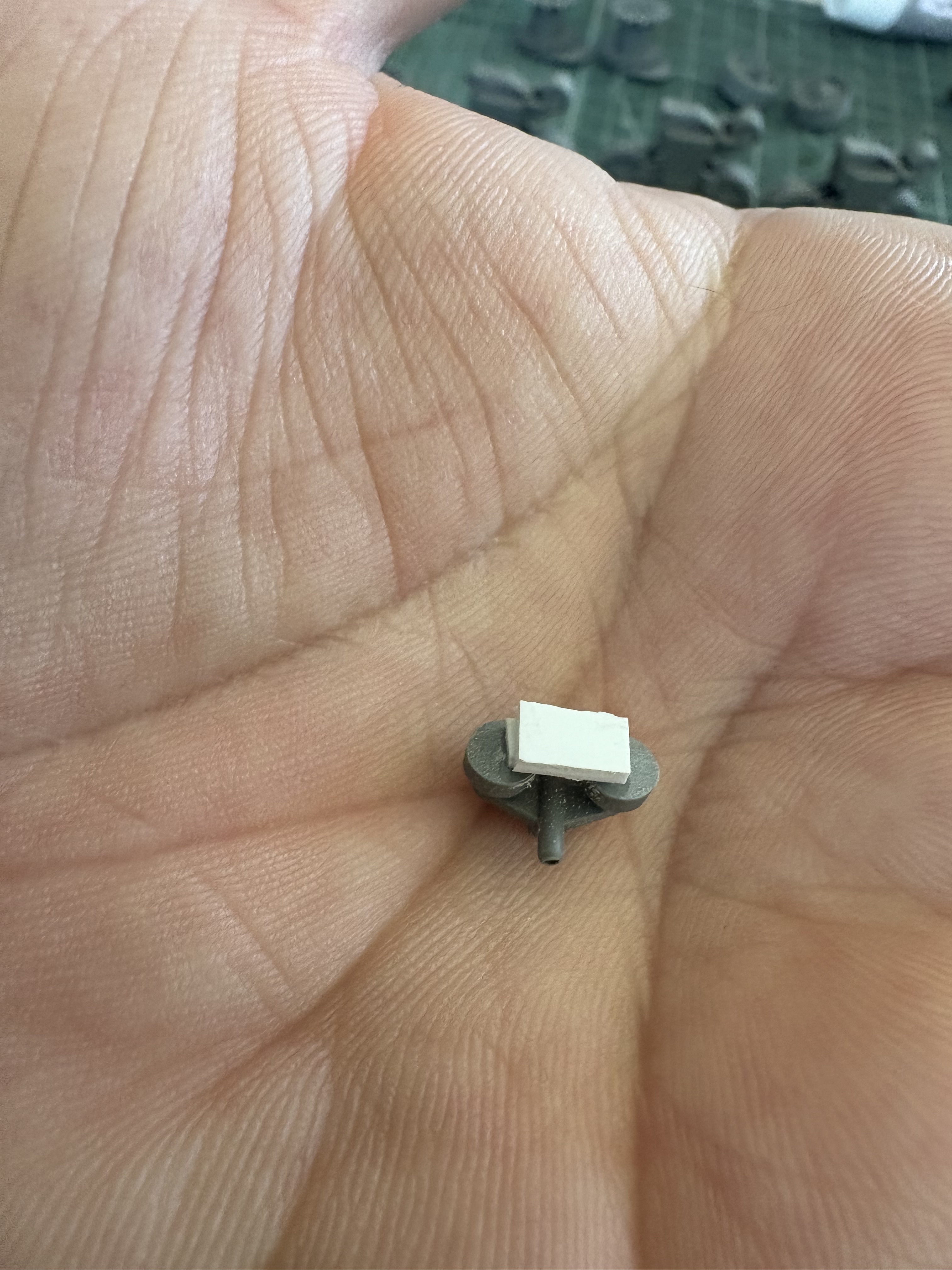

Here is an example of the spacers I had make.
Very nice job so far, it looks great!

The Border Models kit is a DOG. It deserves to be put down. Those craters in the hull, even after sanding, need to be completely filled in everywhere. A little AK Easycast is all that’s needed, if at all. With all the other mistakes these kits are just bin-tastic.

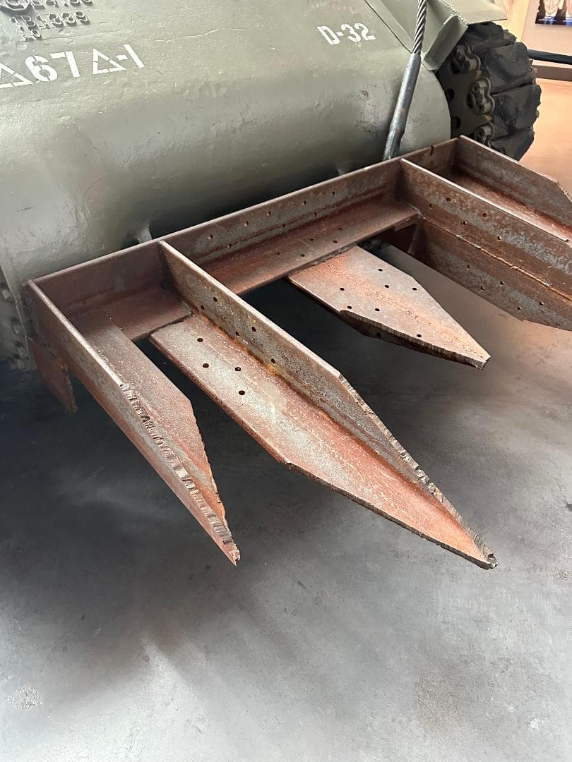

Do any of you guys have a PDF with dimensions or scale drawings in 1/35 that you can share?
You can probably derive your own drawings, the same as I did, from my photos. I took them at the Armor Collection at Fort Benning recently. There was also a discussion last year about whether or not they were welded on. I did not think it made sense to weld them, and I’m pretty sure my photos will bear this out.
I also photographed the one at the WWII Museum in Nawlins. As a field mod, historical photos seem to indicate there was little standardization. That said, having initially been based on German tank obstacles at Normandy, it would make sense to use angled steel of similar dimensons.
I made one (with the wide triangular “wings”) based on a photo of the Cobra tanks being prepped - I’ll dig it out later and do some measurements for you! It was all cut from Evergreen strip, but these days I would probably start with the Gecko beach obstacles for the angle-irons…

We had to fabricate new ones for the M4A1(76)w VVSS we’re restoring/reserving.

I’m such a bonehead, the look I’m going after is this one and it’s not called the “Cullin” it’s called the “Douglas” device. I already knew this stuff before but for some reason I guess it got dumped outta the old database😞
I found this image which shows a frontal view. Steve Zaloga’s book says these were made for 3rd AD tanks only. 2nd AD got the Cullin style cutters.
Then I found this which shows how to manufacture one and I’m not going to make it look perfect, these were field made mods thrown together with repurposed beach obstacles. They might have followed a pattern but these were all individually hand made and I doubt any two were exactly the same. I know that they bolted onto the towing brackets but I’ve seen images where they appear to be welded onto the FDA or at least portions of it are welded on?
