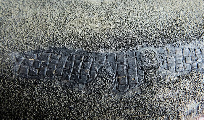

I’m going to be cheeky now, if I may, :smirk:, and ask for your view on something that occurred to me last night :thinking:. Rather than have the worn areas of road smooth, would it be reasonable to presume that the road surface would be layered over old cobbles, and would it be better to hint at such, or best left as it is, :thinking:.
I’ve tried it on one small area, thus far, so as to make it easier to reverse if it’s a no-no, :roll_eyes:.
If anyone else has other ideas please feel free to voice them, :slightly_smiling_face:.
G, :beer:
Asphalt laid over the old cobbles. Yes!!!
I agree with Buckeye.
Adds a lot of visual interest.
Worn through asphalt over an underlying surface tends to break away in chunks when the asphalt layer gets too thin to survive, the chunks leave edges.
Patched for the umpteenth time
A poster by Martin Wahlborg showing worn asphalt over cobblestones
Another, less interesting, option would be sharp edges with gravel/sand potholes
Yes, great idea. Go for it.
It adds even more depth to an already brilliant scene.
From the photo attached by @Uncle-Heavy it’s not only legitimate but would give an opportunity for more contrasting colour. However, those “cobbles” look surprisingly regular. Forgive me for again posting something I think you already have, but this location is only a few hundred yards from the shore and uses water-worn rounded beach cobbles:

They were cut to regular sizes, the rectangular ones are a larger type.
There are also smaller squares (or rather cubes) about 3 inch sides.
These quarried and cut stones are called ‘setts’ or Belgian blocks.
The ones in the photo/poster have been worn smooth, horse drawn wagons with
wooden wheels and steel “tyres” …
Roads were also laid with cobble-stones which were natural “round” stones.
The cut stones were a HUGE improvement since they provided a “smooth” surface that was
easier on feet, hooves and wheels.
Mixes of the various types are possible, old road gets repaired, two roads of different age/importance/traffic volume. In Stockholm we have all those types, also a longer loaf-shaped type, in the Gamla Stan (Old Town) area. The natural “round” ones are painful to walk on, requires sturdy Army boots or steel reinforced workboots (I avoid that street or use the smooth curb stones)

I’ve had a quick play about, especially given Robins images, and have tried to give the edges a rougher appearance.
Before…
After…

There’s also the economic factor, cobbles are naturally occurring and only require collecting, sorting and transporting white setts require quarrying and cutting to shape. I suspect setts only came into general use when the production could be (at least in part) mechanised.
On the other side of town from the cobbled alleyway in the photo there was a street along the front of a terrace of high-class town houses. It was a right-of-way much used by miners and around the time of shift change-overs the racket from their iron-reinforced clog soles on the cobbles was very disturbing; hence, for a time, the road was paved with wooden blocks…

In Sweden we started using setts from around 1920
