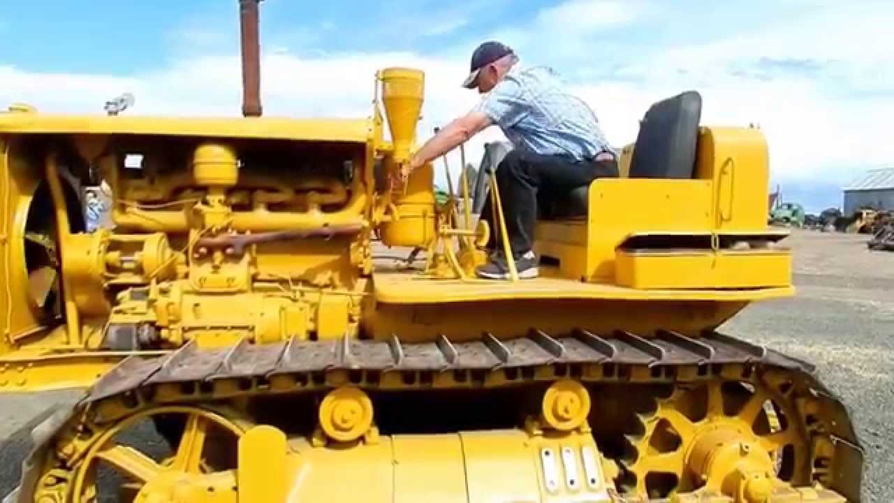

Starting a D8, 1937 model
oh. D8. I knew that. Doh.
Edit. Now that’s weird. The dimensions I can find for the Semple seem to line up almost perfectly with the D7. The D8 has a nose that’s way too long. Unless they moved the radiator?
Edit edit: Definitely moved the radiator. And raised the front idler?

If this can be trusted:
There is a comment “The suspension was modified slightly and the track assembly was lengthened slightly.” If it was lengthened at the front, that would account for how the ‘nose’ on the tractor appears longer based on position to tracks.
There is also this picture of one of the tractors that were the basis for the conversion:
This is from the video of the restored D8, 1937 model, that I linked to.
“Dad” in this image may possibly have had a little more to eat than
the man painting the front end but I would say that the space between
the visible radiator and the tracks is the same the distance between the
radiator hidden behind the front “armour” and the tracks.
The top run of the tracks on the Bob Semple tank also seems to be a lot higher
that on “Dads” restored D8, Could the “smallish” looking front wheel be caused by
using a larger rear wheel and raising the whole thing off the ground by a few inches.
The front wheel is obviously lifted off the ground. The question is if this lifting is
due to a smaller diameter wheel OR by lifting the rest?
Note the difference in space between front end of track and front of armour. The one beign painted above has a lot of space while this one only has an inch or two.
Lenghtened track seems to be the reason for this difference.
Top heavy and high with original track length → probably pitched to much when driving.
