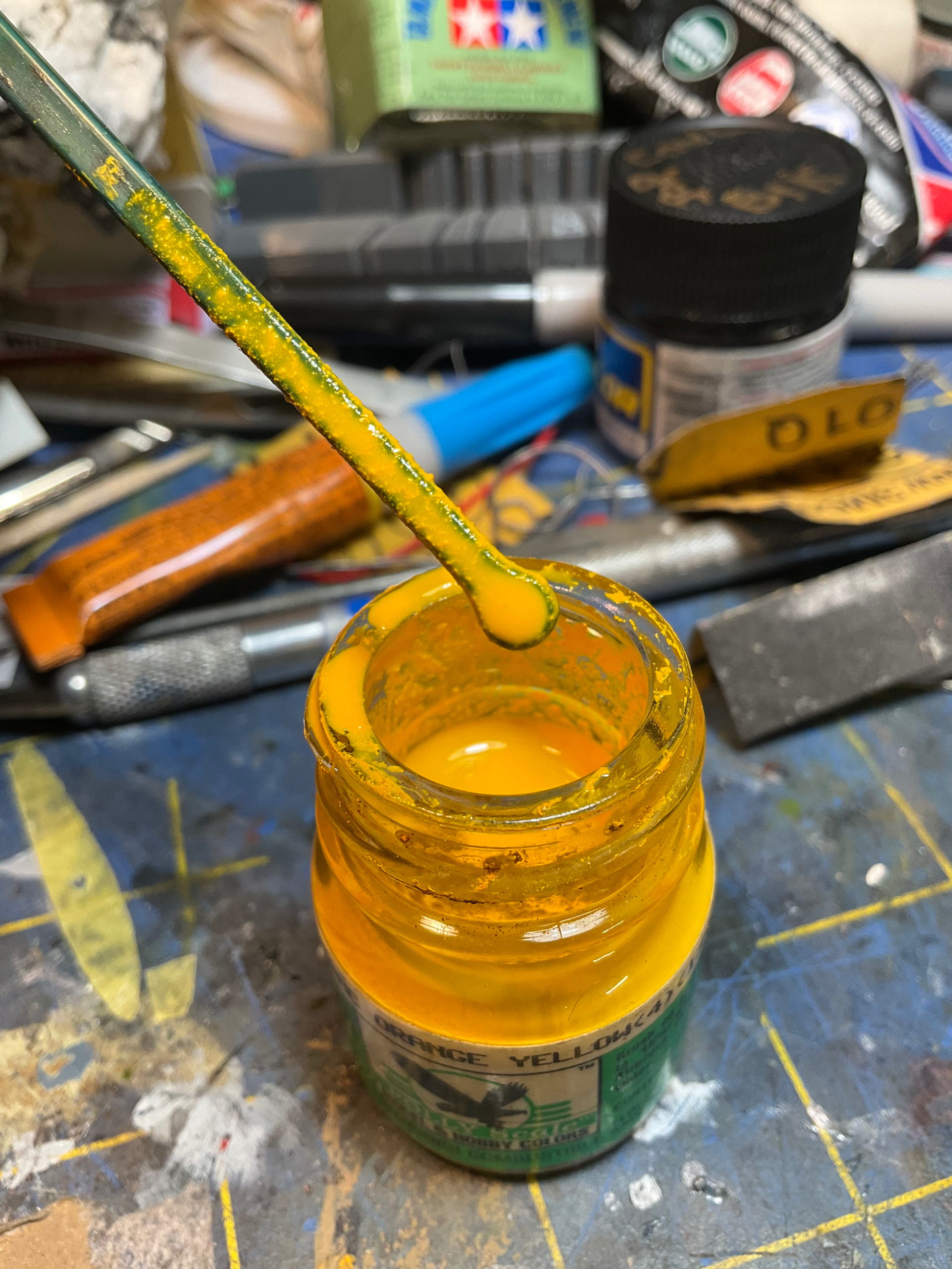

Is this Polly scale paint able to be saved and used or is it garbage? It is acrylic

Dump it and buy new. Life is too short to hose a nice build with an old nasty paint!
Bin it. It looks like the carrier has gone bad. The paint should be more smooth and creamy.
Ditto to posts above.
Have you thinned it with something?
No just stirred it. I will toss it. Save the bottle though since it kept the paint from drying up all this time it should be fine to re use.

Tnhat’s why it’s such a shame to let it go - some of the best paint I’ve ever used. As long as it has not gone completely rubbery you can revive it. First - warm distilled water. If it’s really thick, a retarder. any brand works. Befire you start, get rid of any hardened crap. Stir longer than you think is necessary, strain through panty hose. (I strain it even if it’s fairly new - you never know - an extraa minute of work can save headache later on.)

Funny thing, I still have some that I got in 1979 that they are still good. Label fell off but paints are still usable. Polly S always had a problem with yellow, red, flesh and white. They got gunky after opening.
