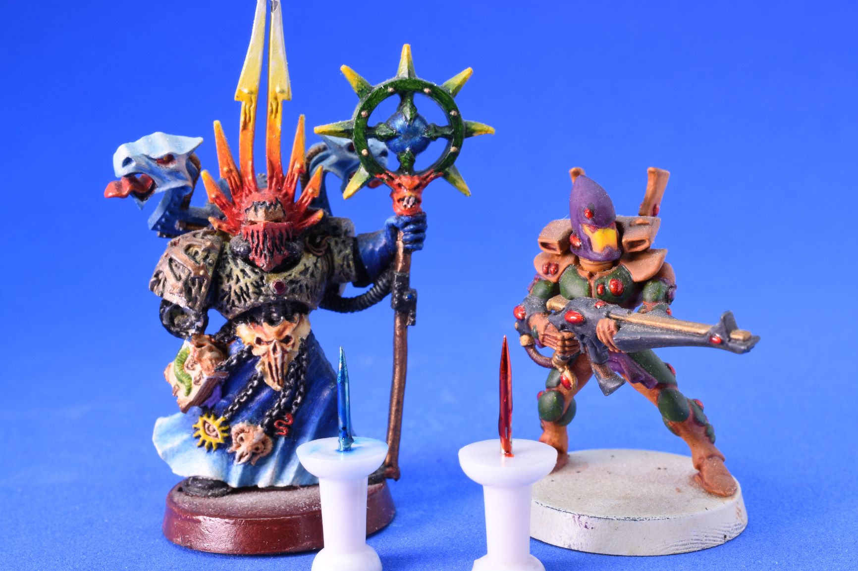

I just tried a quick test dipping a shiny pin in tamiya clear and the results aren’t bad. Here are a couple of old GW figures where I remember using the method years ago (the dust might give that away).
The figure on the left has the blue over chrome/bright silver on the sphere in his staff and the right hand figure has red over chrome on the gems. The two pins in front are the test and the glowing effect is much more pronounced in person.

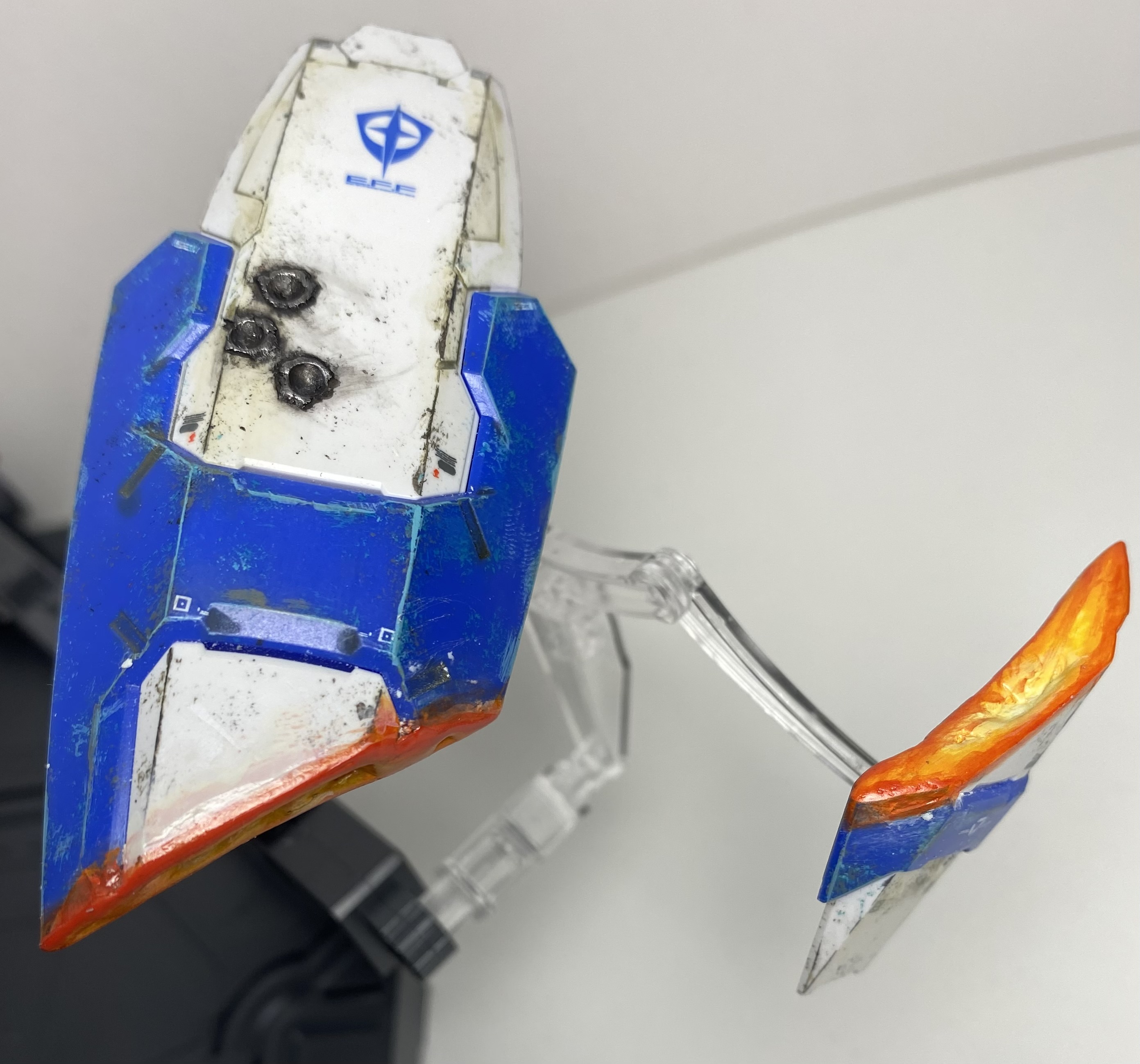

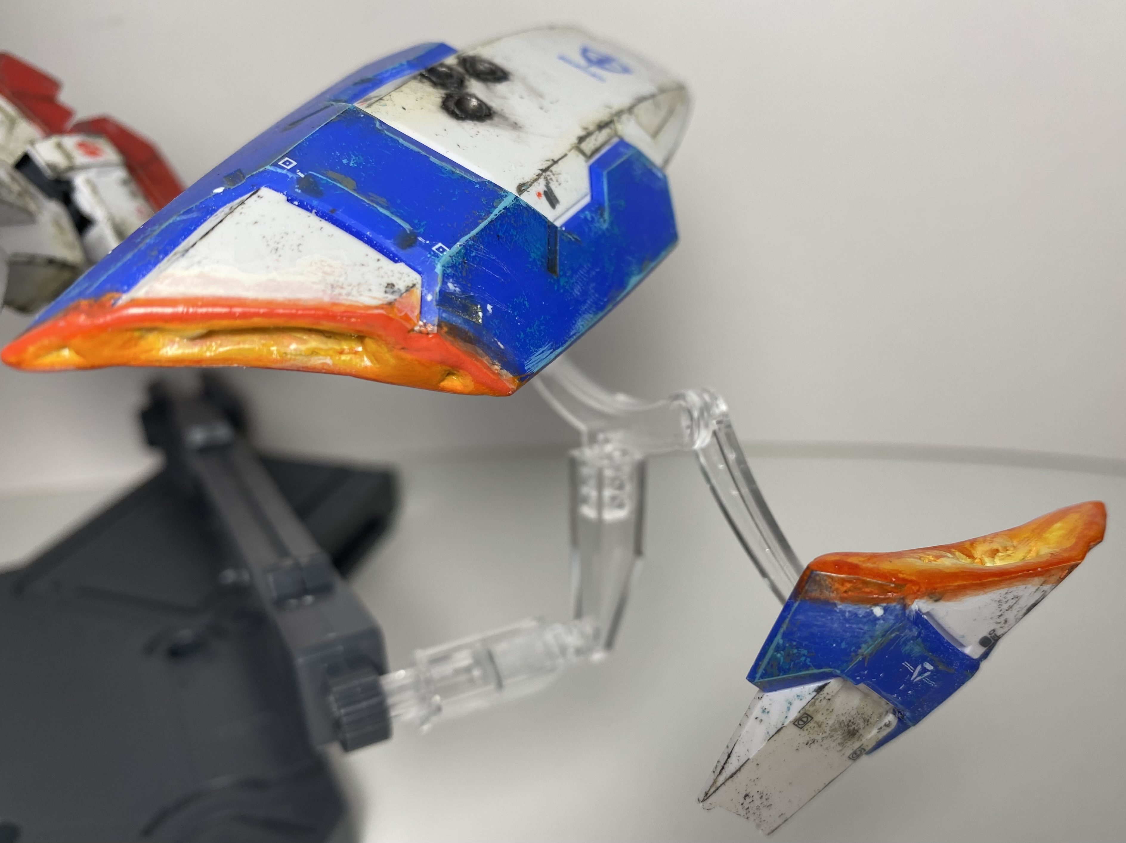

It might not be what you are looking for, but the first thing that came to my mind is glazing. Using very thinned paint, building up layers slowly, and shifting the color to make it look more dynamic.
Here is a pic of a shield and beam saber that I glazed layers on, going back and forth until I liked the look.
