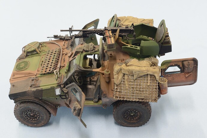

Thanks for looking, I will be making a small base for final presentation but that will have to wait as I’m tucked into a R-WMIK TES Land Rover at the moment.

A very good model. Great mess and additional elements from outside the Tiger Model set. It looks very good. Congratulation.
Great job.
Blast loves you.
PS-what did you use for the colors?
You really built the snots out of this model! It’s stunning! A real show stopper! Beautiful, masterclass work.
Piotr thank you high praise from you, I appreciate it.
Dan, yes I think I should get frequent (buyer) discounts from Blast ;o). For what one can see of the interior BL35243K was overkill. I couldn’t kind the Tiger kits anywhere so I ventured to Evilbay and got the one without the .50.I knew Blast had one and it is a jewel, so delicate and fragile. The wheels Gilles makes are remarkable. Since I bought my resin pieces from Gilles he has added more VBL upgrades.
I use Tamiya when I can but I have Vallejo Air and Model colours as well.
Oliver Carneau has provided this formula on his fabulous website.
http://olivier.carneau.free.fr/gb_version/index.htm
Dark Green: XF-5 Flat Green and X-24 Park Green (70/30). Then I added to this mix some Pale Green MIG 0060 (environ 20%).
Earth Brown: XF-10 Flat Brown, XF-52 Flat Earth and XF-3 Flat Yellow (60/30/10 approximately) then I added some XF-78 Wooden Deck Tan (approximately 10%).
Le noir est du XF-1 Flat Black.
Thanks for looking and commenting I appreciate it.
SSGToms I am blushing, thank you for the high praise.
You threw everything at that VBL kit, that’s for sure! Wonderful to see all those aftermarket bits and bobs incorporated into this- the stowage and weaponry help to show how small this vehicle actually is. Spot-on color and weathering too.
Karl that’s for the thoughtful positive comments. It is a very compact little vehicle and hard to negotiate the build so it could be handled during painting/assembly. My usual MO is to build in as many smaller sub assemblies as I can, painting before assembly then carefully reassemble. In order for me to do the interior the way I wanted I cut the roof off where the windshield surface meets the roof, then reassemble. I built my VAB
which is also French so my mind was kind in the Mali French mode. I had some of the Live Resin parts and some Blast stuff from the previous build as well. The VAB taught me to look at the Mali weathering and modifications and I tried to be a bit more considered about the weathering because some are very “red”.
