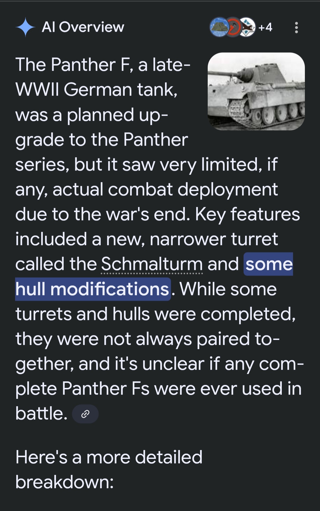

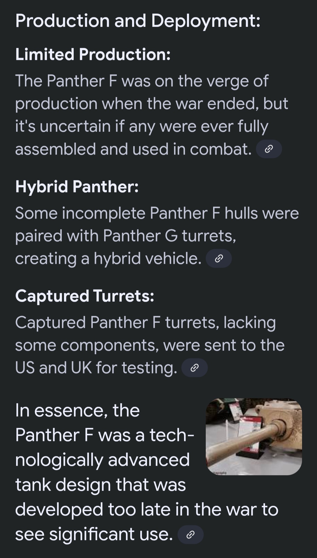

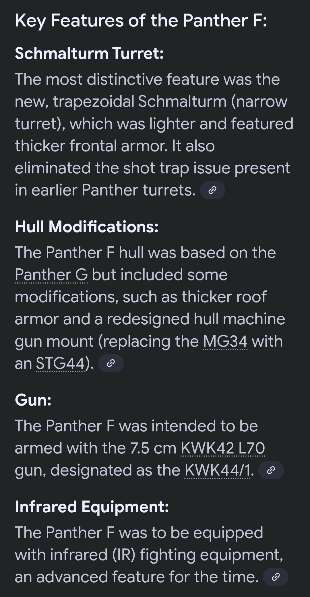

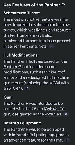

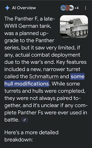

Roughly outline…its AI generated so only a start point. I think RFM’s Panther F instructions might be interesting to look at before building the Dragon F…just for contrast.

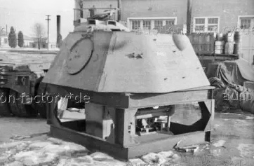

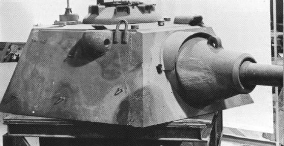

Just one point the narrow Turret wasn’t around when
The Panther 2 project began.
After the cancellation of the Panther 2, the Narrow
Turret was designed for Panther G and F.
The only complete turret went to the UK, and
The camouflage is correct.

Well the Dagon kit fotr starters and the US turrets
Were going into production
As scope front left hand was deleted and plate was welded on top of the cut out
The twin turret sites were not fitted as they were not available
New spare wheel mounts either side of the rear turret new site the same as the Panther G fitted middle front turret.
And some improvements to the rear vertical Hatch
The spare wheel mounts appear to be two separate brackets. Should be easy to scratch up.
I don’t think any kits include them.
They are Daimler-Benz type fixing bracket.
And can be found on DB Panther G turrets .they’re available in resin
And 3DP 1/35 and 1/16 but are expensive
I’ve seen the D-B semicircular brackets, but these look to be two separate piece brackets.
Note the separate shadows.
