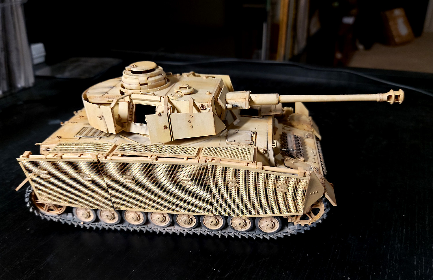

OK all but finished.
A few small details that I’m skipping for the moment. I don’t think they add anything to the finished look. Maybe a bit more weathering. I’m not so sure if I like the schurzen so neat and new looking. Maybe I’ll drive it through some bushes. The aerial is too fat so I’ll replace it.
All up an interesting and enjoyable build. My first AFV and it’s an interior kit.
I can remove the schurzen. That lets me remove the turret and hull top so I can see inside. Bit of a juggle but it wont be happening to often.
Thanks to everyone who answered my dumb questions. You have helped a lot.

Nice job. I like the faded look of the Panzer yellow.
