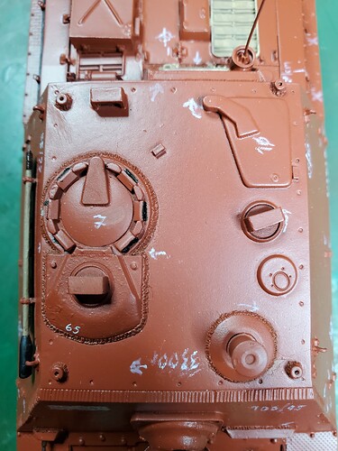

Minor update: added more weld beads to the top, and to finish up the access door/hatch structure. Added brass pull handle to door and brass antenna.

Added skirt bracket plates from TRex, in 3d tan color, out of China, and is applied to both sides of the vehicle. Vehicle number “02” is cut from sprue. The 2 tool stowage clamps on the side of the engine deck are also 3D Passion Models. Barely seen are brass rod lift handles for engine deck access panels, and for the antenna.

I thought to myself that this vehicle never saw the light of day, and being only a ‘paper’ panzer’, why not give myself a bit of literary license when I decided to resurrect this build from shelf queen status. So, I’ve been looking around the 'net for factory builds and saving what photos I think appropriate. Also, to my advantage, I’ve had Adam Wilder’s 1/35 factory markings making this build a huge plus and will surely add to that battle tested unfinished look I’m seeking. That application is a few weeks off into the future (still working other shelf queens as well).

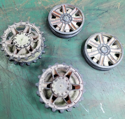

Little bit of weathering taking place. Darkened the zinc phosphate mantlet (dirty factory grime). Gun barrel shows some color separation. Roadwheels weathered to a point except for graphite application on first four steel roadwheels and the non-rubber return rollers. The steel wheels were even roughed up a bit to show previous use. Sprockets and idlers ready to go…weathered, graphite applied, and dull coated. Tracks received a bit more factory wear (installation is later). The tracks are the open horn feature, and from R Model…kit number 35033H. Chassis shows previous owner’s battle dirt. Skirt brackets in steel. The 'Frankenstein" look of this build is beginning to surface.
