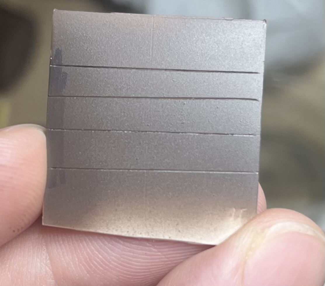

Gave it a try. I think I need to practice once more but it worked fairly well!
Bottom to top is
2 coats of thinned putty
1 coat of thinned putty
Nothing
1 coat of super glue
All followed by a light 2000 grit sand
Two coats of thinned putty seams to win
I’m assuming all grooves started out the same width ? Looks like that did the trick .
They were pretty close yes. I did one initial pass to get the like started and then 2 additional passes with more pressure using the same scribing tool for each. There was probably some slight variation but I think not significant.
