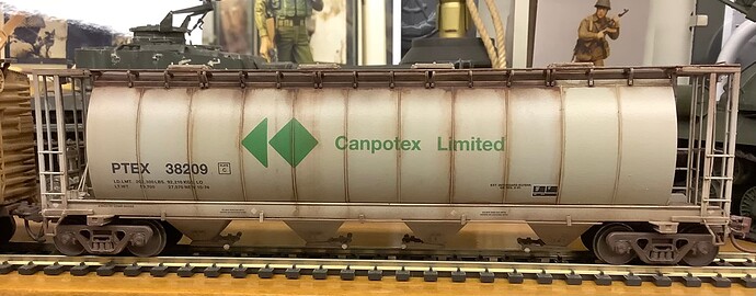

Did some more work on the Canpotex hopper today…
Patched over Monday’s mistake…Tamiya Deck Tan over 2 sections
More panel line wash…
Rustoleum / Tamiya XF86 Clear Flat
