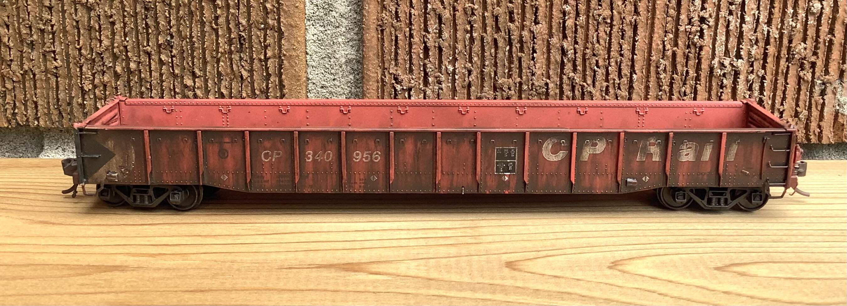

Practice weathering
P.S., as good as your weathering is, I can see why you guard your rolling stock with a Kv-1 and -2!
Lol…sure on the next one

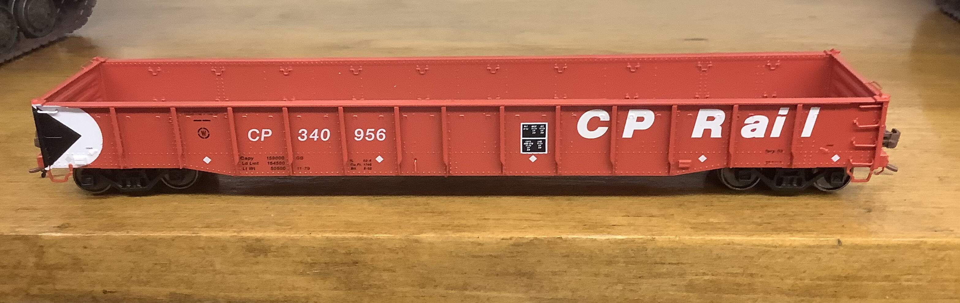

Started another CP gondola…
Masked off the data plate…
Sprayed with a very dilute coat of Tamiya X20A thinner and Tamiya Flat White

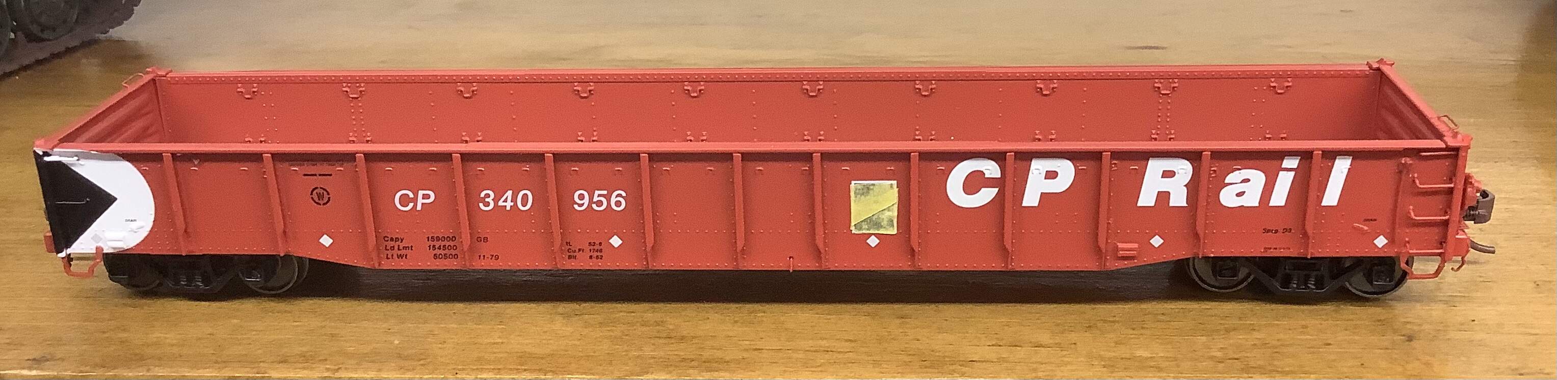

No prob, hit the gondola with another thinned out mix of X20A and a couple drops of flat white to take the CP Action Red to more of a salmon pink…
peeled off the tape off the data plates…
squeezed out some W/N Raw Umber and Van Dyck Brown onto a cardboard scrap to wick off the linseed oil…
Now it’s ready for the oil paint…
Oils blocked in…
Oils removed with Turpenoid ( Blue ) using soft brush and Q-tip…

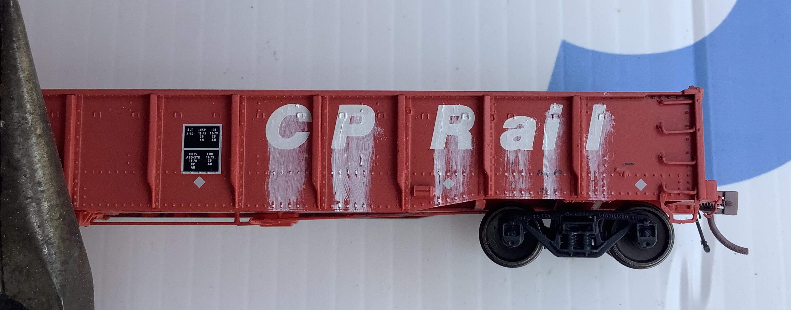

But flipped the car over…and did some logo bleed with Winsor and Newton Titanium White on one side
This will get the Van Dyck Brown / Raw Umber oil grunge treatment once it’s sealed…
Ready for airbrushed grime coat…
Went for a heavier weathering look on this one compared to the CP gondola I did earlier in this thread…but I airbrushed the Tamiya grime mix so heavy the CP 340 956 was barely legible… I didn’t like it so much so about 1/2 hour afterward I took a Q-tip dipped in X20A and rubbed some of the grime off…
I will hit it next with some clear flat…then do some touch up…and move on to the other side / interior
