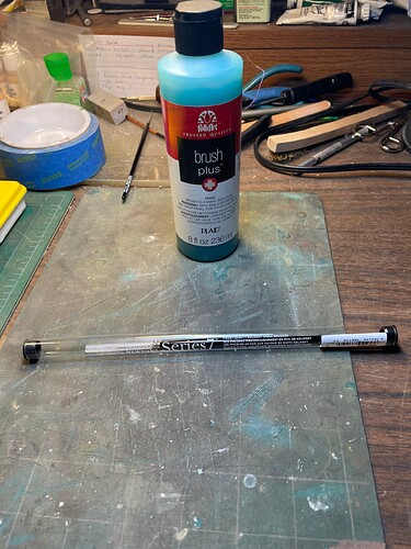

Peter is 100% correct about all of it. I use a product called “brush plus” for a cleaning solution. Since I use acrylics to paint my figures, I swish my brush through this stuff every so often during a session to prevent the acrylics from drying on the brush. Works great.
I store my brushes in there original containers and put them in a plastic box to keep dust off of them. Unfortunately, my work bench is right next to our clothes dryer but I have no where else to put it for now until I finish my basement. So I try to cover all my brushes and models to keep the dust off them.
As far as the size of the brush, I agree that the very small brushes don’t hold much paint and can be difficult to use sometimes. I find myself using the 00 and larger most often now; it has a nice point to it.
Here are pics of what I’m talking about. Hope this helps!
