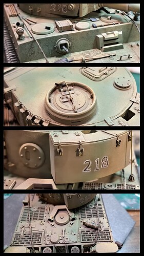

Calling this Tiger wrapped, for the Great Ones Campaign honoring Shepherd Paine, Francois Verlinden & Bob Letterman.
My interpretation of 502nd Heavy Panzer Battalion, Tiger #218 w/waffle zimmerit, ~June, 1944. While the smoke gernade launchers were supposed to be removed, the 502nd had a few early Tigers retain them.

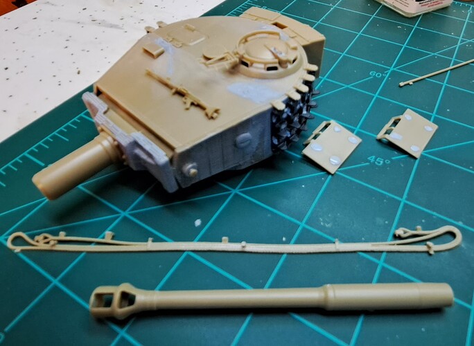

This is the kit used as a parts donner for the 1970 vintage Tamiya Early Tiger. Looks like the tow cables will have to be reworked.

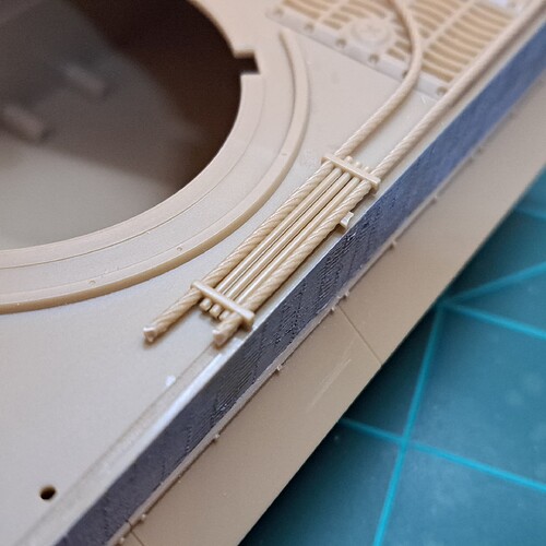

Sealed the gaping void under the grates onthe engine deck with sheet styrene.
Added various parts etc.

Speaking of convoluted, as the major assembly wraps on this old Tamiya Late Tiger 1, I’m struggling with certain 2nd rate parts and missing details like weld seams.
Zero desire to spend a month fixing and tweaking a compromised model (the turret is wrong) that’s a “how to” demo. There’s another Tamiya Late Tiger kit and Tiger Model Design turret in the stash for that sort of build.
The compromise will be…
RFM 3D tracks
Aber main gun
Aber hull & turret MG’s
Aber antenna
Eureka main tow cables
Heavy Hobby headlight
Plastic card periscopes
Add wing nuts
Add tool clasp
No AA MG as most tanks with AA MG’s just pulled one of the other MG’s for that position. Tamiya’s MG’s in this kit make me want to :nauseated_face:
No scratch work - no added or enhanced weld seams.
I think that will kept this one manageable so it doesn’t turn into a year long build like the 1970 vintage Tamiya Early Tiger build did.

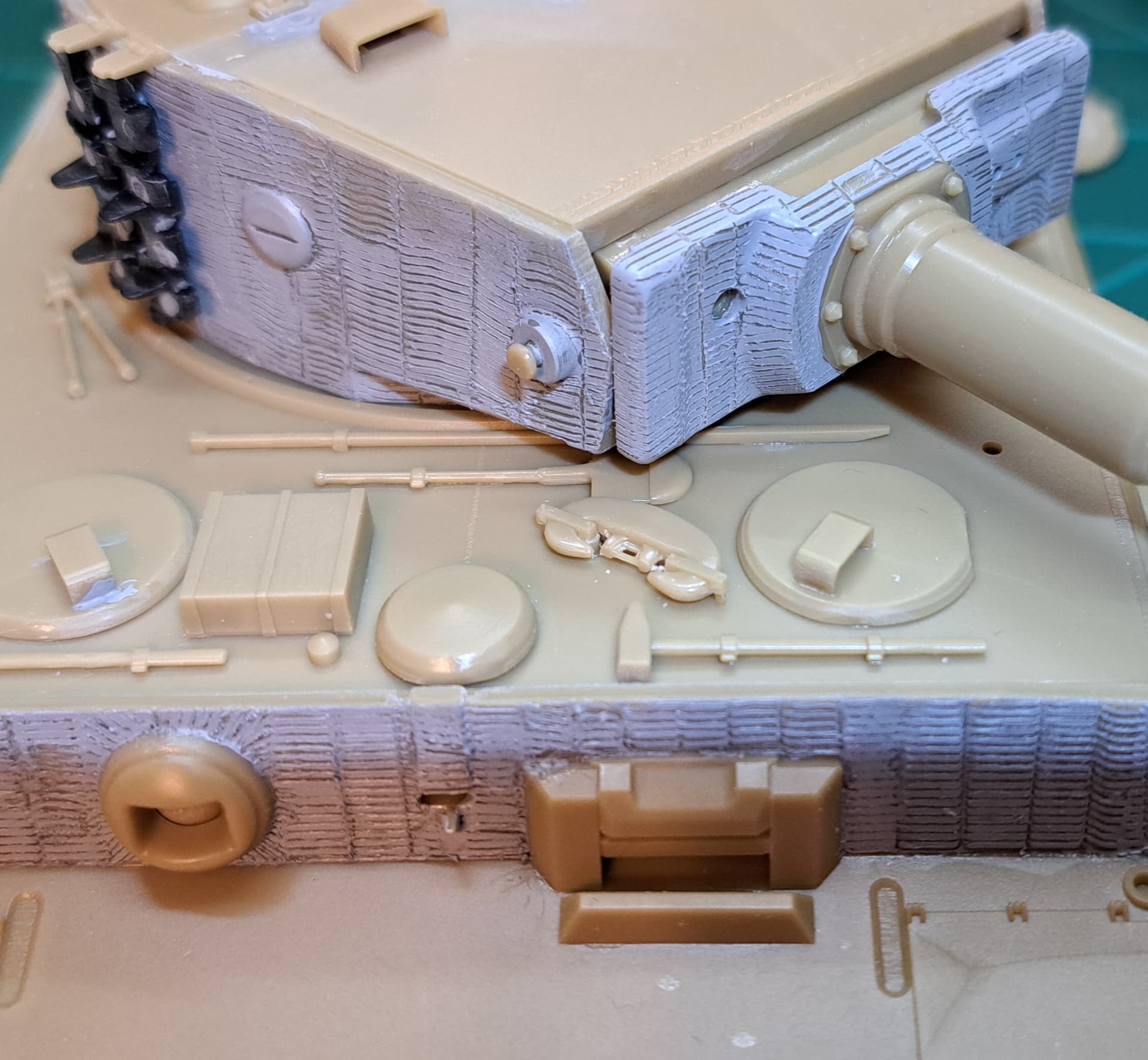

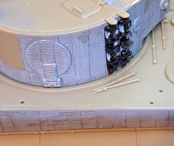

Plummer’s grade Milliput textured with screw driver tip picked based on pictures.
With correct tools, reference and Milliput Super Fine…

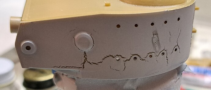

The spray zimmerit silliness worked well enough but definitely isn’t worth the effort. The extra solvent and multiple coats yeild some cracks. Hardly an issue one brush of zimmerit compound took care of it, not that it was an issue.

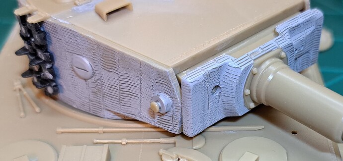

Same technique previously mentioned, apply Testor’s Liquid Cement, reactive coating and texture with Tamiya zimmerit tools.
The zimmerit pattern is wrapped for this Tiger 1.

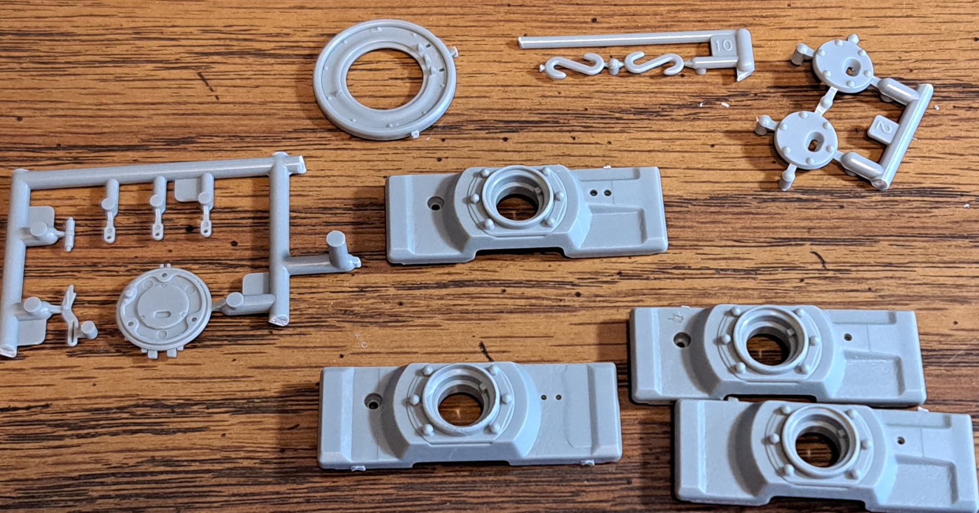

  1. Removed extra parts that aren’t used from trees. These may be useful on a Tamiya Tiger build.
These mantlets definitely have potential to be useful on on a Tamiya kit.
Most of the looks pretty good, some parts looked pretty mid-2000’s but it’s overall very nice looking kit.

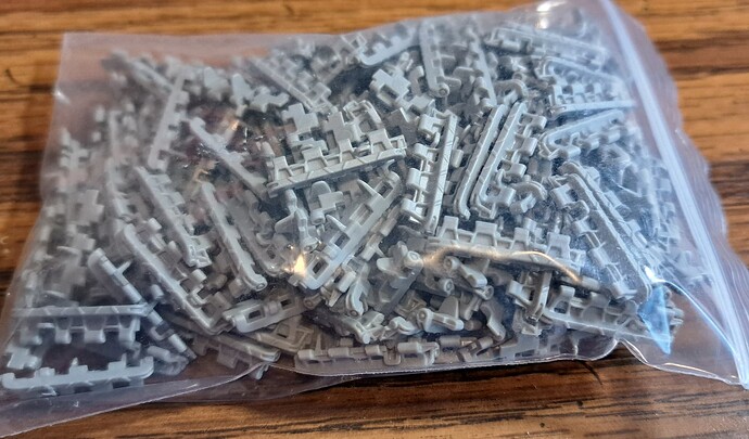

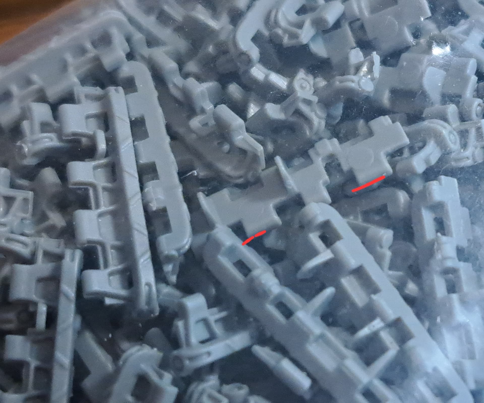

Dragon mentioned replacement tracks with hollow guide teeth can be ordered from Cyber-Hobby.
The kit tracks are OK, removed from sprue so that helps. Two raised punch marks remain to clean up.

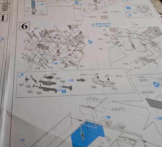

  1. Plan to xerox and enlarge instructions so it’s easier to make notes etc.
