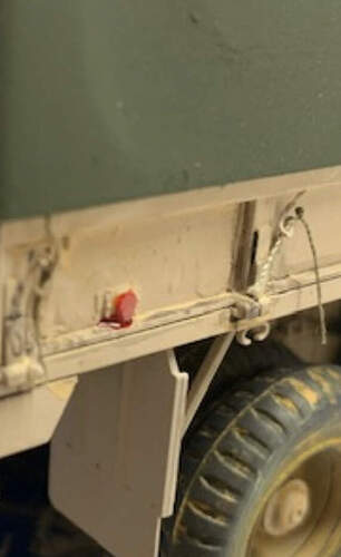

Just finishing my M813. Its been an interesting ride this one. Really hate the way Liquitex covers the wash on the tire walls. Well I had doubts about posting pics of this build. A real struggle to make it work, but that’s my limited skills and knowledge for you.
There are many faults but I think it looks enough like an M813 ( from a metre away) to go on the shelf.image
It looks pretty good to me. Nice job on it. The only thing I would change are the wheels/tires. The Italeri ones are really undersized and the profile of the wheel itself is too flat.
Same here. If anything, maybe add a little weathering to the canvas, it looks too new compared to the rest of the truck. Otherwise, it looks ready to start up and drive away.
Ken
I agree with Gino and Ken - bigger wheels (and without that center mold line), more faded canvas. But what’s in between looks great! Looks just like the old 5T that sat in the motor pool of my MDNG unit back in the 90’s.
That really looks great. Might have to start building done US trucks!
I guess some aftermarket M54 wheels should be useable with this one…(same 11.00x20 size)
Yes, they are the same wheels on both trucks.
