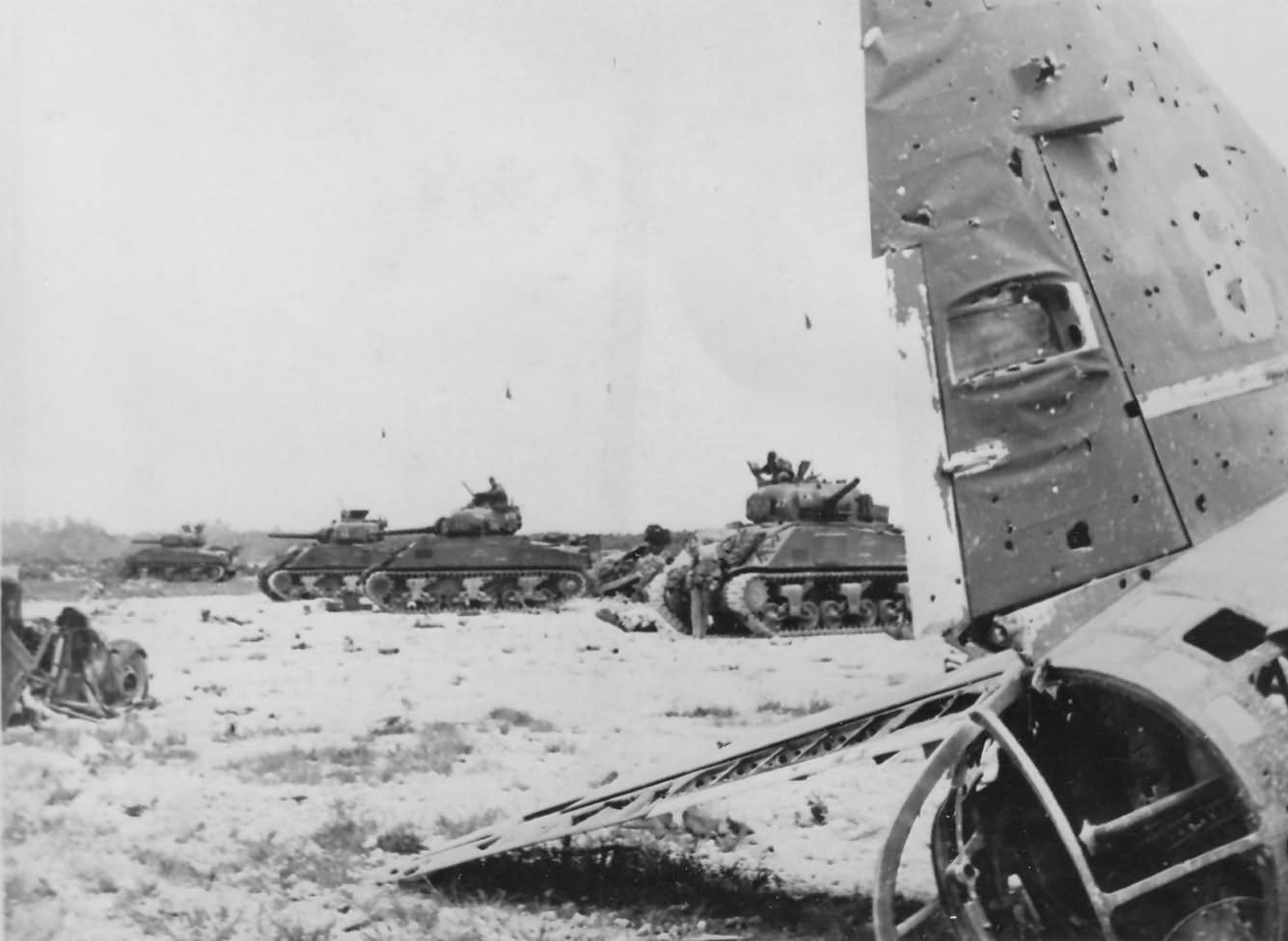

Only 30 Marine tanks came ashore (USA brought some but not really discussed), so all where repaired daily. 9 where left on the island as total losses.
This is the airfield which suggests all wading gear was removed.
If you wanted to make wading gear Italeri kit had some and Fine Scale Modeler had paper plans for one in the late 90’s as I recall.
Hope that helps.
Your first photo is from guam (4th marine TB?)
The airfield one is definitely Peleliu but they all have their trunks on, I’be seen a better higher resolution image of that same photo and the trunks are clearly visible.

Both images from Peleliu. Large hatch M4A2 with tracks welded to the turret. Not great views of the rear but this is later in the battle and I have read that all wading trunk equipment had been removed.
