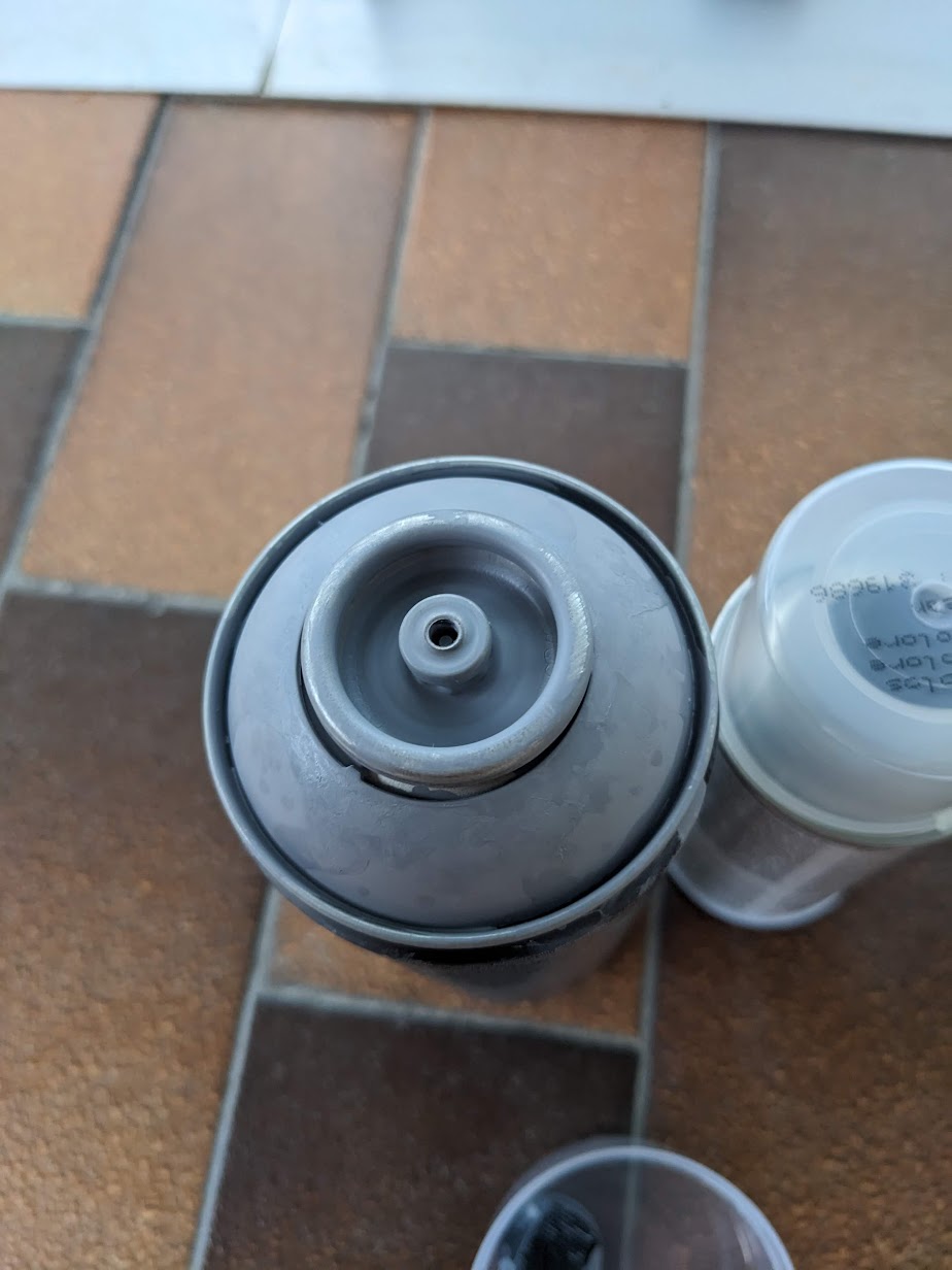

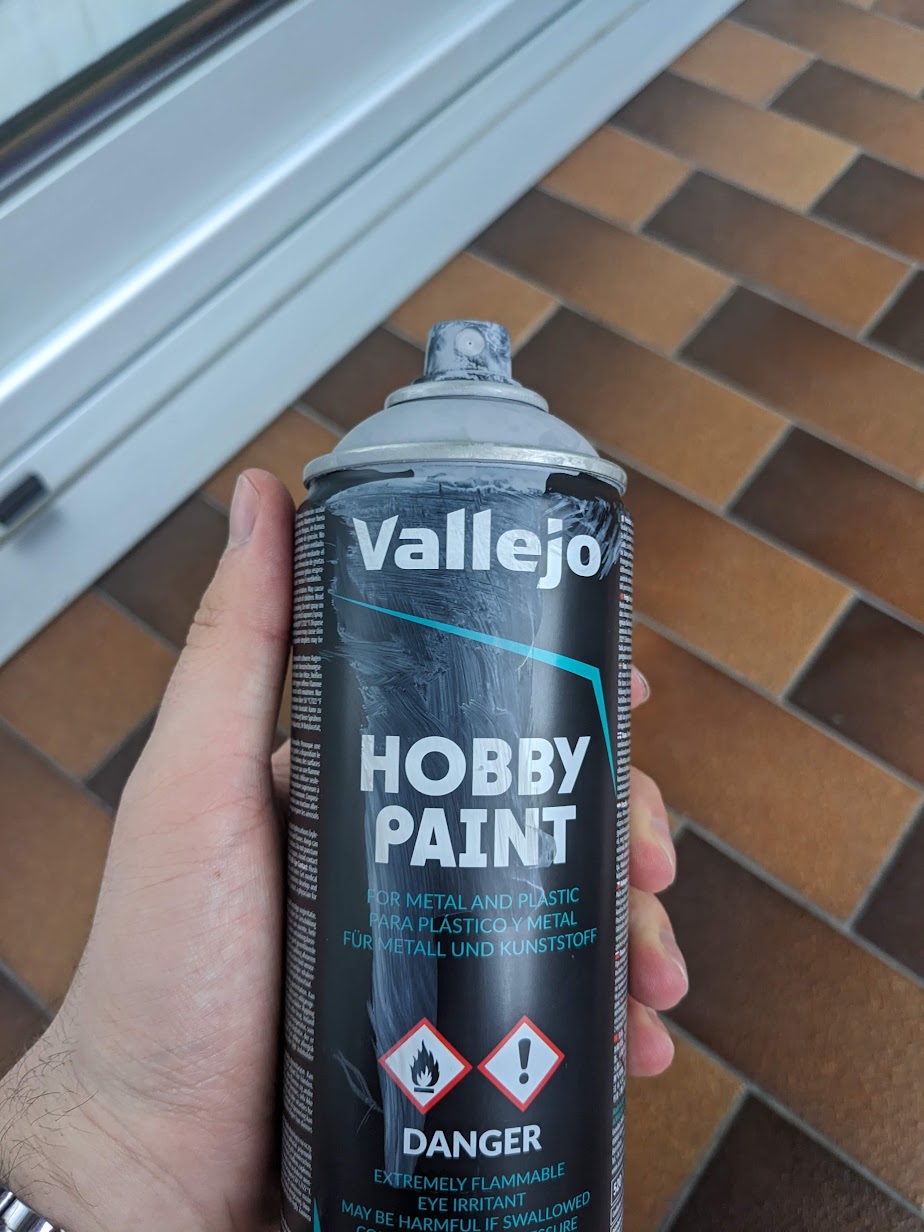

I was trying to prime with a new can of Vallejo primer (I have never used Vallejo’s rattle cans before), but when I tried to use it, the paint (in addition to spraying a bit from the nozzle) sprayed from around the nozzle head, covering the nozzle head and the tip of my pointer finger, as well as splattering an area in front of the can. Upon a longer press/spray, paint also seems to run down the front of the can. The attached photos show the cleaned up can, nozzle head, and the top of the can with the nozzle removed.
Has anyone experienced something similar? What could be the cause?

I’m not sure if it’s a lack of CO2, since it sprays with force, not sputtering, as you described.
I’ve never had that happen with a new can, but with older ones I’ve simply swapped out nozzles. Perhaps it was defective.
Could be. I tried both included nozzles, but the same thing happened.I have clear primer, but I would like to have the color to even out the surface.

I tested it out on cardboard before priming the model. In this case, I was going to prime figures and stowage. I was able to prime a few bits of spare track, but it was still having the issues described above. Paint does come out of the nozzle, but other paint comes out from what I assume to be around/under the nozzle head.
I once worked in the lab of a spray paint manufacturer. The valve (the part the spray head goes into) is possibly defective, as may be the spray head, or the spray head may be partially clogged. The clog can happen if the spray head is slightly depressed at some time after filling, allowing a small amount of paint to enter the head and dry there. It is also possible that the proportion of components in the can (paint, reducing solvent, and propellant) is incorrect. Or all of the above. Essentially, you bought a defective can. Take it to where you bought it and ask if they will replace it.
If not: Try cleaning the spray head by soaking it in an appropriate solvent, flushing it if possible. Inspect the stem for blockage and remove it if you can without damaging the head. That’s about all you can do, as the valve is not accessible, and it’s dangerous to try.

tip may be clogged you can try soaking the tip in some paint thinner to loosen up the booger I ordered a whole bunch of diriment tips from amazon just in case. Also, when you are done give it the old upside-down spray to clear the tip that des help. If it’s a lack of accelerant then disregard I don’t know how to fix that. You could try removing the tip and blowing on it like a ballon. :wink:

Re: OP, Vallejo may have supplied the wrong size nozzle(s) with this can of paint or the can opening is defectively too large. If the stem of the nozzle is too narrow then this leakage will happen.
