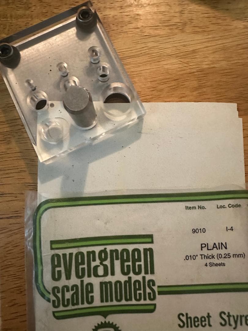

It would obviously depend on the style, but I’d probably start by punching some appropriately sized discs:

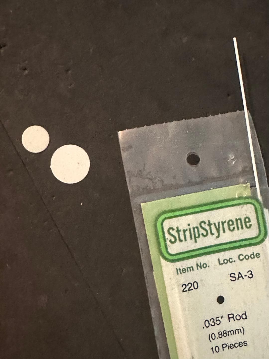

Then I’d add a ring of rod around the edge:
Make two. Add a center core from larger tubing, and whichever details you still need.

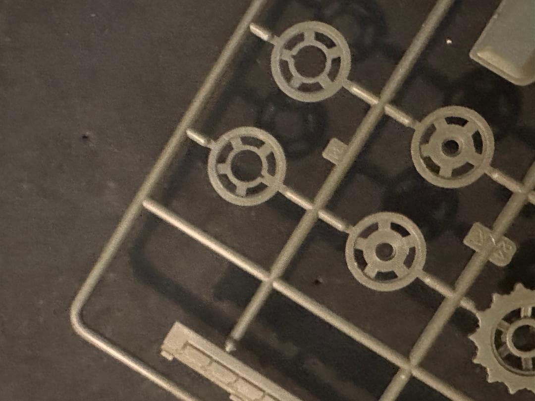

Or if you just want something generic that looks the part, find a crappy kit, bogart the parts you need, and sand them until you get the appropriate “thinness” that you need:
Is this a BMP kit ?
Yeah. Why? You need parts?
No, just thought I was aware of all the BMP kits available but this one is unfamiliar to me.

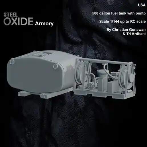

In the picture on the#4 post it looks like 2, with one sideways and the other longways. See what you think. Wayne
Had a closer look and I think you’re right. I’d love to have more info on the cradles that were used to support these bladders. I also wish a 3D printer would make the cradles, pump and hosereel pieces for a setup like the one in that picture.

If you are still looking, I just found a full TPU file on Cults 3D. You can print as many tanks as you want and have a fuel pump unit for them as well.
