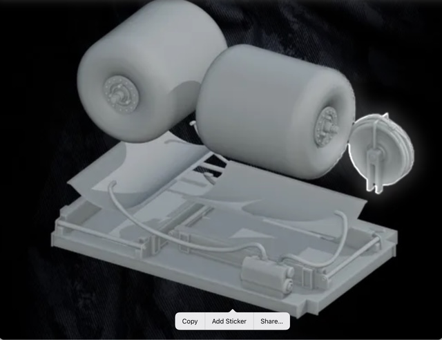

Hey Wayne, I’m in the v early stages of an M548 Refueling wagon and I need some advice. I’m finishing it in MERDC Red Desert so the cab will be open.
I have the 3D printed main deck, pump and hose reel to print and my first question is; does the raised floor from the standard M548A1 go in under the main deck or is this part left out?
I’ve attached an image of the 3D print to clarify my question.

This is available from Steel Oxide;
While I don’t have any actual knowledge on this, Looking at this picture and checking the fit of the kit parts, I would guess that there is a frame that slides in on the raised floor, which the bladder cradles, pump and hose reels mount to. Fire extinguisher in back. Just my take on it, see what you think. Also, pump motor in the picture reminds me of the ones on the quad 50 mount on Nancy. PS After looking at your pictures it appears that they added a piece on the bottom that may replace the raised floor piece. Won’t be sure without seeing real part to compare. Please let me know when you have them in hand. Wayne
Thanks for that. I guess it’ll be easier to i d the size and positioning of the piece under the floor deck in the pic I sent once the deck is printed.

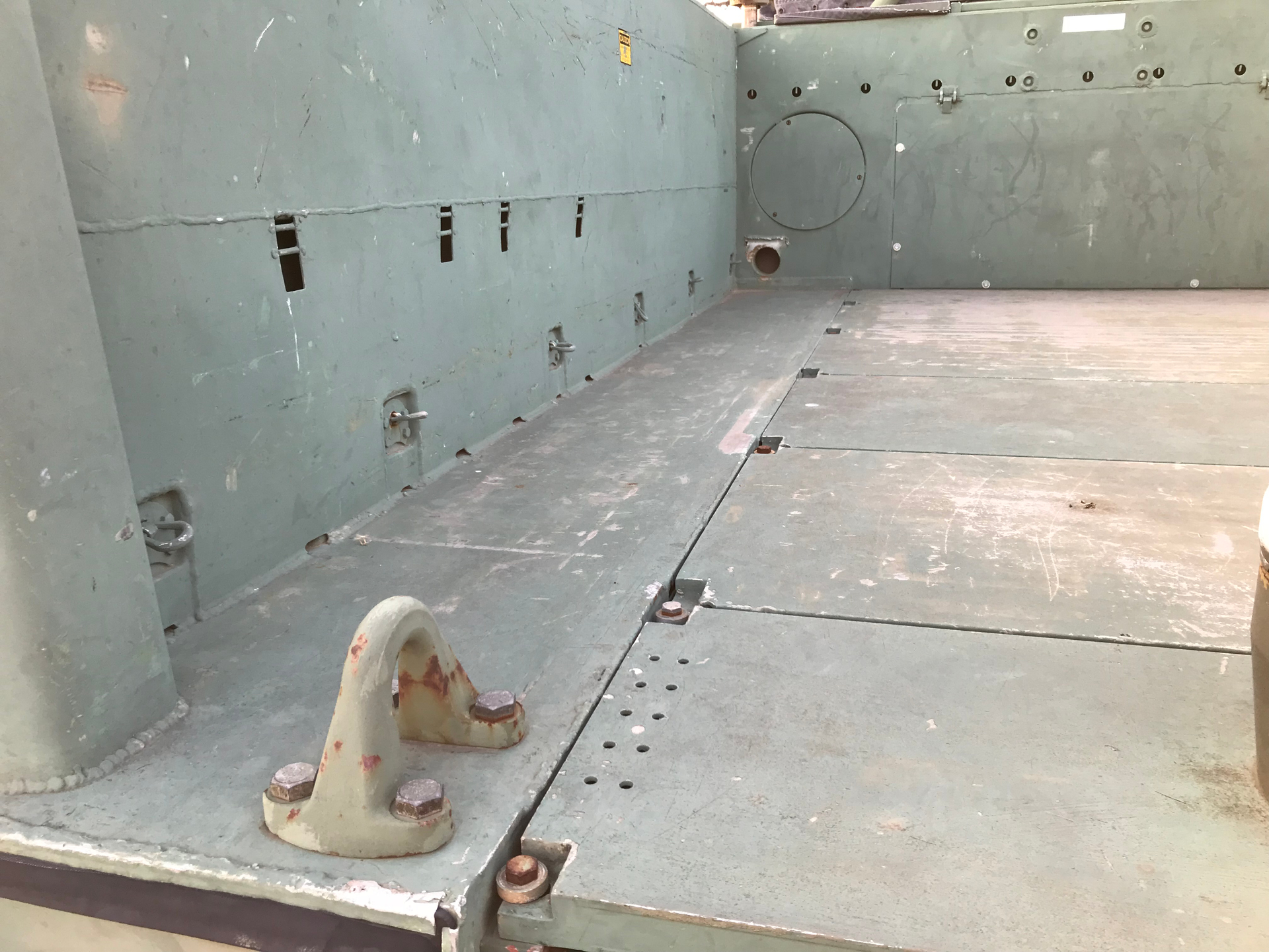

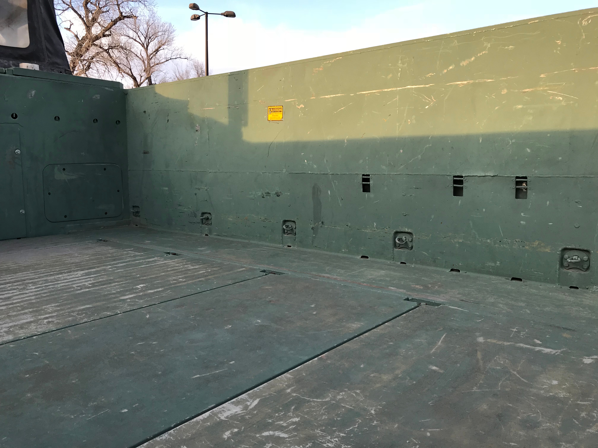

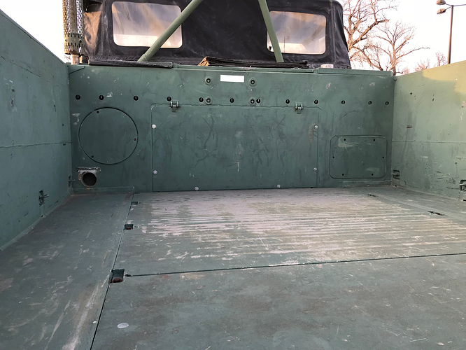

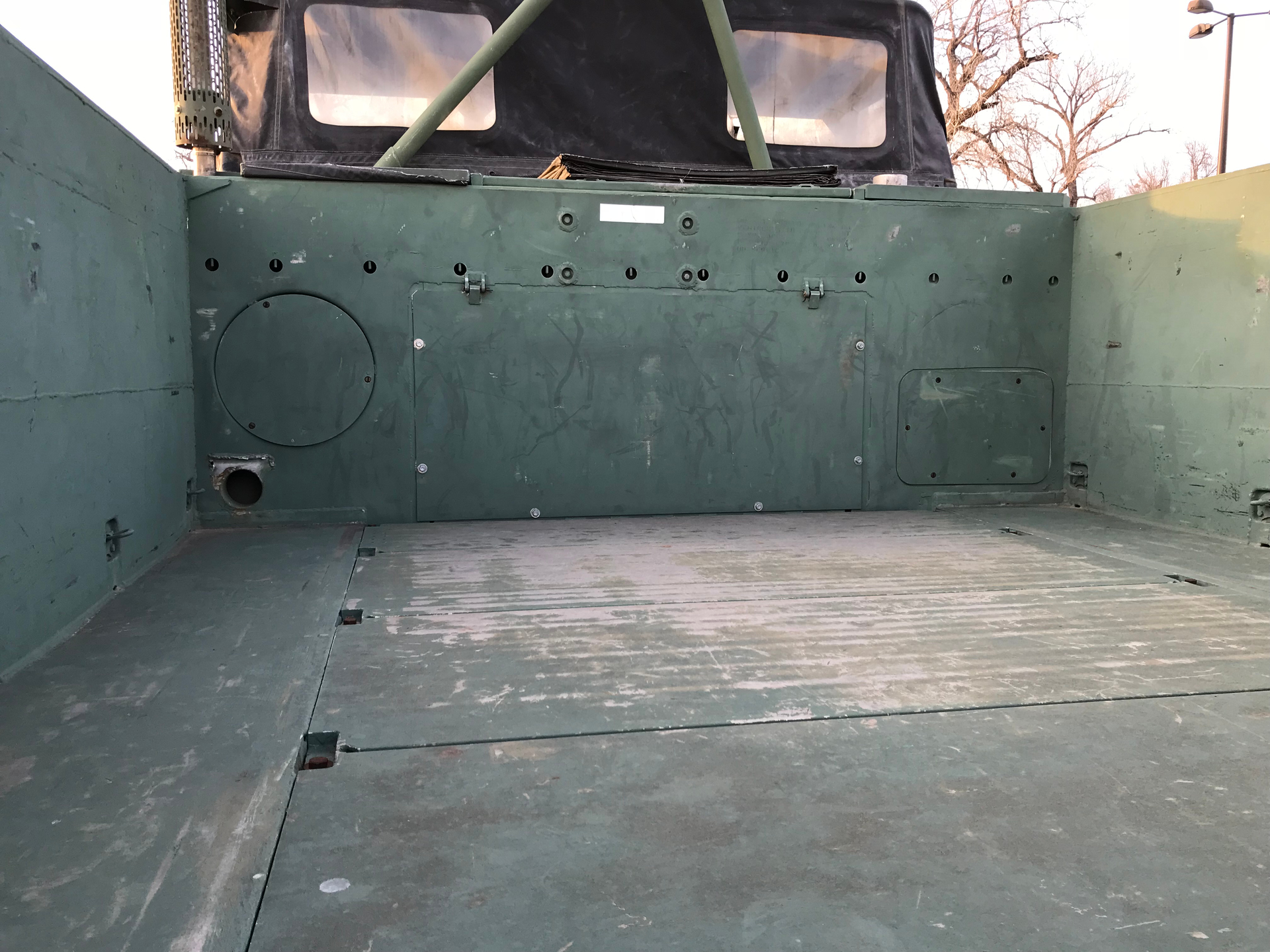

Here are some photos of the inside of the M548 cargo bed.

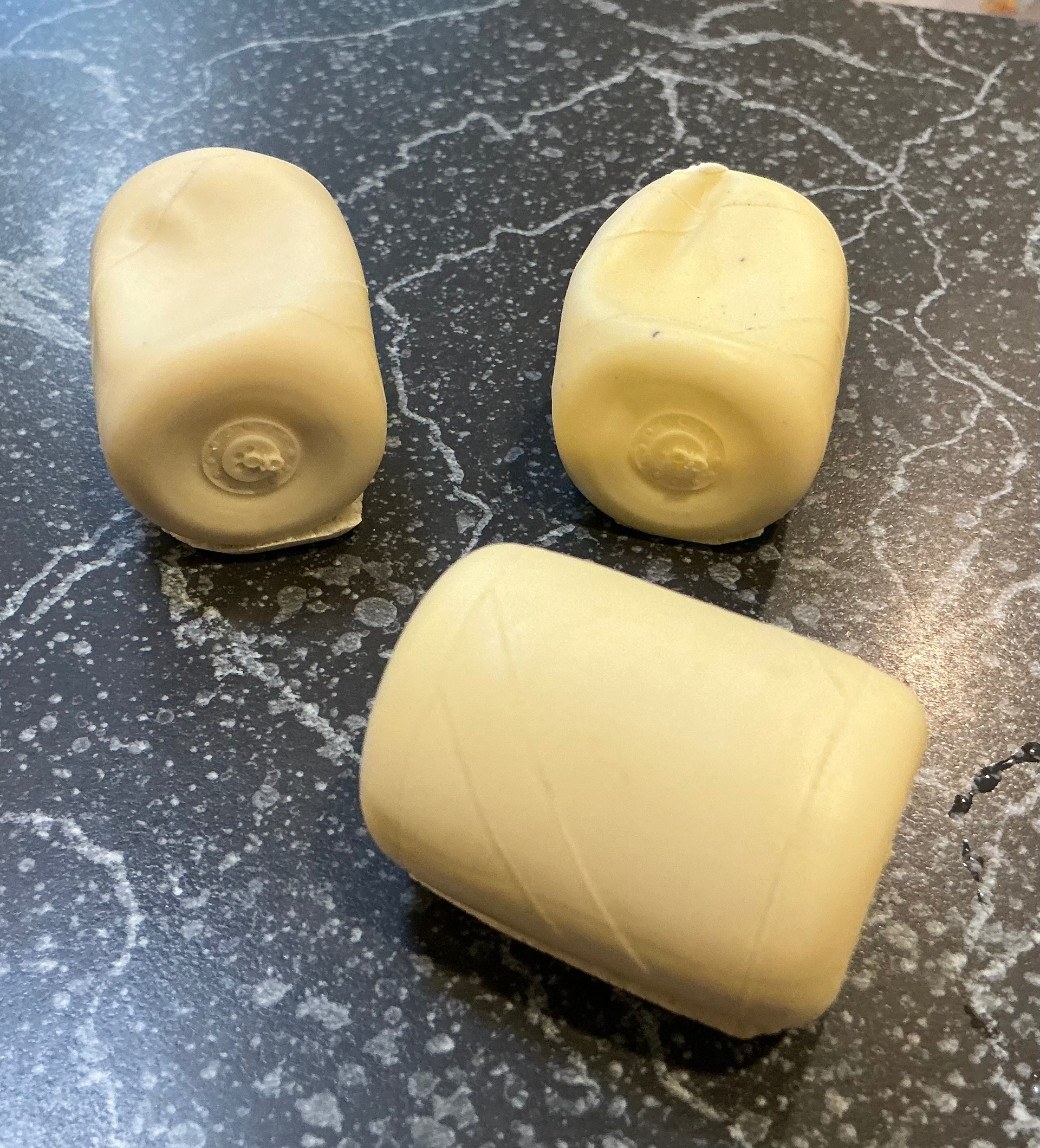

Here you go.
Looking very nice to me 18bravo!
Those do look very nice. I like the partially deflated look, very realistic. Wayne
Thanks for the pics. Not sure how I’d get all those details added. Wayne

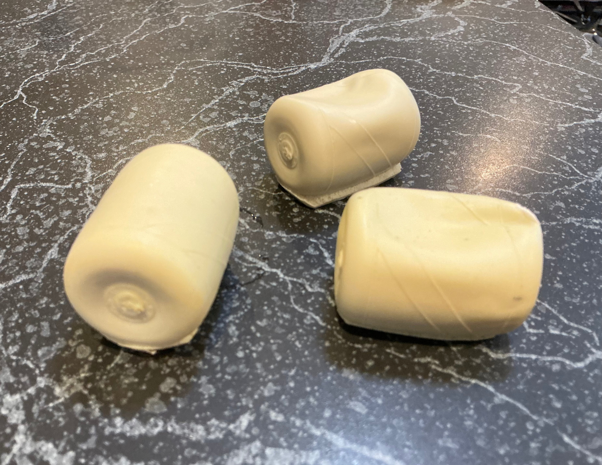

Would I be right in thinking a razor saw is how best to remove the pouring blocks under those bladders? I’ve got to get them slightly rounded underneath to fit the trays that Steel Oxide designed for them.
I use a barrel shaped steel cutter on a dremel.

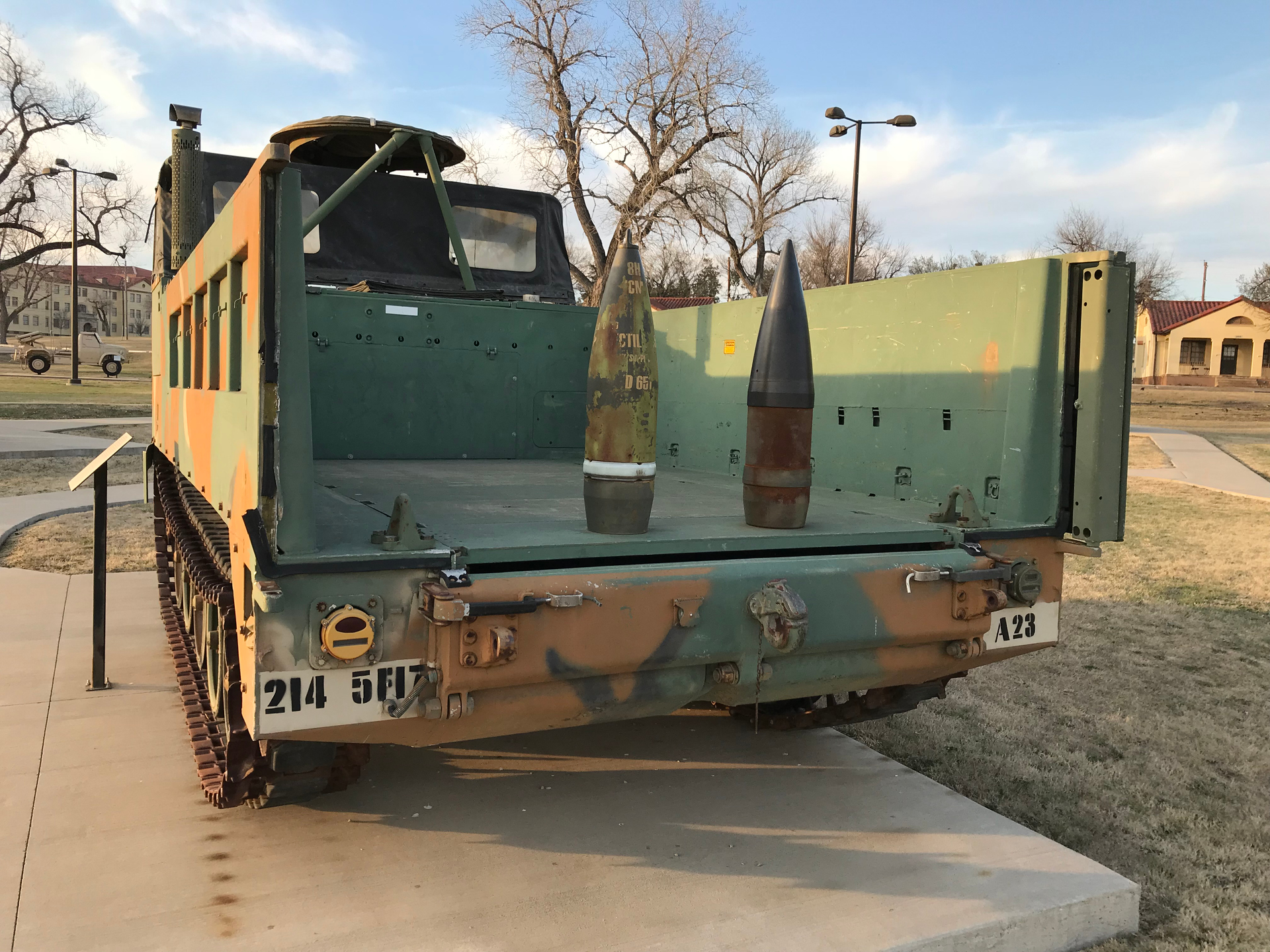

Anybody know if the M548 was ever fitted with a steel roof? Google says it was for desert service but I am darned if I can find much information on it. The AFV Club kit only provides a canvas roof.
