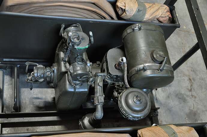

Refueling setup

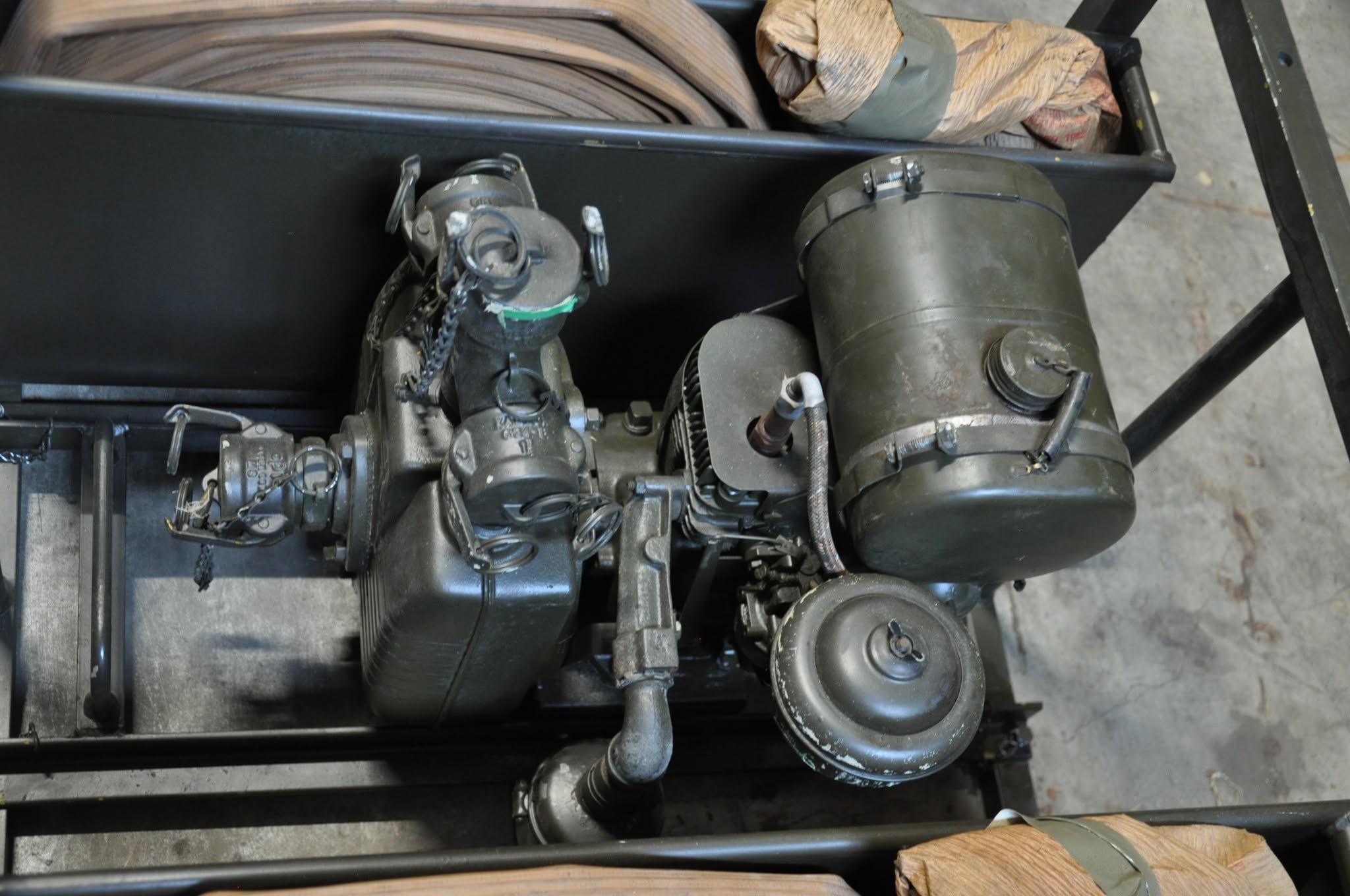

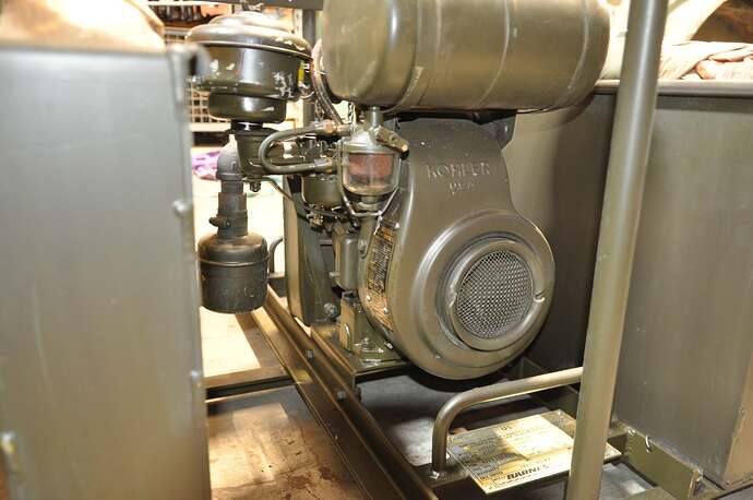

The pump engine below resembles the generator engine on the Quad 50s mount
Boredom. I saw a lot of strange things built that way.

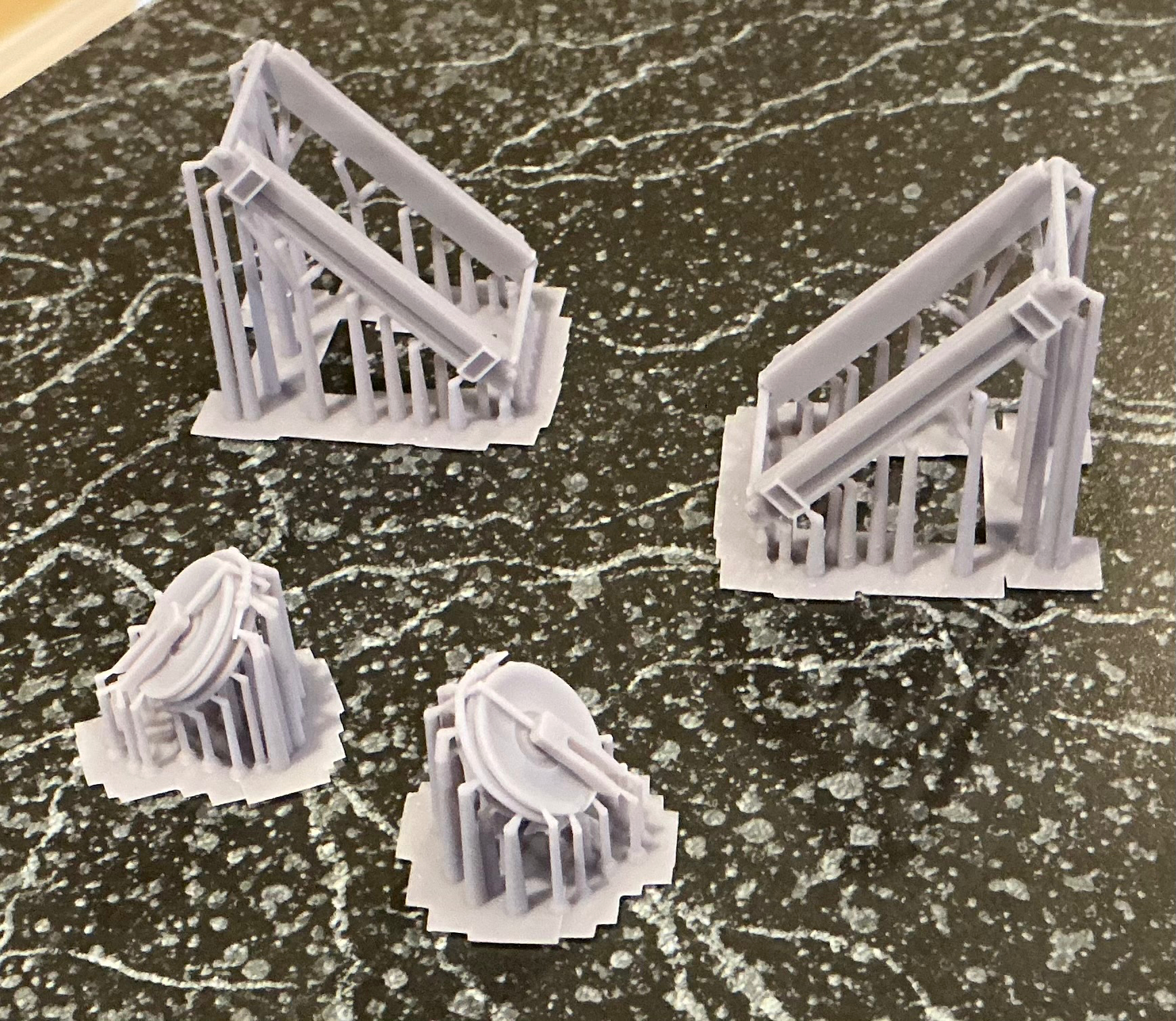

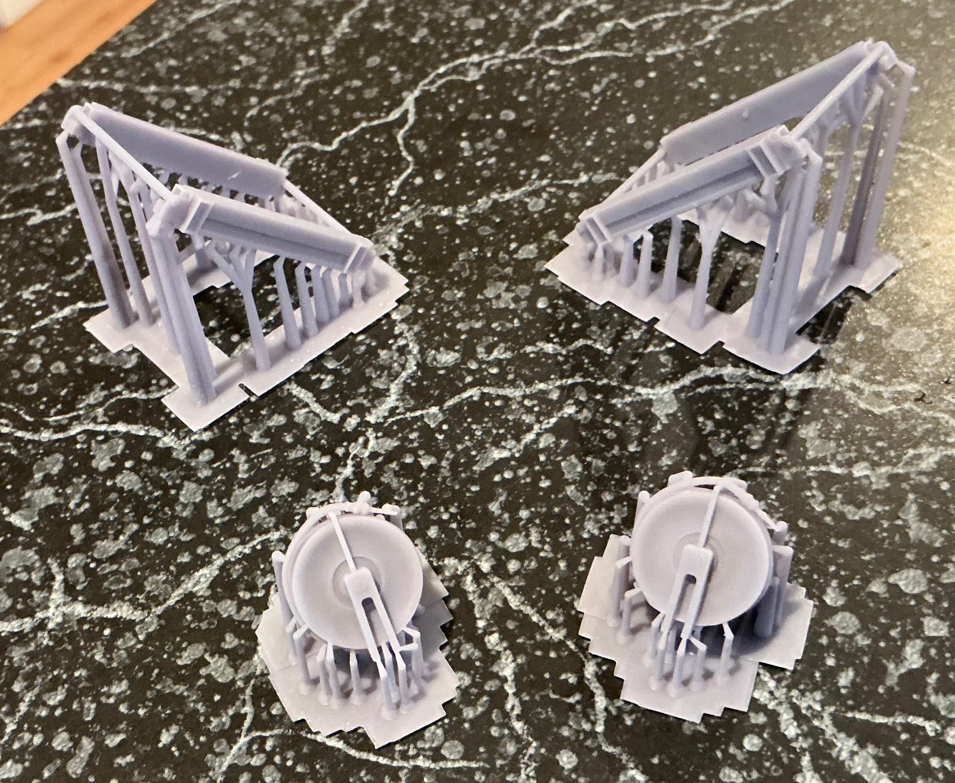

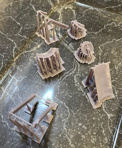

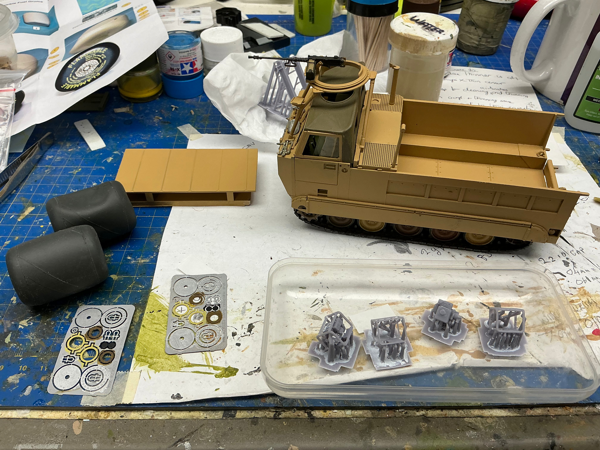

Here are the first successful 3D prints, other than the main floor, towards completing my M548 fueler.

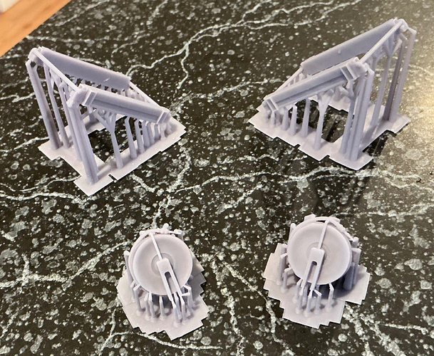

This just leaves printing the 2nd frame to support the “dished” bed that the bladders will rest in. The one at top left of the pic failed due to a lack of supports. I’m going to try and print a cage for the pump and I added a second hose reel to the printing process as I wanted the track to look a little more like the one up-post.
There’s a lot to learn in this 3D printing game, but anyway…..
Onward!

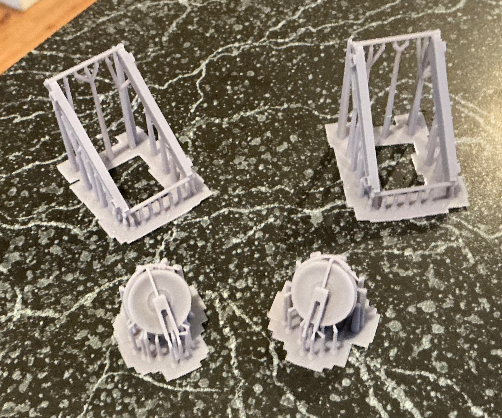

Better results today, I used the auto support feature on the chitubox advanced.
These are almost the last prints I need for this build. Just a frame for the pump to go.

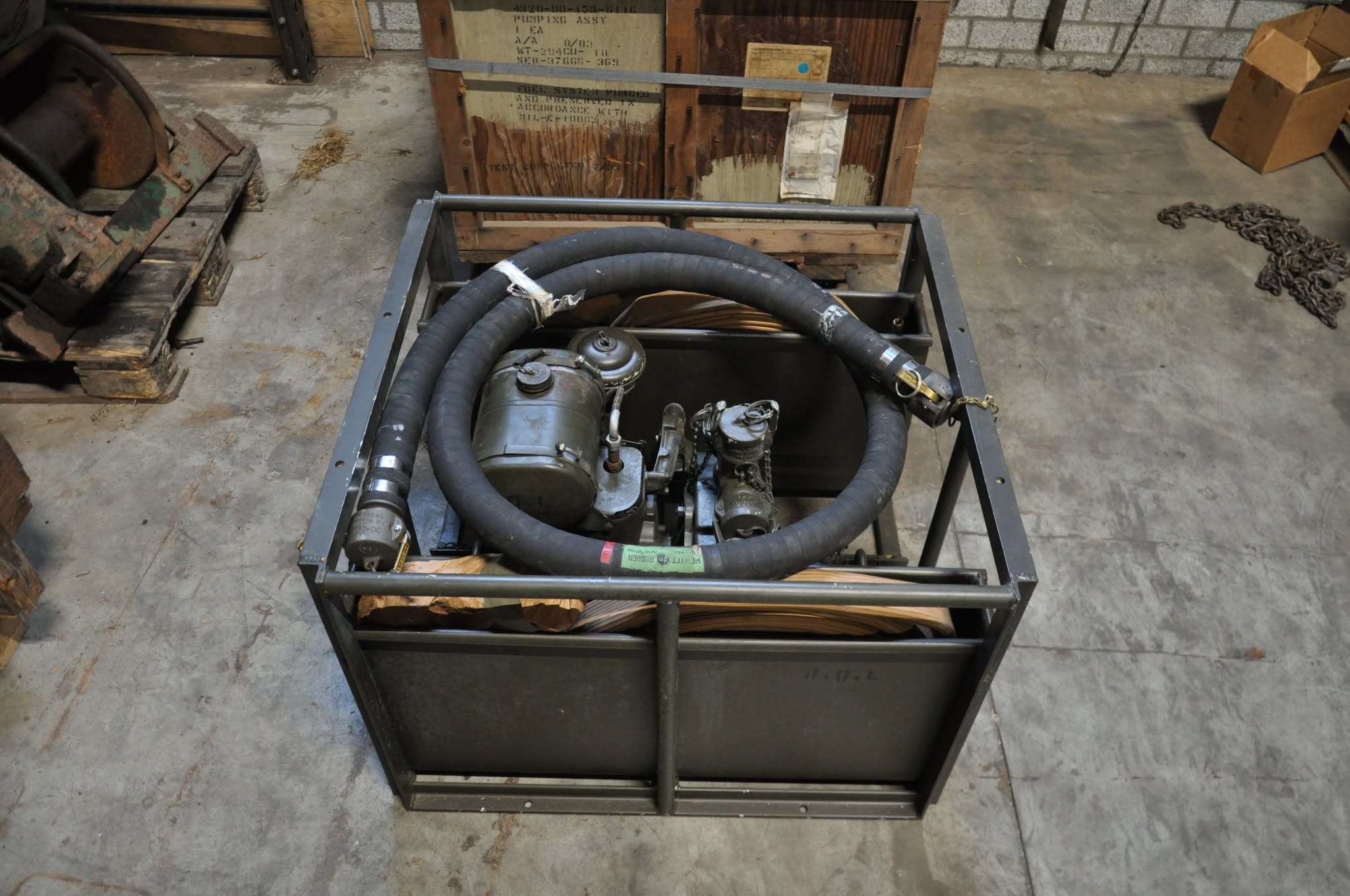

For what it’s worth, here’s a 100-GPM pump that could be used with fuel bladders…

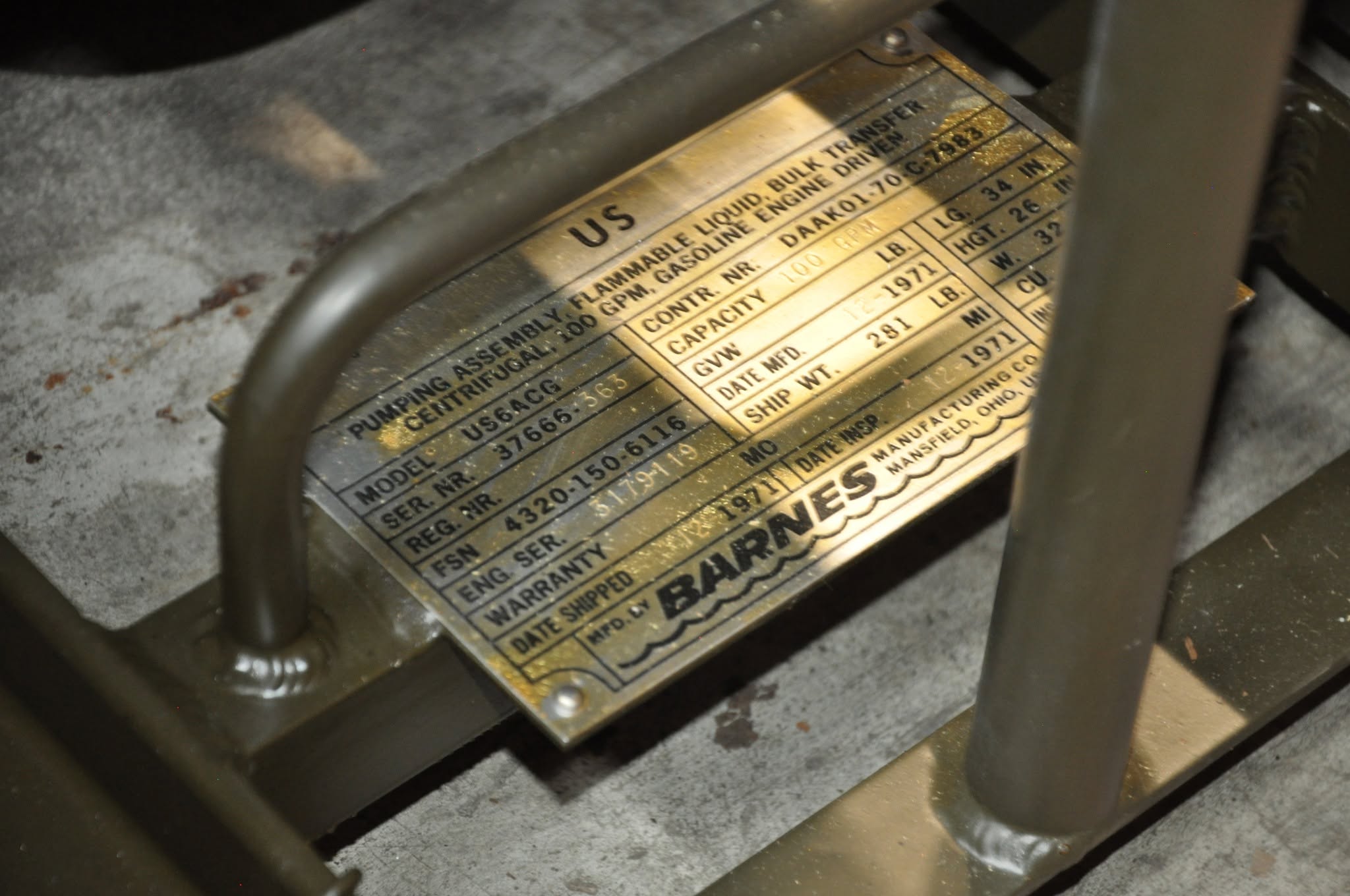

Another one (1971 Barnes Model US6ACG)
Related TMs
https://www.liberatedmanuals.com/TM-5-4320-259-12.pdf
https://www.liberatedmanuals.com/TM-5-4320-259-34P.pdf

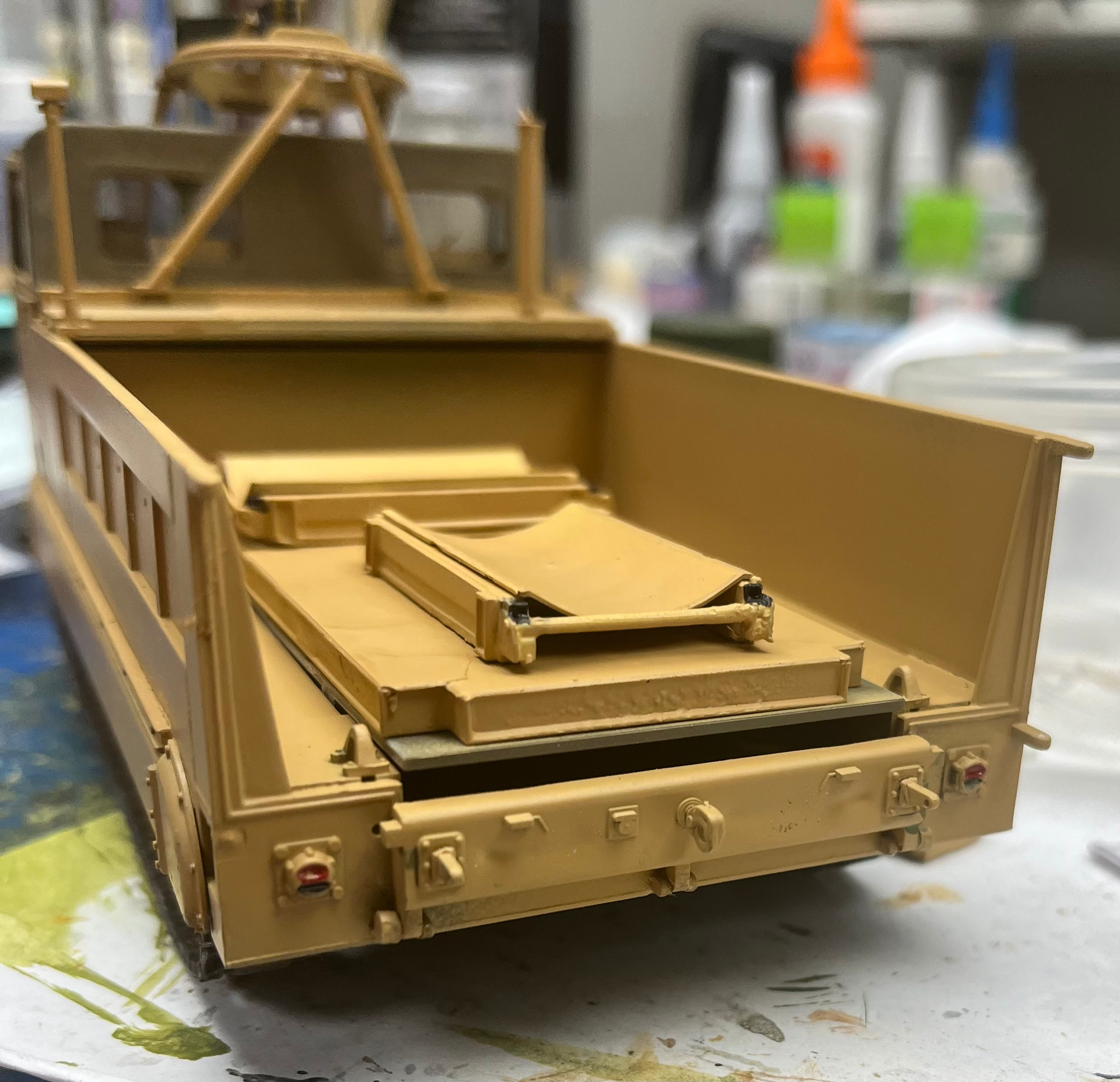

Update, the 2nd floor included in the AFV Club kit needs to go in under the pump deck. Also, both the 2nd floor and the pump deck need to be shortened to create a storage area at the very back of the floor and pump deck. That pic up post shows a fire extinguisher stored there.
The mounting platforms for the 2 bladders are a dry fit atm.

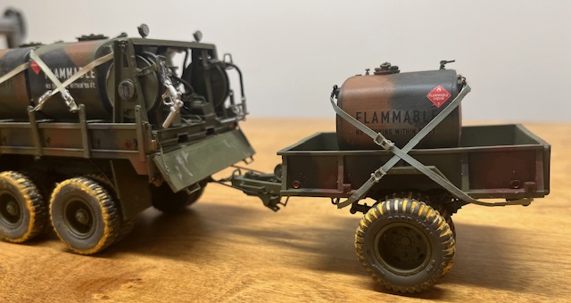

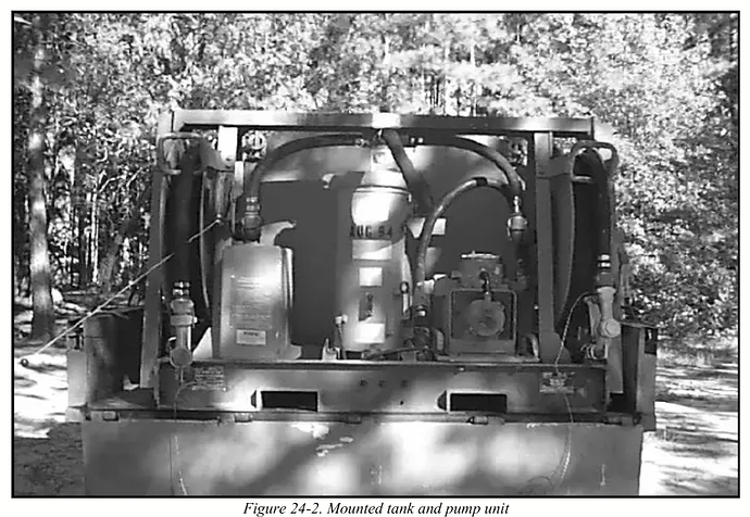

Different setup. Might be useful to someone else though.
That pump and reel deck (skid-mounted) is like the one Hobby Link sell isn’t it? I built a 5-ton with that set-up coupled to 2 600gallon s/m pods and an M105 trailer last year. There’s another set in the stash, to go on a second M548 sometime.

A little progress with the build. Prepared the MMK photo etch and stripped some detail from the bladder valve areas to allow placement of the pe. Bladders are finished in Vallejo Tire Black. The floor extension and pump deck (wrong way around in pic) are shortened to allow a storage area at the back of the wagon. The newly-printed pump is in the foreground, nice little unit from Cults, width adjusted to fit the side shelf.
More progress tomorrow.
