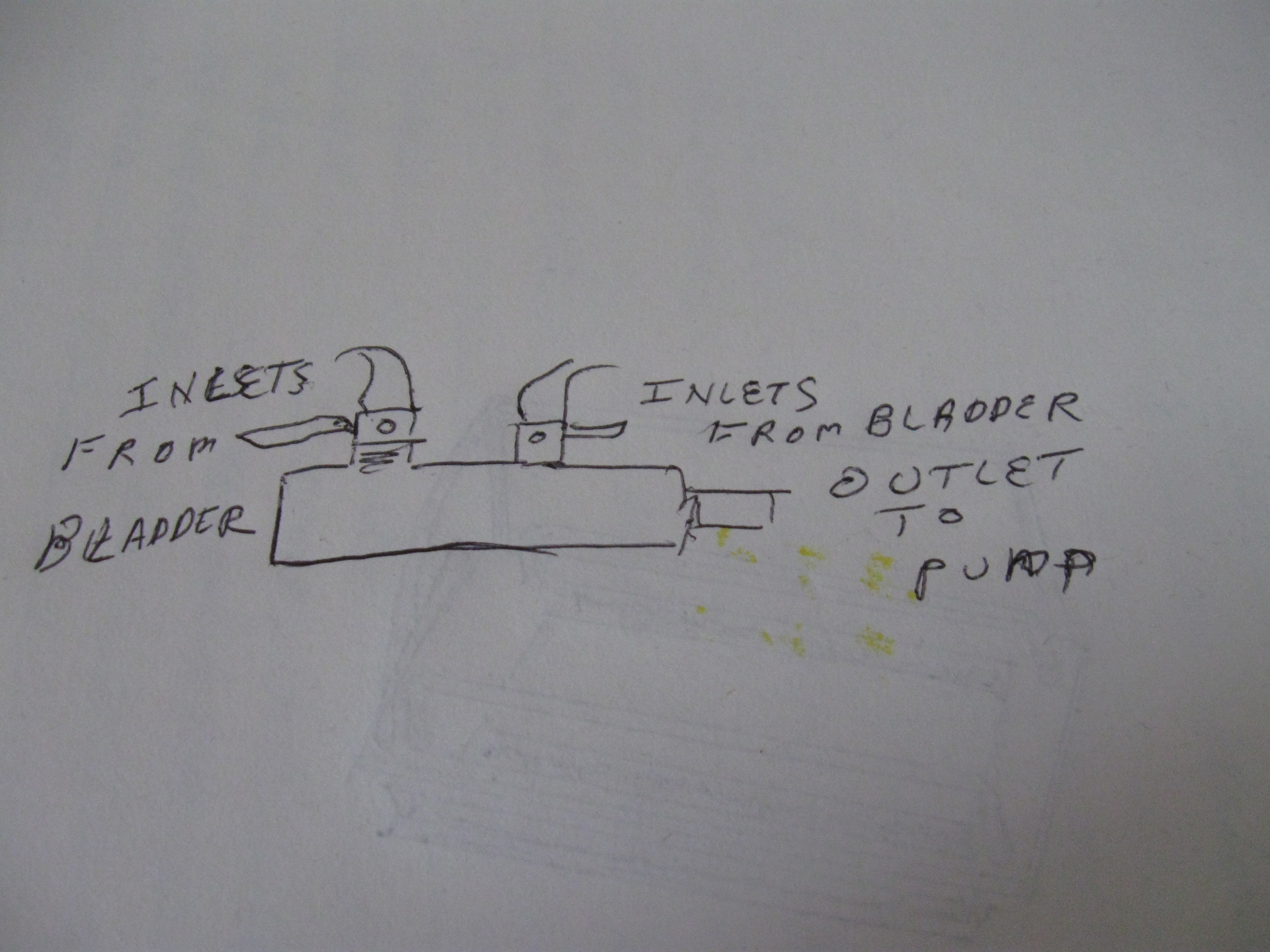

Basically a manifold is just a pipe with the inlets with valves and the outlet going to the pump. Simple to make. Simpified sketch. Wayne
Accurate - Armour had a bunch of appropriate sets for this sort of setup. I’ve been trying to find the one I bought when they went under, but no success today.
Thanks for the sketch Wayne and the efforts you’ve made too 18Bravo. I’ve been digging in the 1/25 stock car stash and found an engine manifold. It looks a pretty realistic shape having cut it in half and drilled 3 holes for the bladder hoses and an outlet. Once the 1mm hose arrives I’ll sand and paint it, then run it to the correct positions including a Y adapter from the pump to the hose reels.

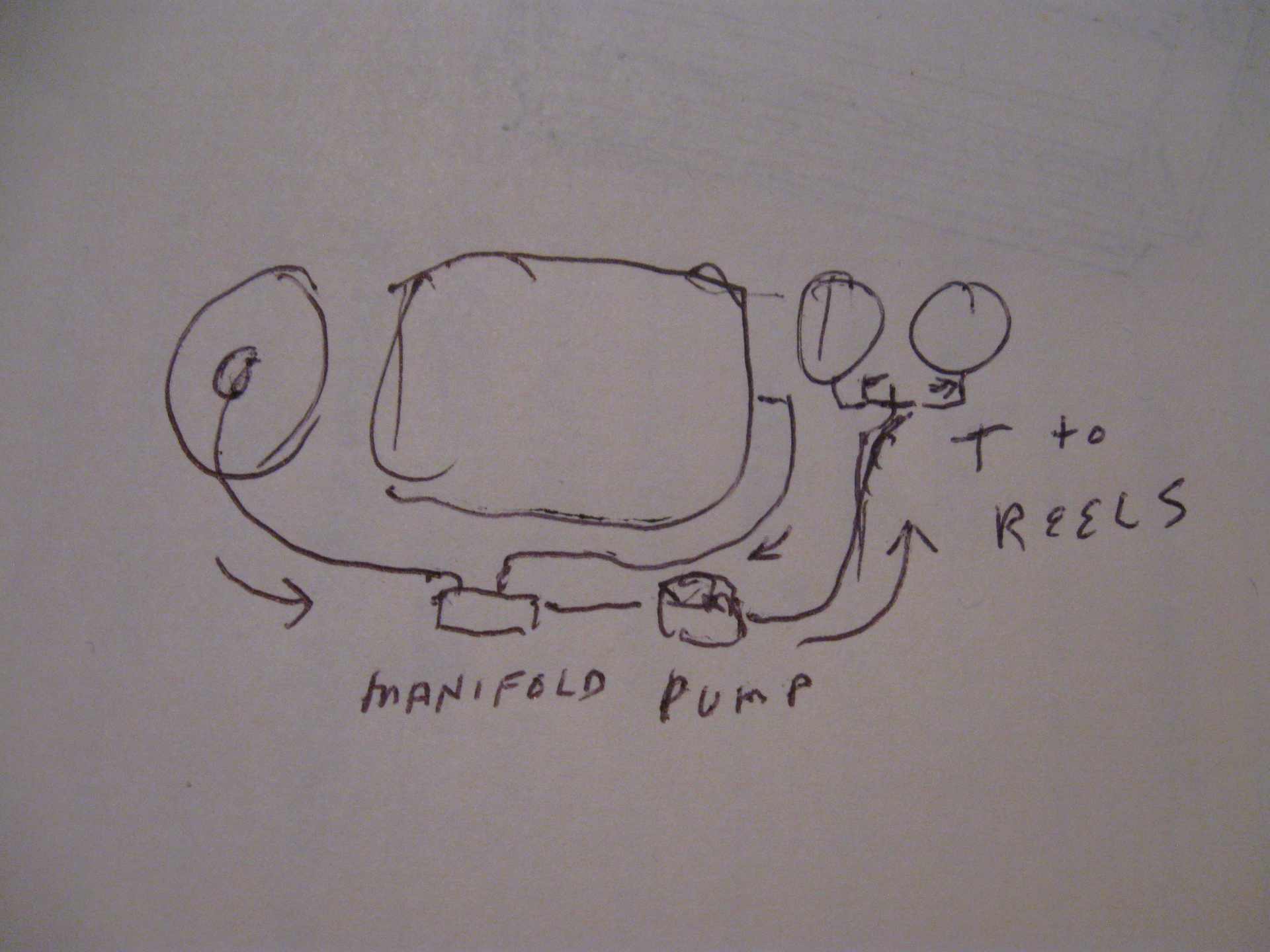

Basically like this.
Thanks Wayne, mine’s going to be that layout but with the manifold to the front of the bed, then the pump and hose reels moving towards the back.
Just remember easy access to the shutoffs on the manifold.
Thanks, good point. Looking into this (a lot) deeper, it’s evident the pump, manifold and filter housing had pretty specific locations so that throws my previous plan out the window. Pump on the roadside of the rear bed, manifold with shut offs on the other side - right next to the rearmost hose reel.

I did build a different manifold though, like the one you sketched for me. So that’s a small step forward.
Hi Gino, looked into this some more and running the two pipes to a tee would cause all kinds of turbulence in the fuel delivery process. A second pump seems a nice idea and very convenient plumbing-wise, but it has never been used in the FARS application. The answer is a manifold fed from the bladders and then one pipe to the pump which will feed a tee supplying both hose reels.

Well I’ve got my head around the pump etc layout now. The pump sits at the back of the cargo area on the drivers side with the manifold ahead of it. Hose reels sit on the opposite side. Access to all controls is easy because the operator stands on the lowered tailgate during pumping.

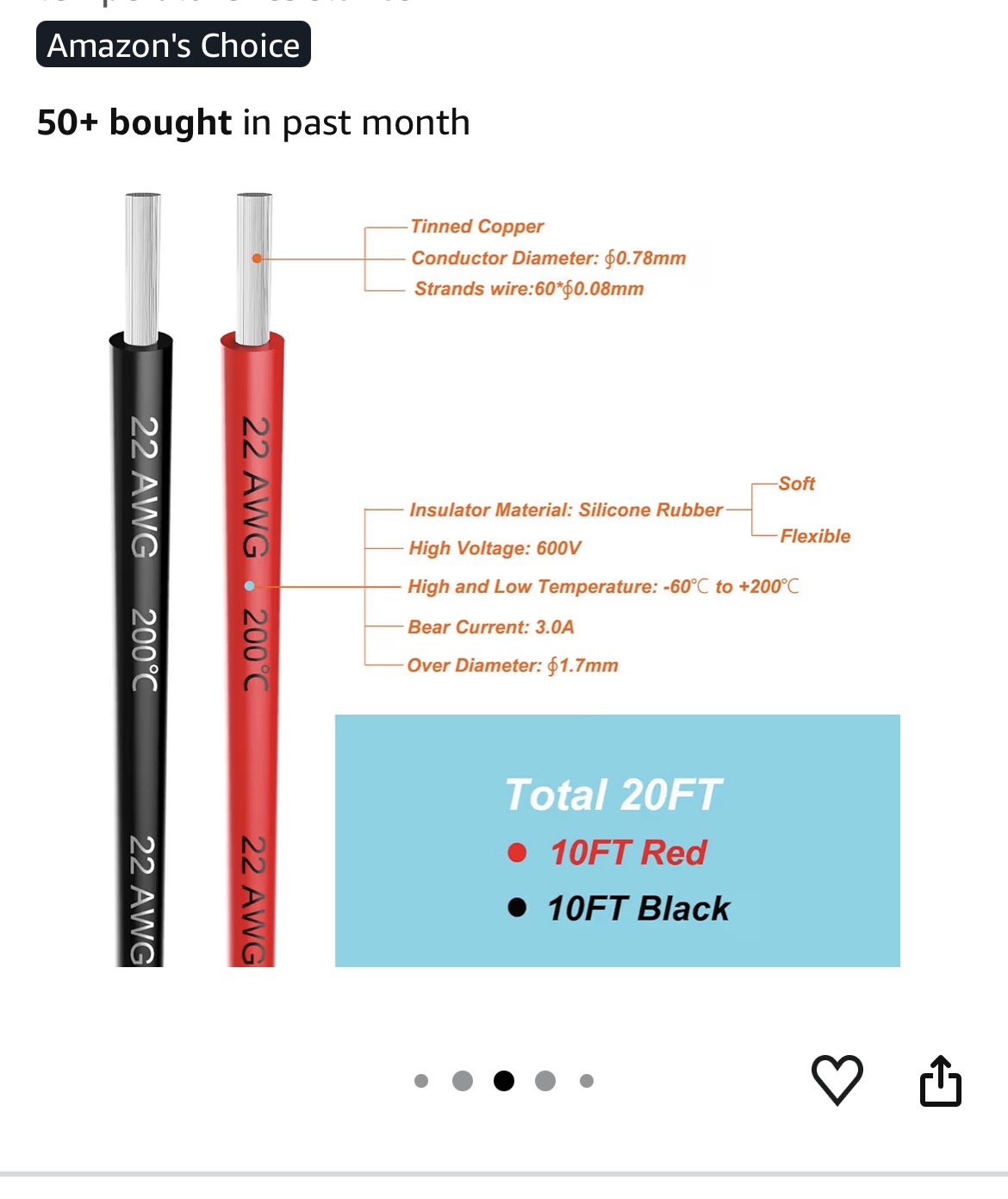

I’m sure you’ve thought of it, but different size wire with the insulation on makes good hoses. It can be bent and holds shape and comes in enough colors to use for air lines or fuel hoses. Just expose a small amount of wire on the ends and drill a hole to glue it in. Wayne
Thanks Wayne, yes I ordered this after reading about the problems associated with silicon tubing. It’s arriving today.
I went ahead and scoured and painted some tubing anyway and I’ll try it today, figuring I could touch up any areas that flake off as they claim. If it doesn’t work out I’ll “go to the wire” tomorrow (Amuzin usually delivers pm around here).

ETA Wire arrived just now, so I’ll be looking at it today.
I always saved/ scrounged wire from old electrical cords or whatever. When I did roadwork we often dug up old phone or cable wire. I still have bunches of it. And old phone and power cords. Wayne
