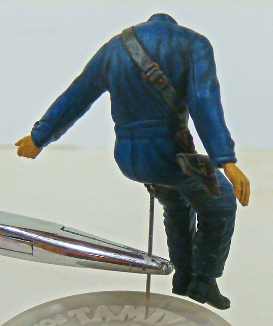

The black leather items on this Italian tanker were painted using this method (oils over acrylic undercoat).

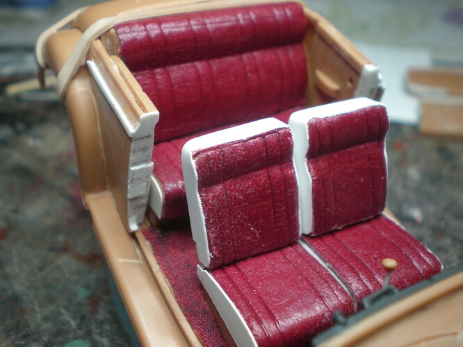

Actual leather? I had the same problem as you for the Heydrich limo in Operation Anthropoid until my wife donated an old purse. I won’t photo-bomb with the process here (it took some work) but this was the result…
If others’ suggestions don’t do the job maybe try bits of thinnish old leather if you have any lying around & the colour’s right. It might be age-able with sandpaper.
