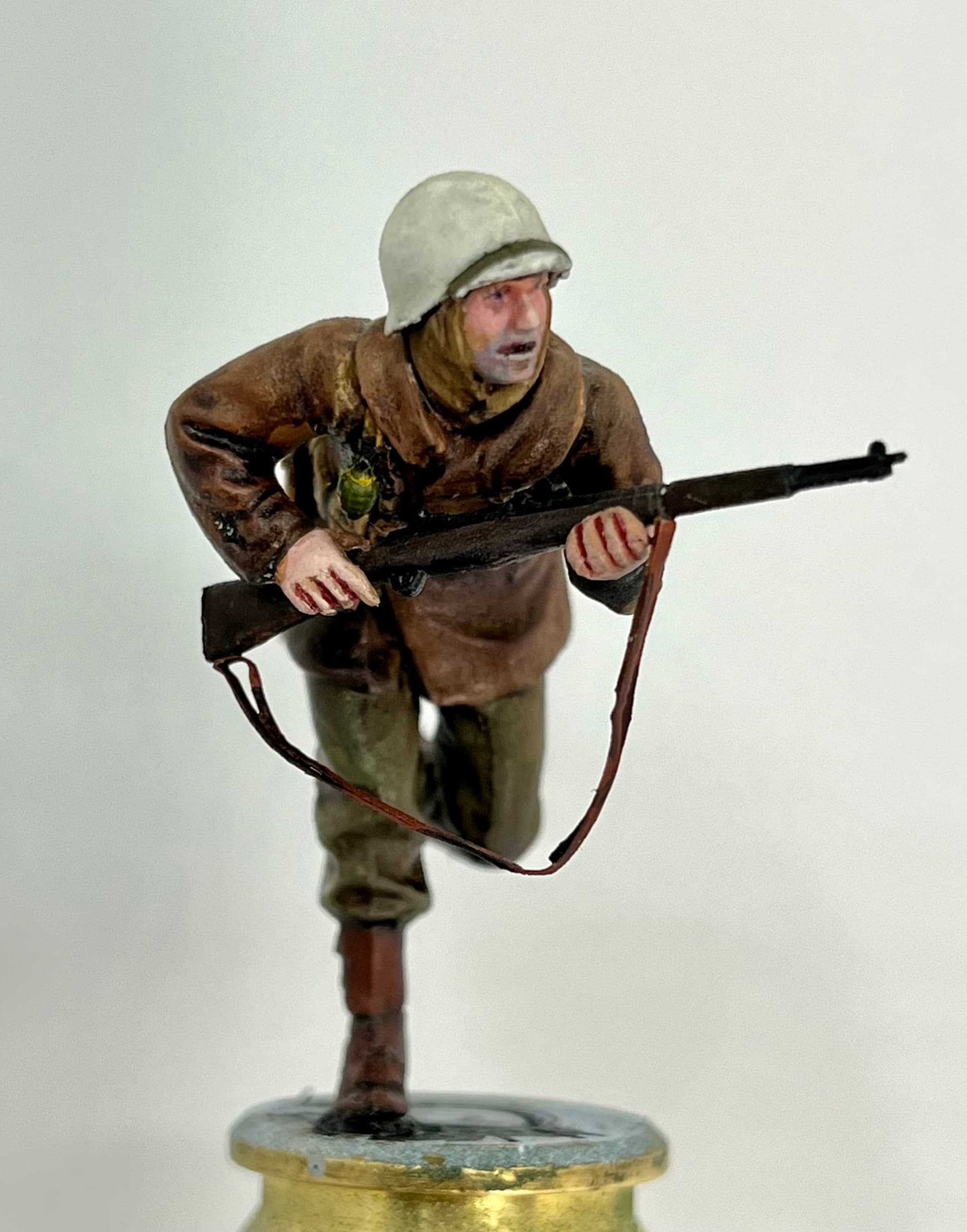

Not usually. Slings are easy to make out of lead foil though. Slice it into a thin trips, cut a bit longer than the length of the rifle, paint, then glue them in place.
I use this method all the time. The below slings were done using this method.

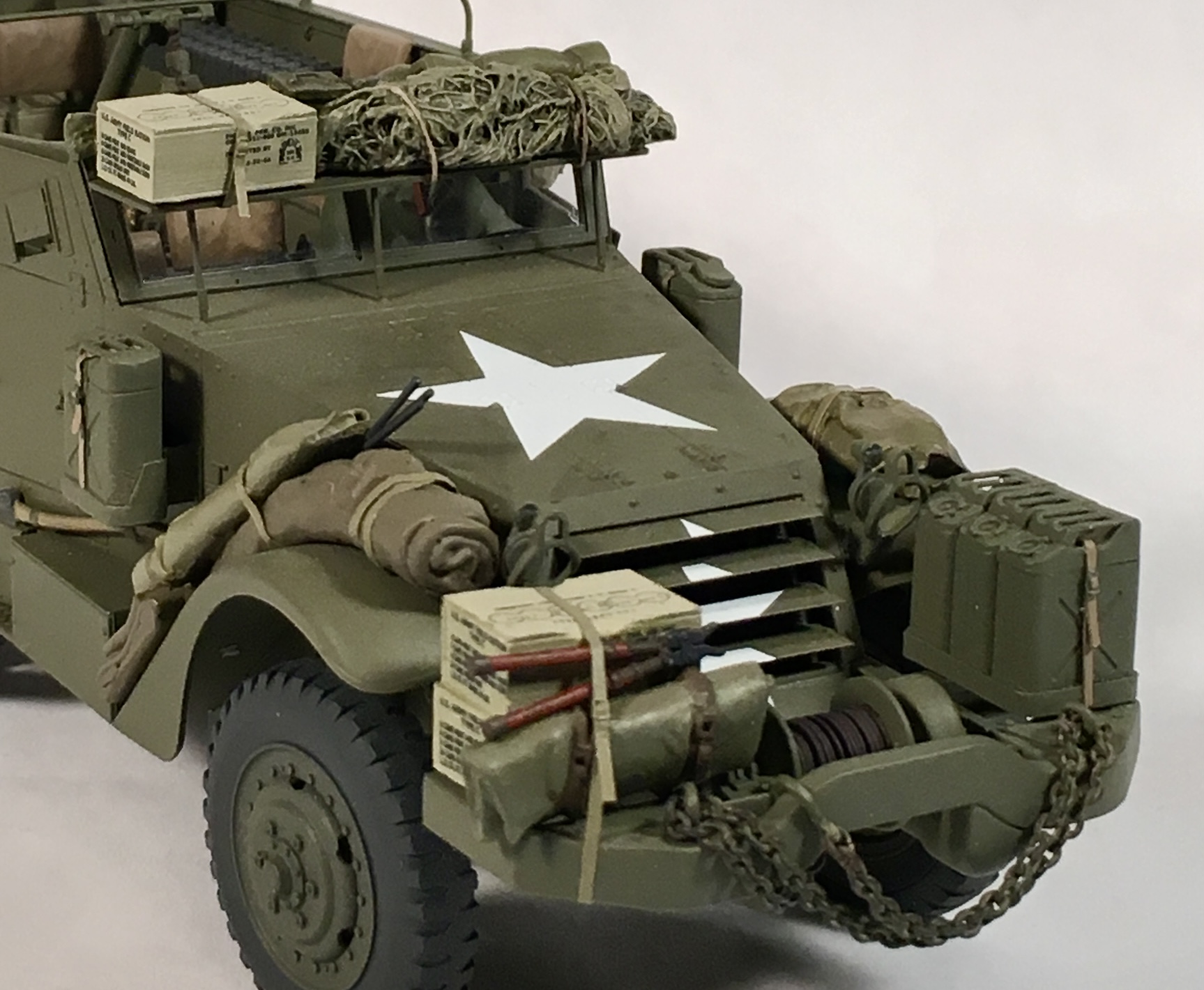

Personally, I like Tamiya Masking Tape.
• Mash it on the workbench to thin it down.
• Lift up a couple of times to slightly de-tack.
• Lightly sand the top with fine grit to take the shine off.
• Slice the end at a 30° angle for easier threading through tiny PE buckles.
• Paint as needed.
Same method for tie-downs.

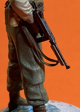

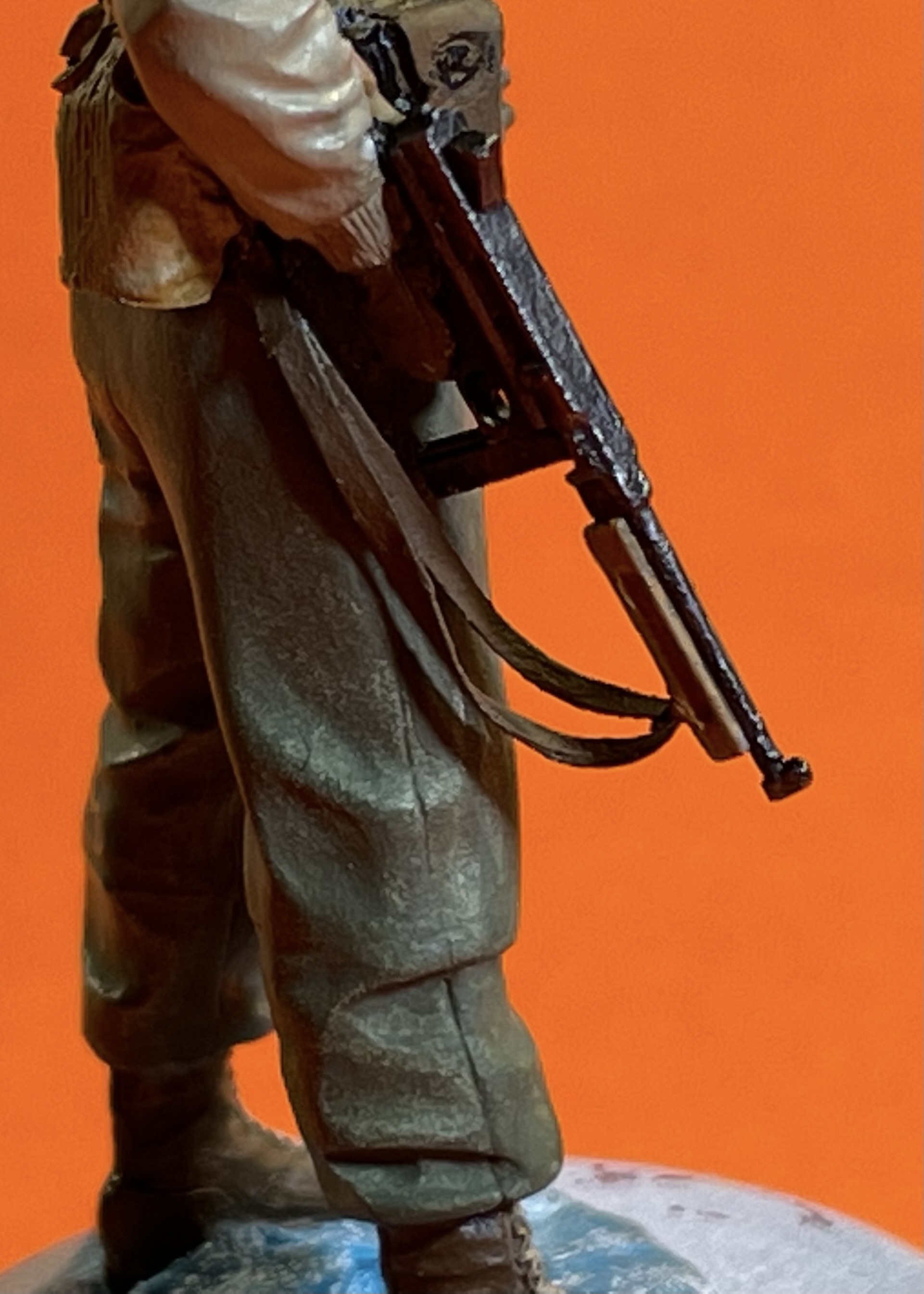

I just use pinstripe tape, the ones found for automotive detailing. They come in assorted widths that Amazon isn’t displaying here. Your local auto repair supply shop sells them.
I superglue the tape onto the rifle or carbine and then paint both sides black because the black tape has a glossy sheen. The stickiness of the tape helps to secure it when you glue it on.
