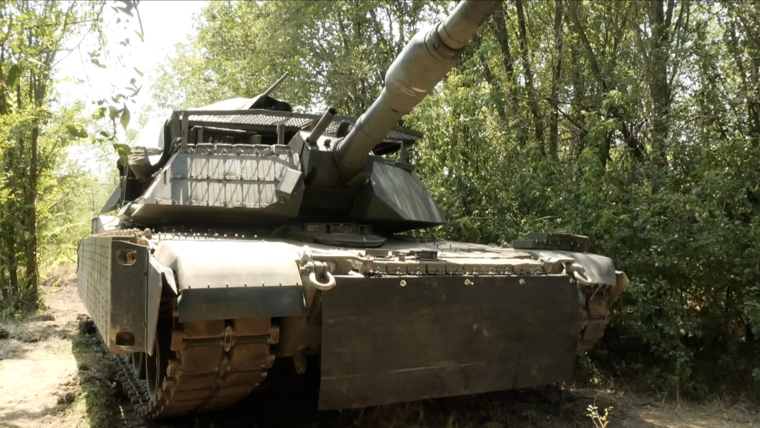

over the years iv seen pics of rubber sheets and panels on AFV and Armor from the M36 and T34-85 from the Bosnian conflict in the 90s to the rubber panels on Ukrainian M1A1 and leopard 2A4
so what do modelers use for those rubber panels on thier kits?

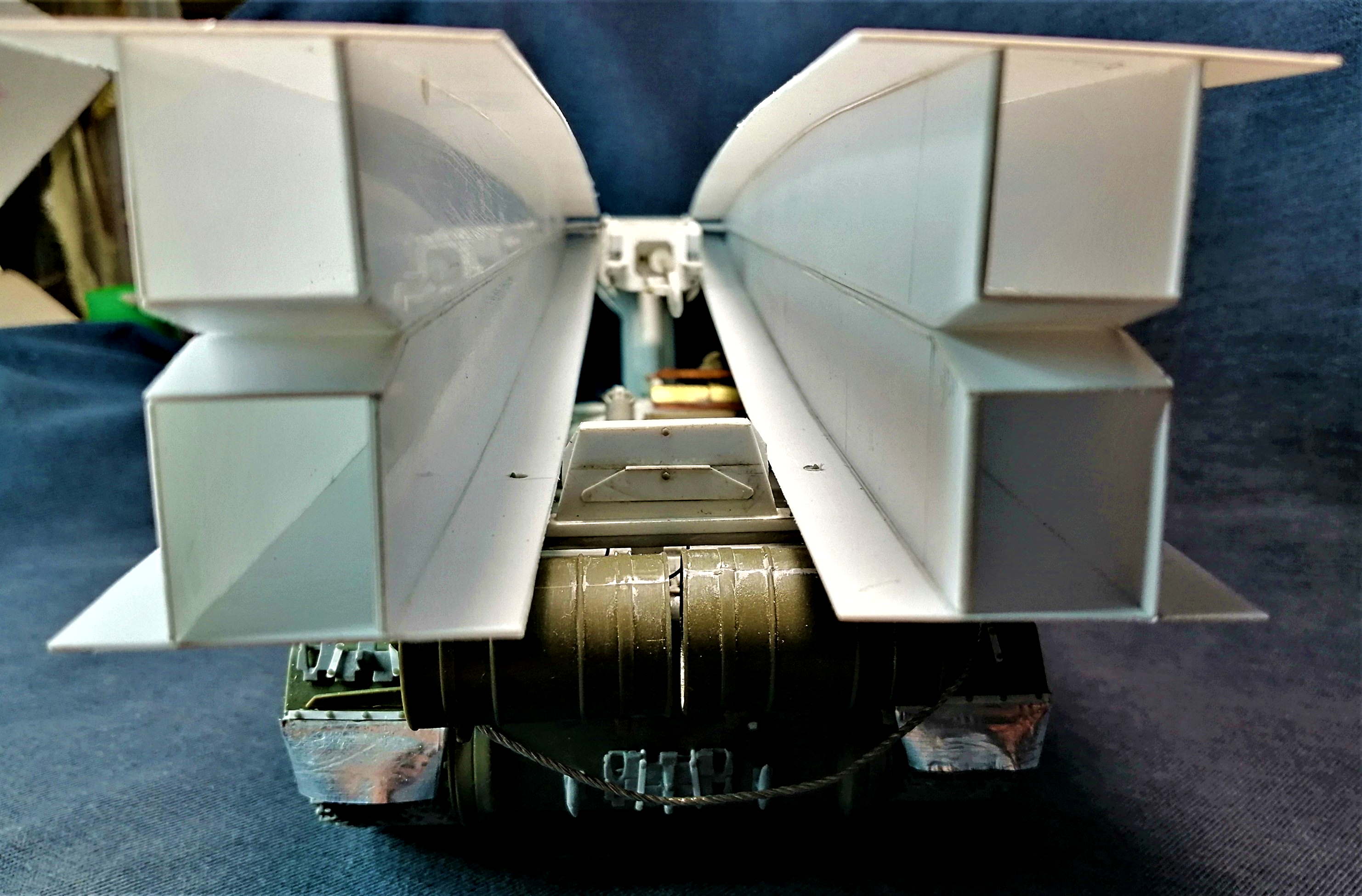

Don’t know whether it will be convincing, but herewith 2 pictures of an old build of mine(BLG-60M-2 AVLB), where I used lead foil to represent mudguards:
In progress
Finished
