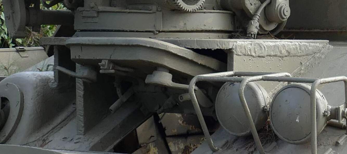

Looking good. It is amazing this thing worked without tearing itself apart. That is a really small attachment point between the gun and the hull. I would have thought it would be much more stout.
yes - it is probably ~ 35" on the real thing…

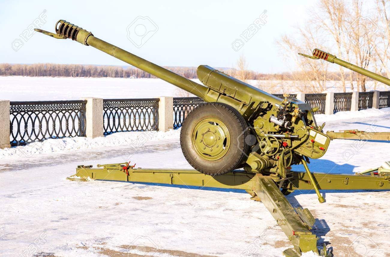

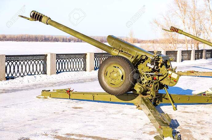

The gun/mount is very well designed actually. Half the recoil is absorbed due to the muzzle brake design and the recoil mechanism on top of the barrel helps even more to produce a well stabilised/sturdy gun mount.
The gun uses a typical three legged mount so I guess the Syrians fired the gun when aligned with the longitudal axis of the vehicle. The gun has also been used placed on trucks.

I am talking about the flimsy-looking plate that it is mounted onto the hull with. It looks like the recoil would rip the gun off that flimsy plate. I guess it worked though.
Flimsy?
The sheet metal in a Volvo is flimsier :wink:
Maybe the kit part is slightly too thin?
Maybe that is it. The actual metal looks much more robust.
