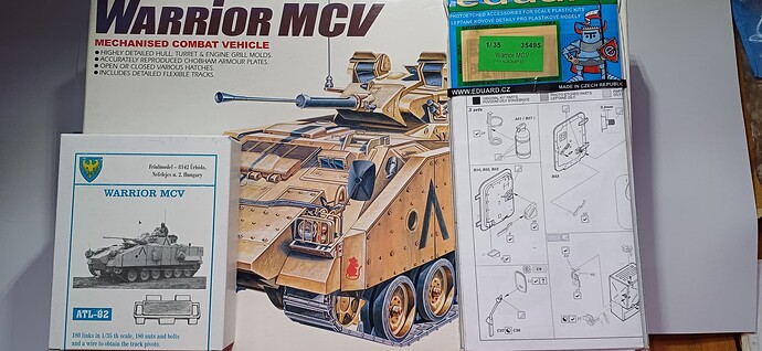

Going to try and start a new build this side of Christmas. I’m undecided as to whether I should go for a fairly straight forward build with the Scimitar 2 or the Warrior with add on’s. The Scimitar 2 will be out of box and although it has etch it’s not too in depth though some scratch will need to be done as no kit is 100%. This might give me a break from a very busy Ferret build. The Warrior will have Friul Tracks and Eduard etch, no applique armour as my plan will be for it to be a Batus wagon with SAAB Direct Fire Weapons Effect Simulator kit fitted. That will be a big undertaking however as apart from the Laser projector above the barrel it will all need to be scratched. Thoughts anyone?
The Warrior is a fun build. Fit is good and assembly pretty trouble free. I put Friul tracks, a barrel, and PE on mine.
It does look good but from reading another thread on here it has it’s shortcomings which I will address. I have the AFV Club Scimitar metal barrel and barrel trough to fit to it also as I fitted a Scorpion Miniature Models Scimitar upgrade kit when I built my UN Scimitar.

I could just do myself a favour and punch myself in the face, same result. The stress would probably kill me. Johnny the Eduard etch has the Laser projector in it but nothing else. I have the old style retro reflectors from the Husky TSV kit which I might use after a bit of reshaping. There are close up pics of the various pieces on Prime Portal but they won’t open into the larger pics, well not for me anyway.
