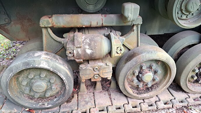

Zero knowledge on Sherman’s, guessing it’s a HVSS, maybe Korean War era. Wanted to share as the Sherman clearly wanted its picture taken.

Indiana has lots of M4A1s.

The M4A1E8, aka M4A1 76mm HVSS. It could be one of the ones that rolled off the production line too late to see combat, or a postwar rebuild where the muzzle brake and HVSS suspension were added. Interesting that it has the early T66 single pin tracks. It is indeed in pretty good condition aside from the paint.

No M4A1s were modified to add HVSS. All M4A1(76) HVSS tanks were built with muzzle brakes.

It looks to be an M4A1(76)W w/HVSS. To my knowledge, there is no kit of this.
The above would do with HVSS added. The IDF M51 Sherman is also close but would need a backdated turret and gun. The IDF M50 would be close as well but would also need a backdated turret/gun added.
