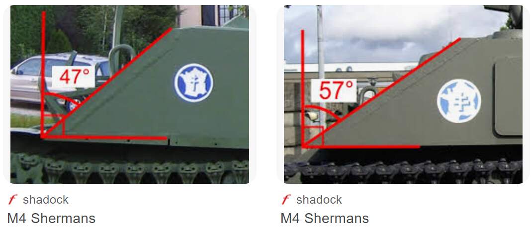

To further complement to what @Tank_1812 Ryan wrote:
- Seems to require that added side armour (present in all three kits, no issues)
- PE-plate designed for a specific …
- angle of the glacis (the two Dragon kits).
The Zvezda Sherman has the steeper glacis where the driver and co-driver hatches do not protrude into the glacis
Oops - totally blew by me - my bad. Sorry. Ryan is right, again.
That glacis angle gets me from time to time as well
