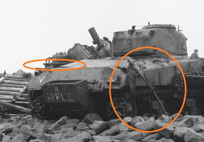

For the Dragon kit you will need to add a first aid kit, and maybe British Fire Extinguishers, on the rear hull, as per standard British fit out:
Also, I don’t think the conversion kit has any of the station keeping equipment (the discs on poles) that you need to add too:
The relocation of the stowage box from the hull side to the turret rear is also a consideration.
i might have a spare first aid box, not sure about the fire extinguishers i will need to look.
the station poles/disks on poles i don’t have so i will need to scratchbuild them.
There is a fitting on the hull that the vertical pole part below the disc slides into to hold it when it is folded flat. The horizontal arm also folds up so it is parallel to the shorter pole.
