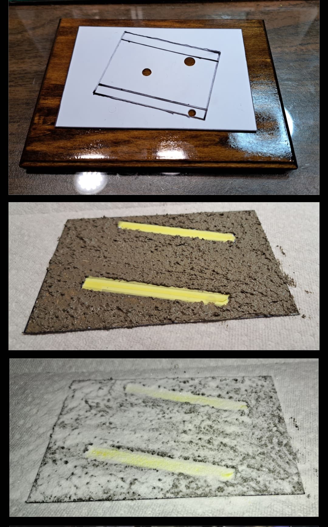

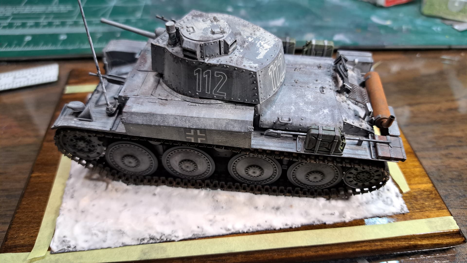

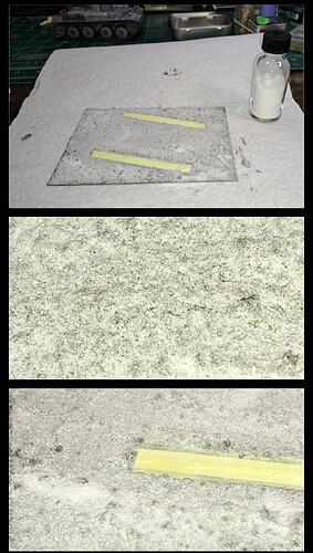

While the previous one is drying decided to experiment on groundwork for the Pz 38t. I’d noticed the yellow sand applied to the wet Mig Mud was full of sparkling grit. Checked and the white sand also from Hobby Lobby was also full of shiney grit.
Picked a small base from last summer’s stock pile for the model. Took scrap plastic card, outlined the Pz 38t’s ground contact, and taped off the footprint. Applied Mig mud again and sprinkled with white sand.
Curious to see what it looks like after drying.

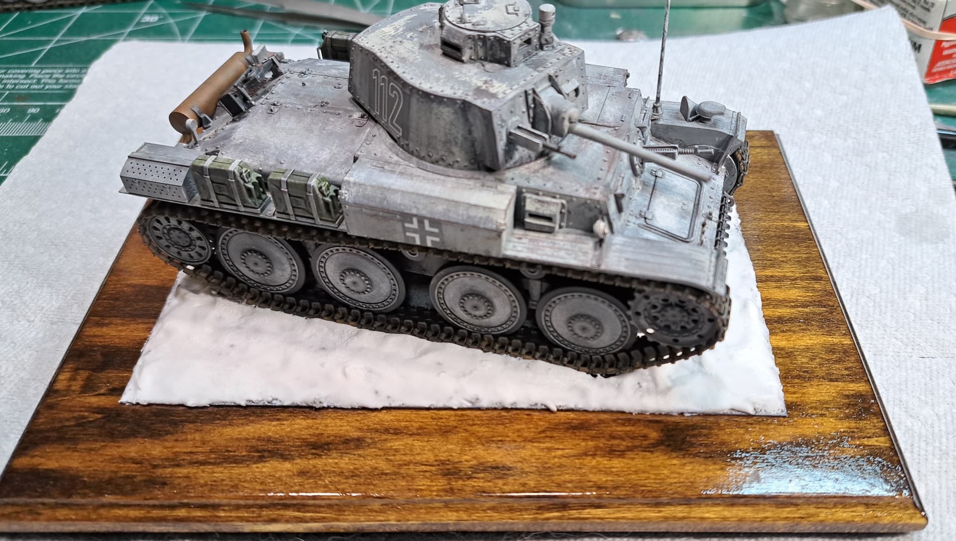

Phase 2 of the plastic card experiment:
  1. Applied Snow Microballons, except area directly underneath vehicle.
Sidebar - Wearing a quality respirator with these microballons is in my opinion very reasonable. They are like fine dust and no on wants to inhale this sort of stuff.

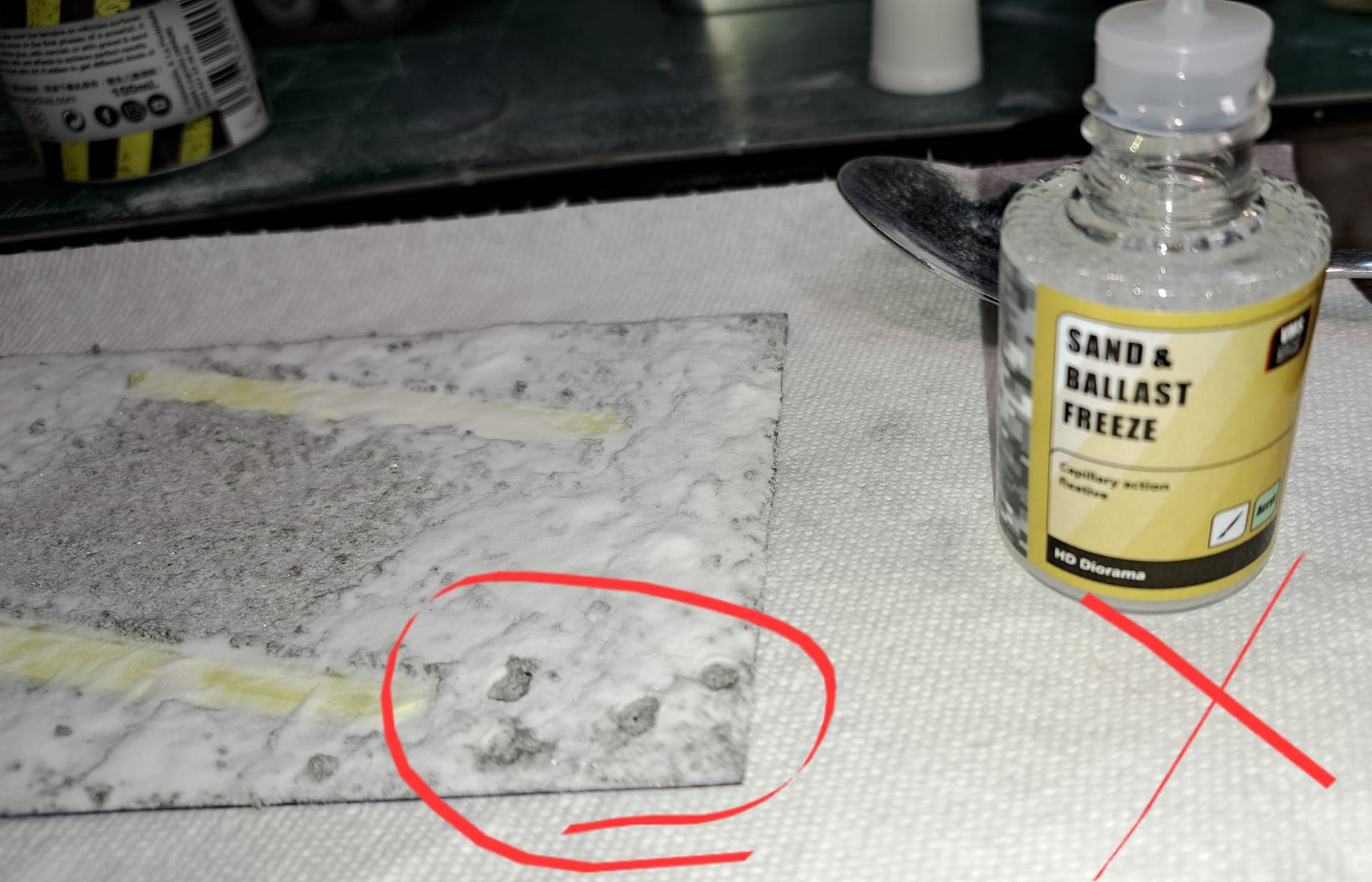

  1. I liked the microballons and tried ballast freeze which was a mistake :sweat_smile:
Will probably patch thst with white sand and see if a clear coat will freeze everything in place.

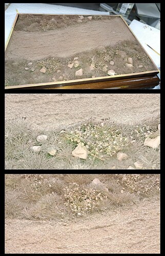

Phase 2 - Wooden Base

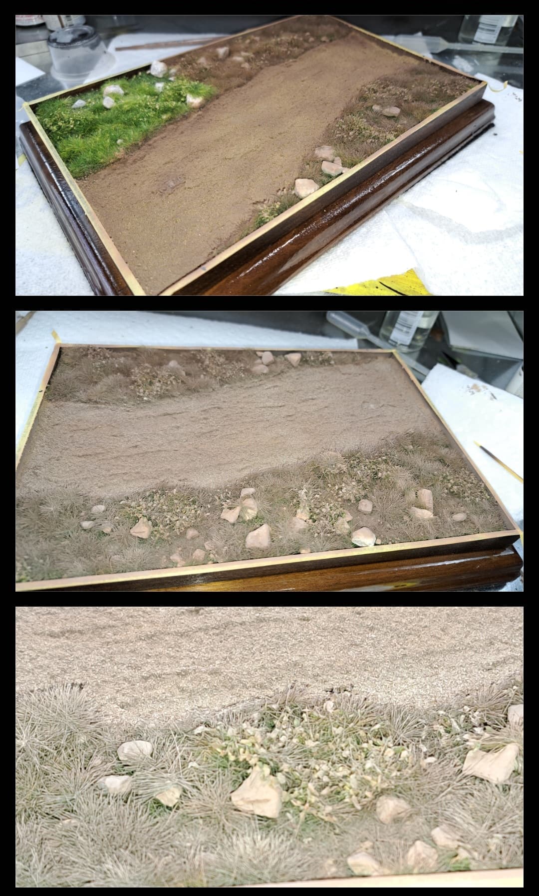

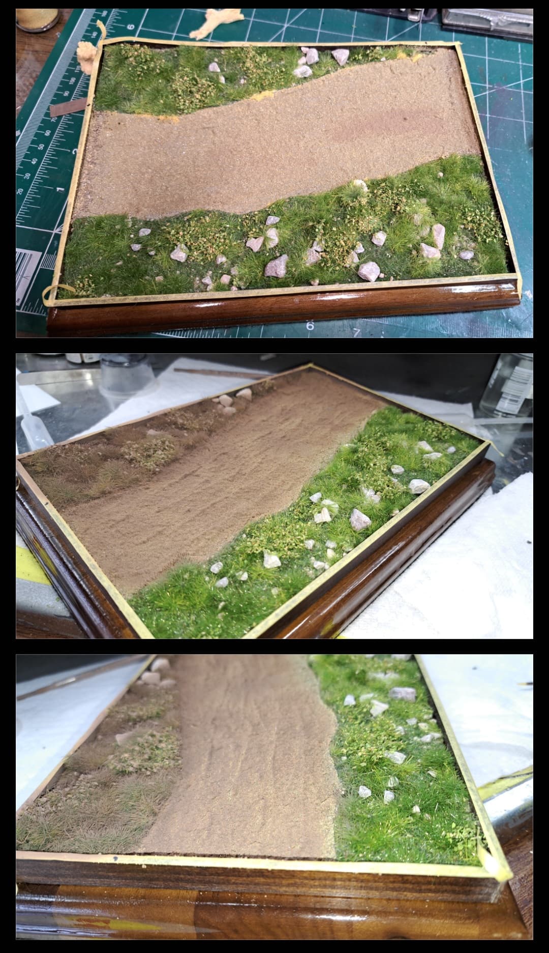

First overspray, with Tamiya Flat Earth (1 part paint with 2 parts thinner) for slow build up of intensity.
In pictures below, finished covering in Tamiya Tamiya Flat.
High highlights done with Tamiya Buff (1 part to 3 parts X20A thinner)
Results…

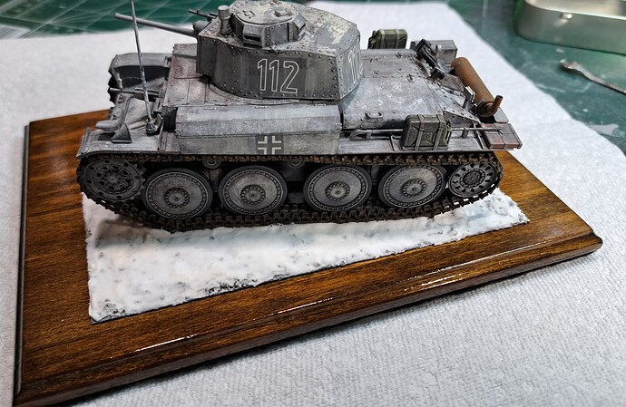

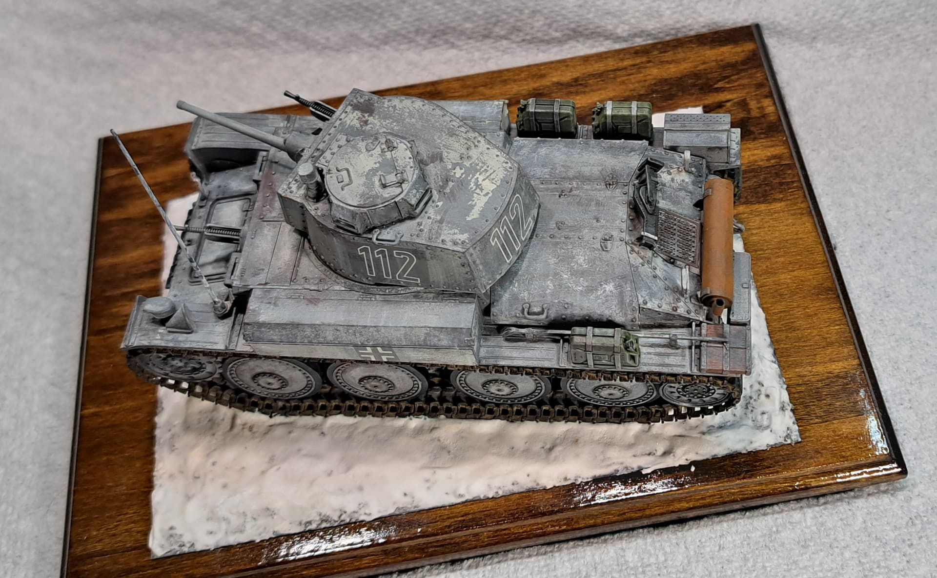

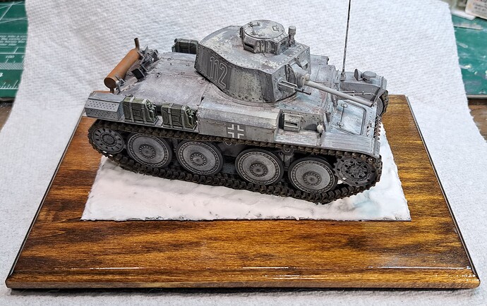

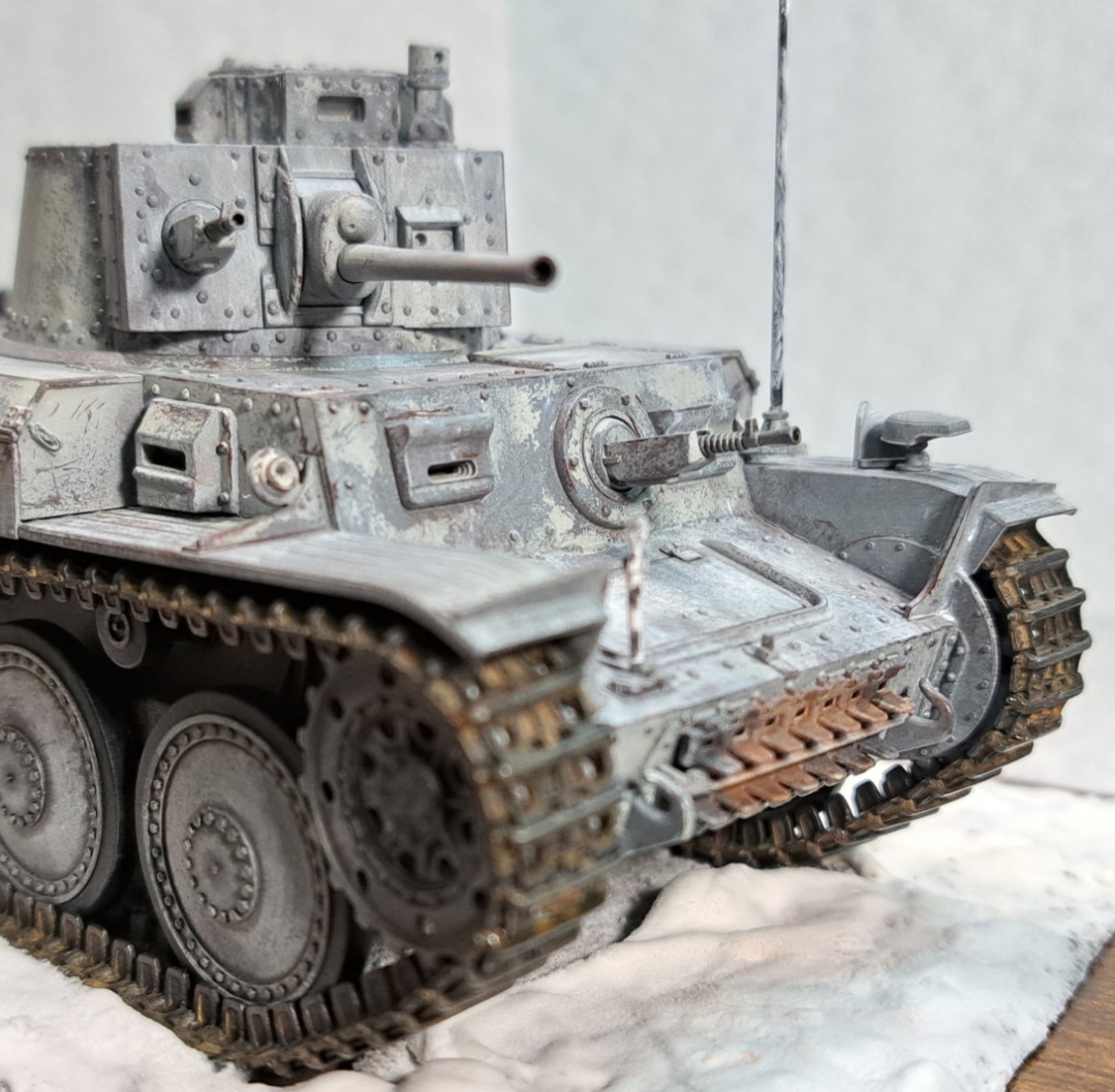

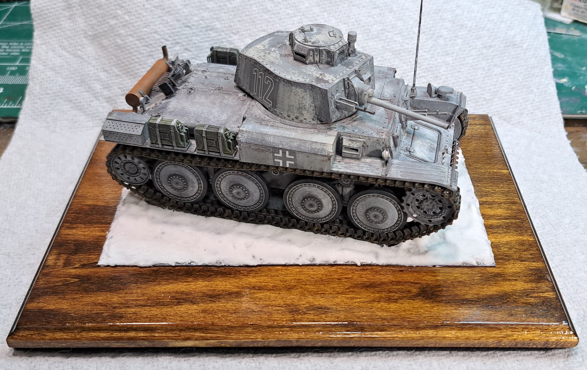

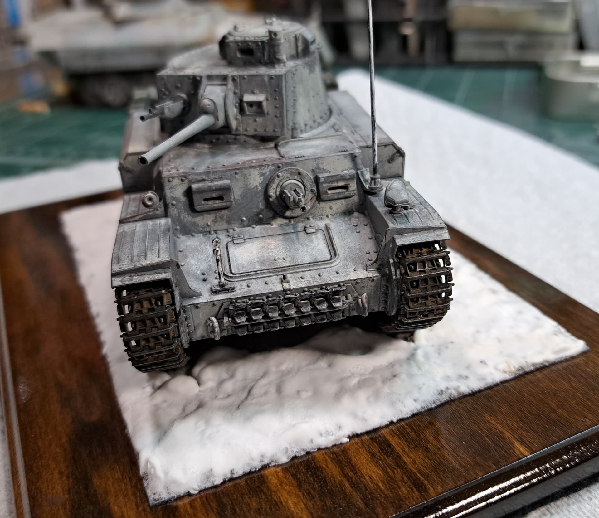

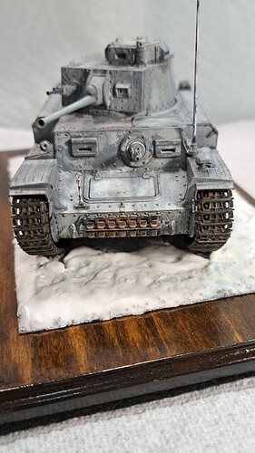

The Pz 38t got flat coated today.

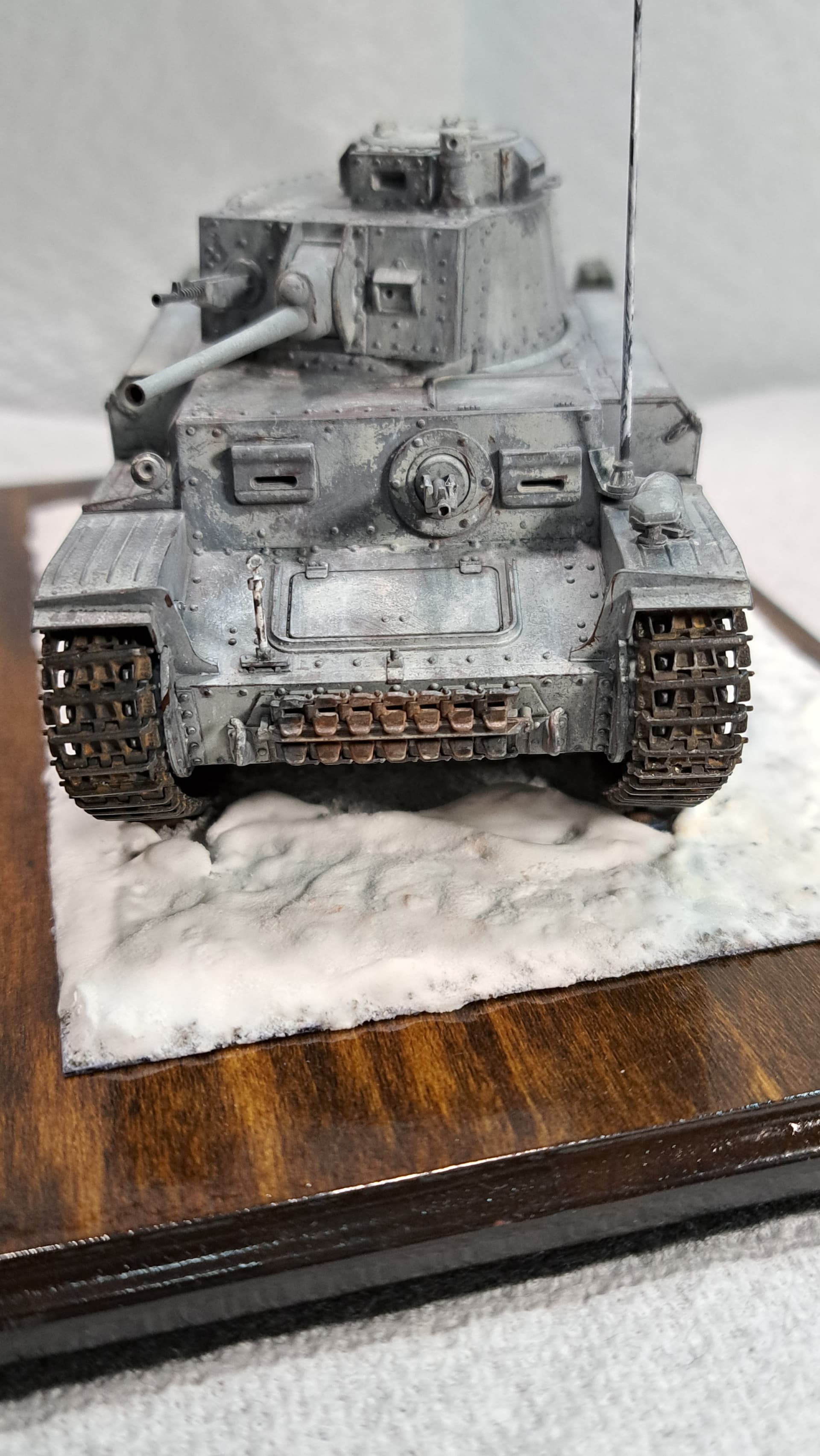

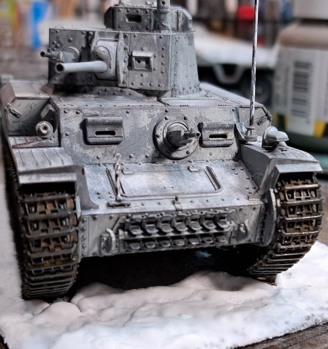

Lot of learning the hard way with AK Acrylic Snow & AK Snow Microballons.
Placed the Pz 38t on the card, then applied AK Acrylic Snow and AK Microballons. For me the AK Acrylic Snow proved a very difficult product to work with as it sticks to everything. A little water on the brush helped.
Test fit to base, as additional tweaks are likely.
Man for a first attempt you’re bang on the mark - that looks great Wade!
Matt, thank you! That means a great deal as applying the snow was the most stressful hobby task Ive done in a long time.

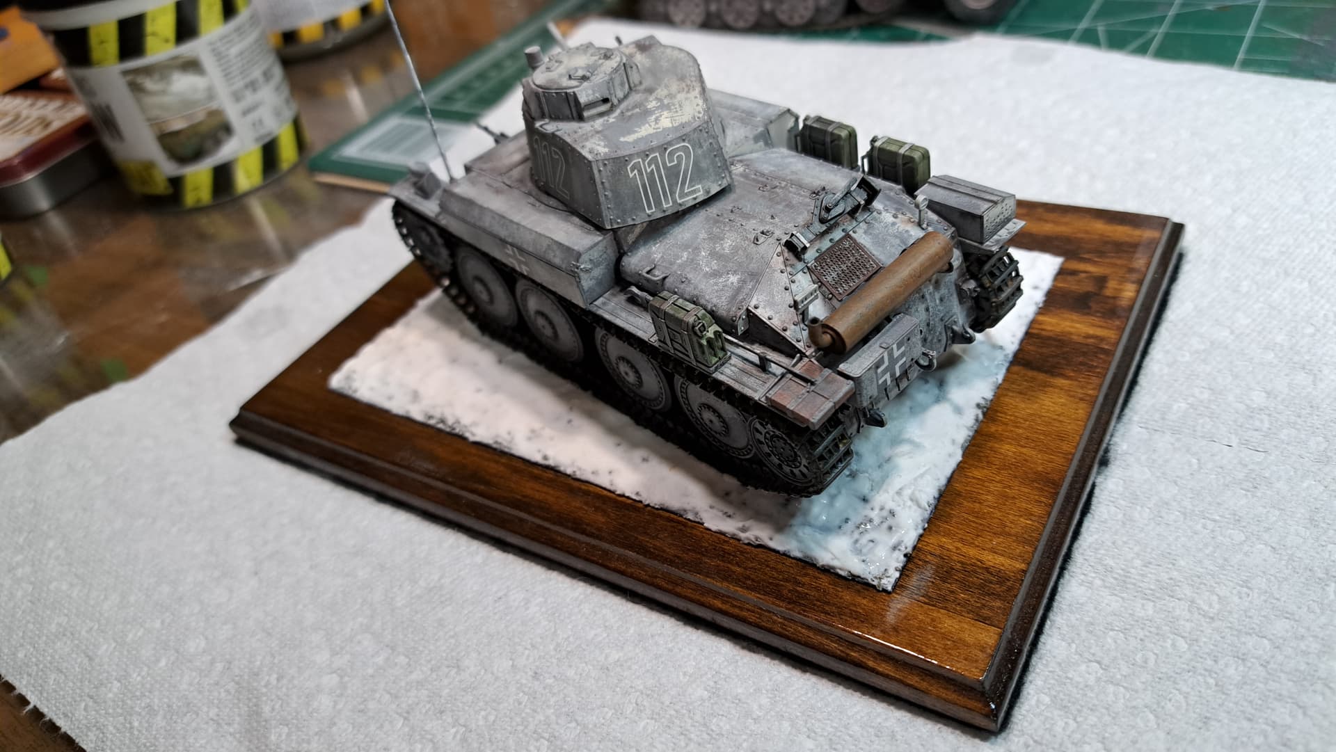

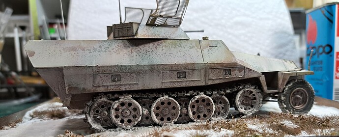

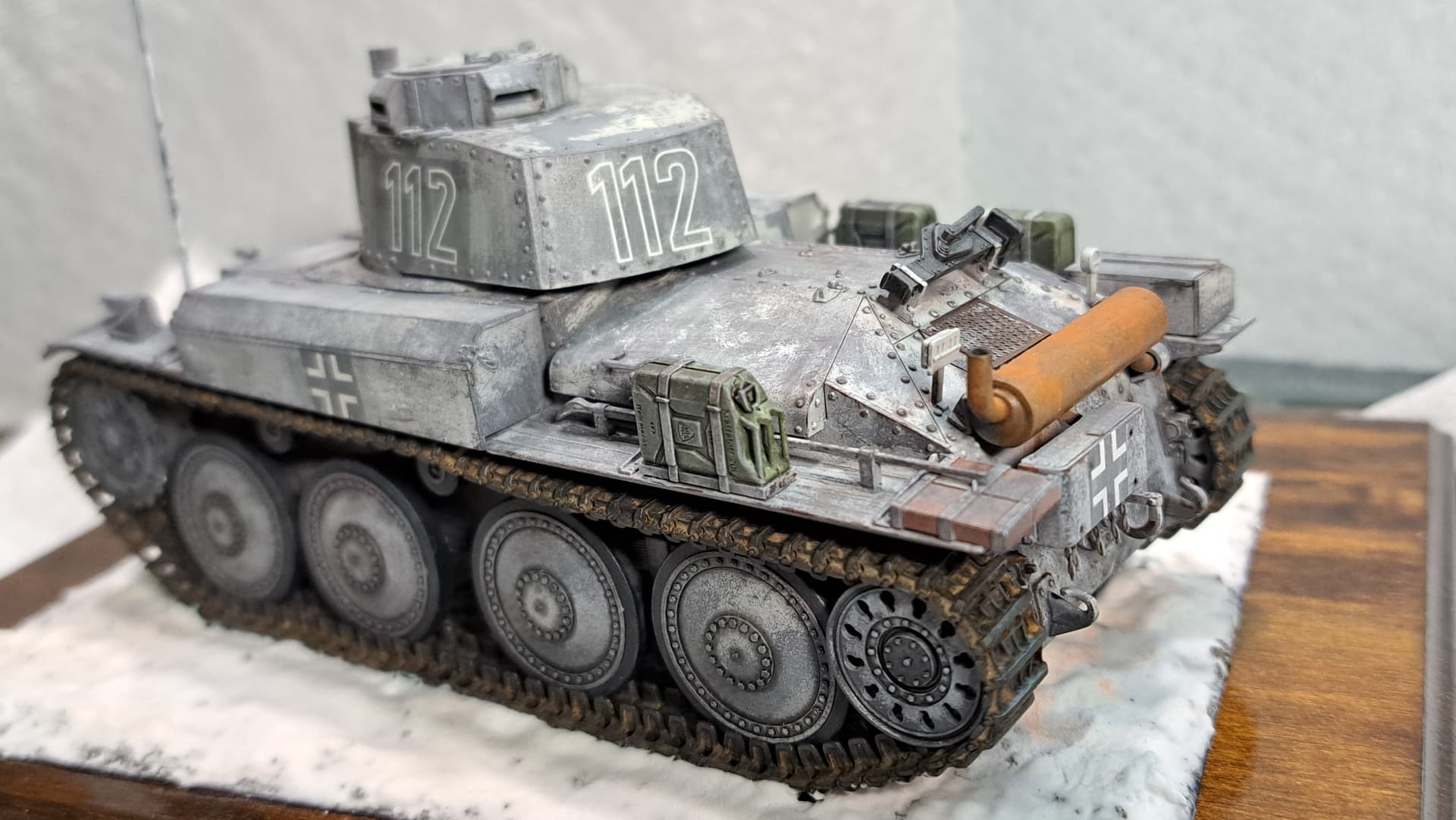

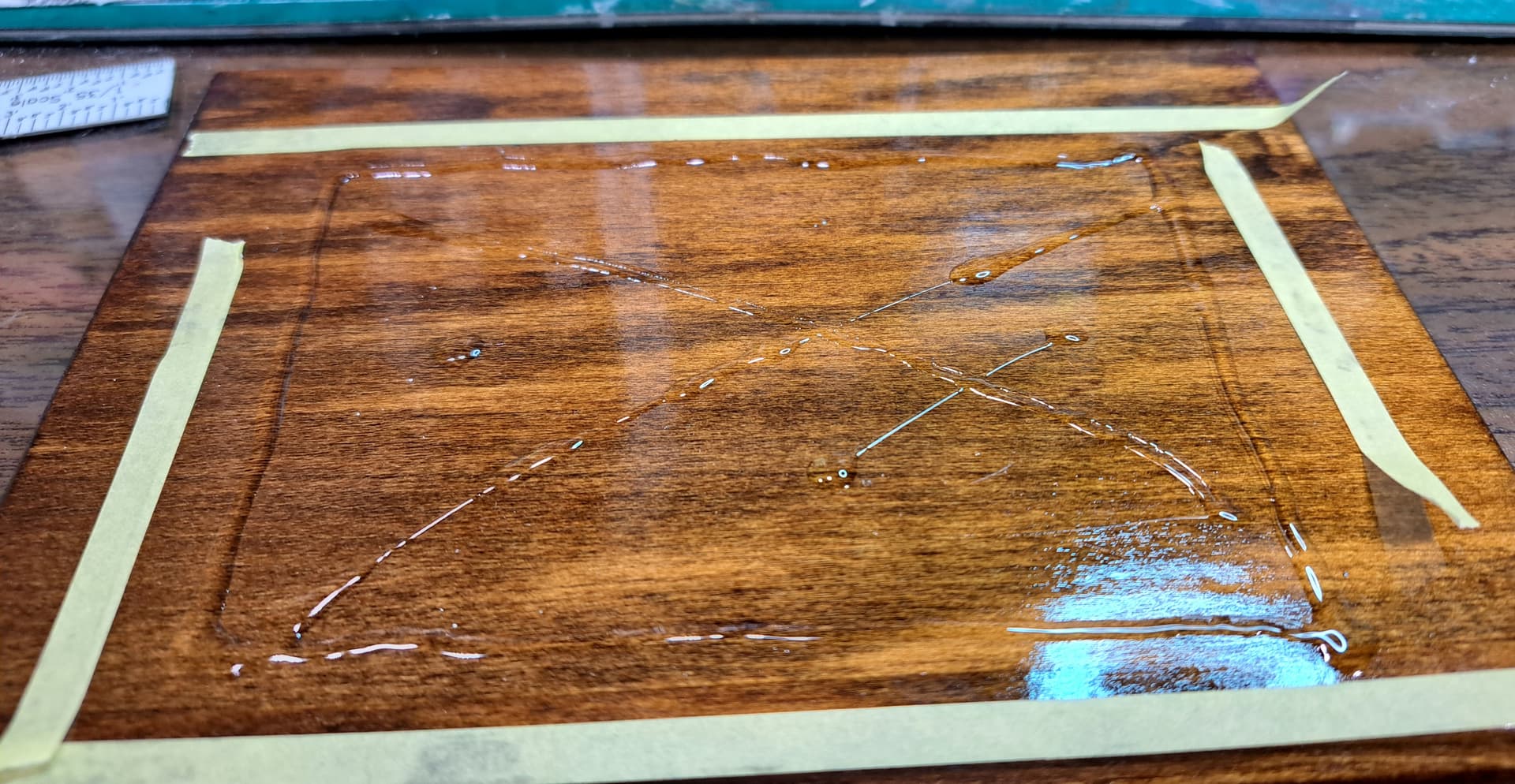

Today added pastels to muffler, exhaust pipe, spare tracks plus some AK Snow Sprinkles. Measures and marked where the plastic card would go on the base.
Used washi tape to mark boundaries so I’d know where the glue should go.
Happy to wrap my first winter ground work in decades and first Pz 38t. It’s also good to have #1 completed for 2024.
May add tank name plate at later date.

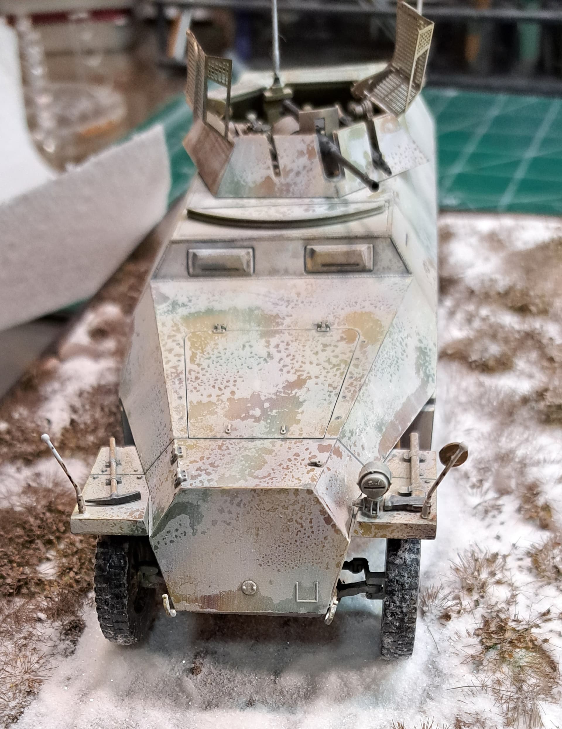

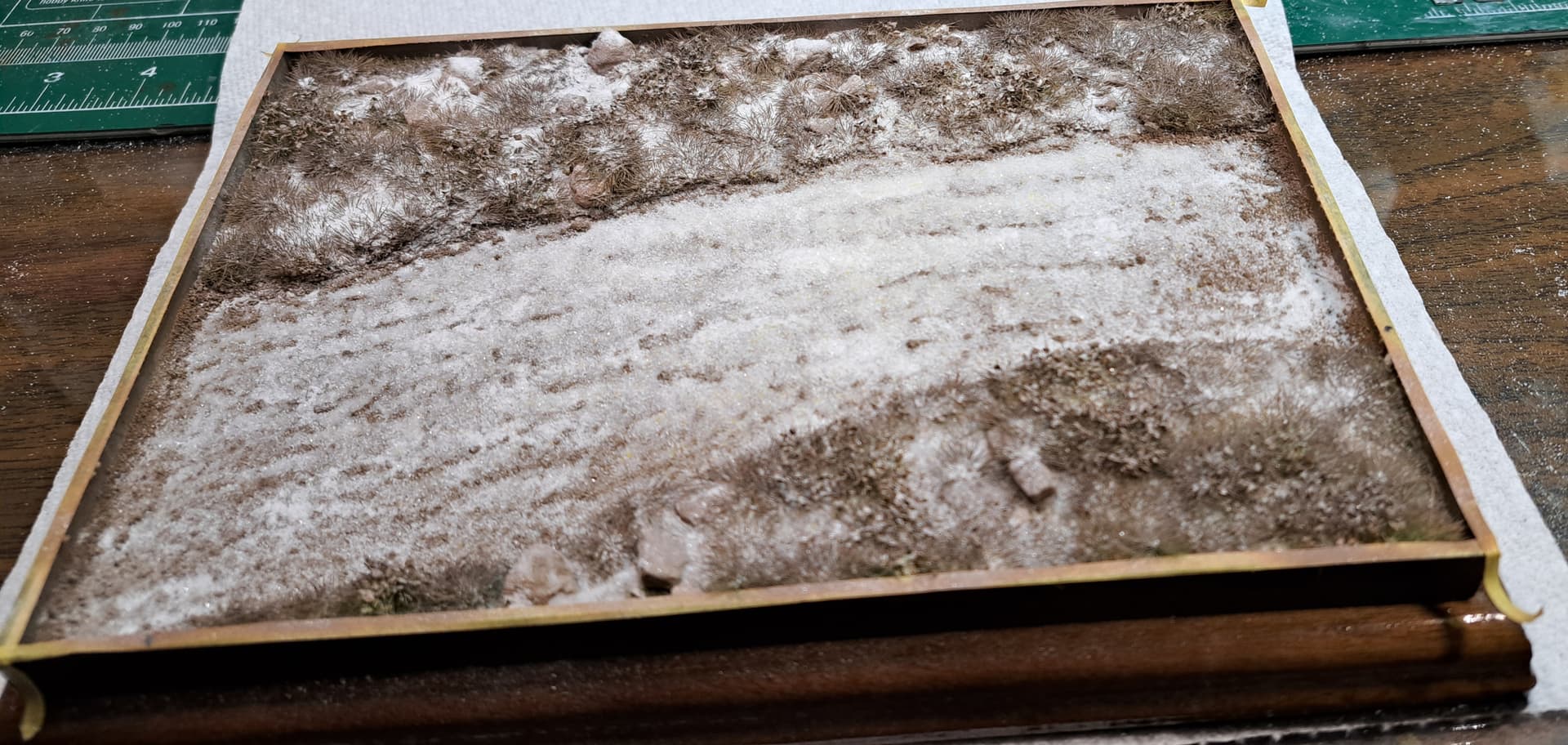

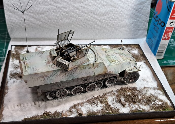

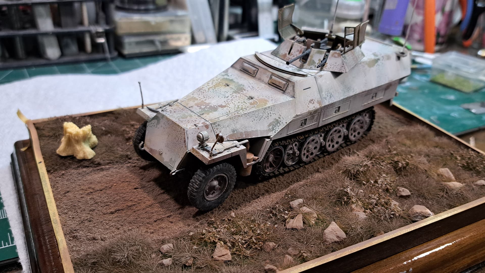

Settled on this composition for the 251/23. After my experience with the AK snow products probably going to do majority of this with white sand and VMS ballast freeze. Will use the AK products for the finer points.

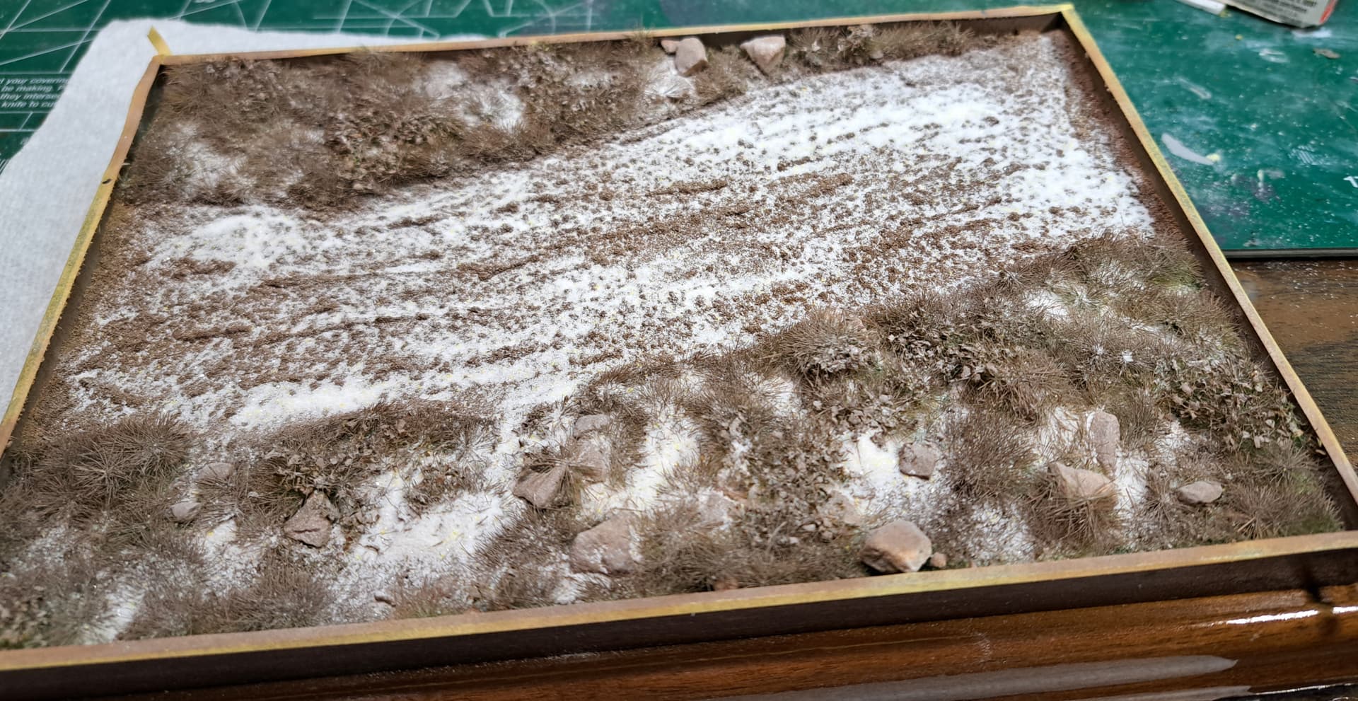

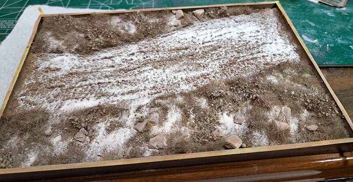

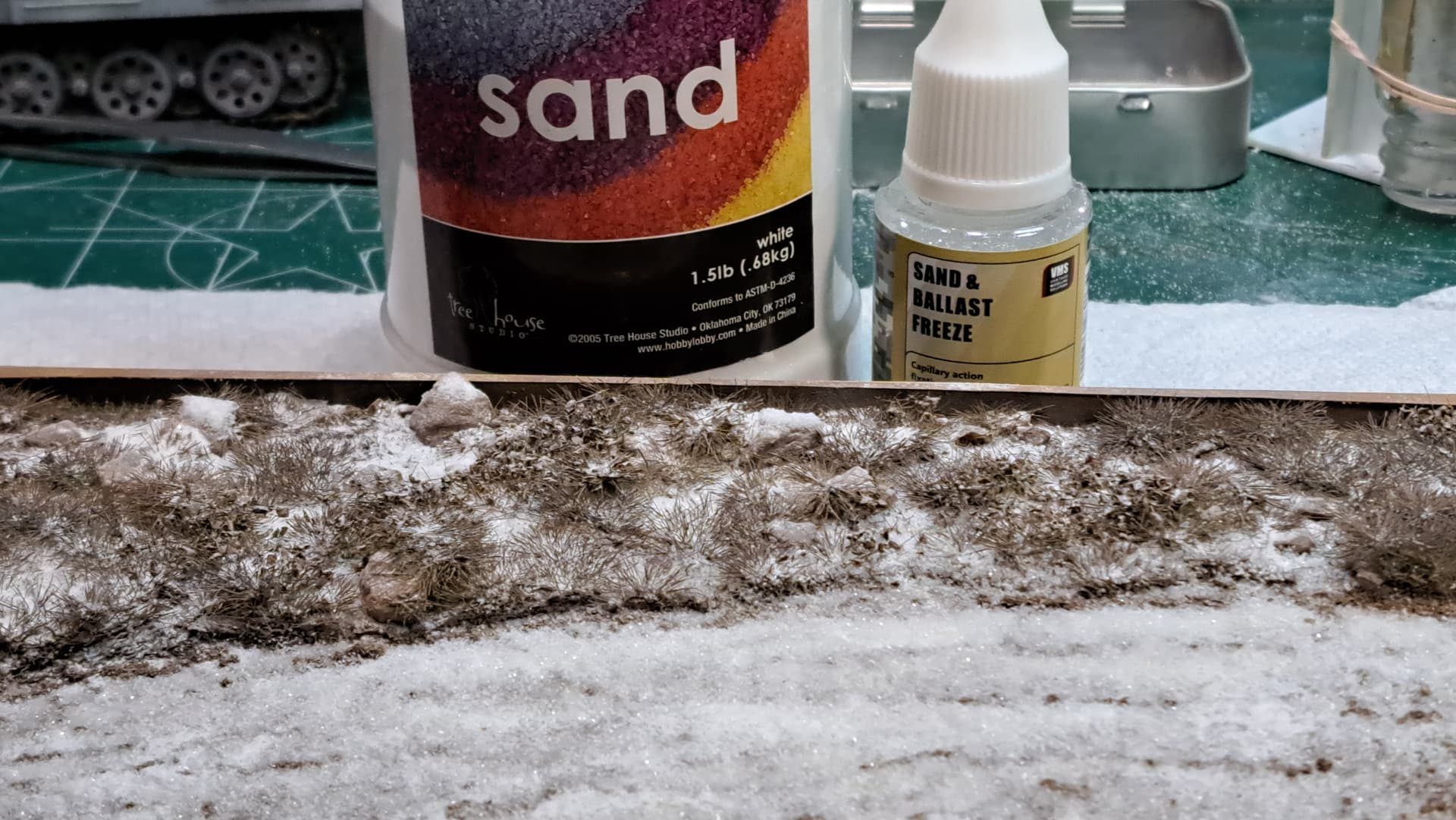

Based on the experience with the small plastic card base, white sand was shook over the large base wirh ground work. The base was shaken several times to settle the sand before another round of sand was shook over the base.
After third round of white sand shaking and VMS Ballast freeze. Learned very quickly, rhe VMS bottle tip should be held just barely above the sand before dispensing a drop of fixer. If it’s held more than a ~3 millimeters (modern units) or 1/8 inch (freedom units) above the sand the drop’s impact will cause a wave ripple in the sand like a stone skimming on water. However, it doesn’t self level afterwards.
Snow effects are all Hobby Lobby white sand & VMS binder.
After this all dries, will try to integrate the 251/23…
It’s spring time, I don’t want to grab a coat. That ground looks cold. :+1:
Thank you, Ryan! I appreciate you taking time to comment. I’m very happy spring is around the corner.

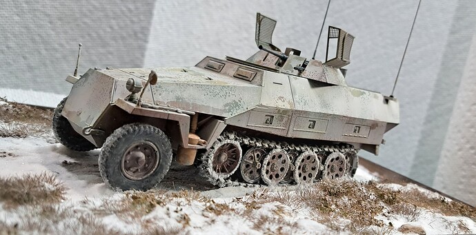

More white sand and VMS freeze plus the 251/23.
Letting it all cure overnight…may be add a little AK snow product to the tracks in the morning.
Soapbox -
For me the AK snow products are all three very difficult to use. The microballons are like ultra fine dust and look flat but will form nice snow rifts. No idea how to freeze those rifts in place as they all scattered when I tried. The Terrian looks nice when applied but its like trying to paint with a tube of toothpaste. Water helps but I honestly hate this product it’s so difficult for me to use. Yes, I watched the AK videos etc. Snow Sprinkles looks like snot and it applies similar to a wooly bugger. I don’t like working with it either. Other folks may be able to use these three AK products with ease. If so I hope they will share any tips they know.
I like the simplicity of the white sand and VMS freeze. The sand pretty much goes exactly where I want it without much fuss and it’s is easy to secure in place. Loose sand is easy to clean up.

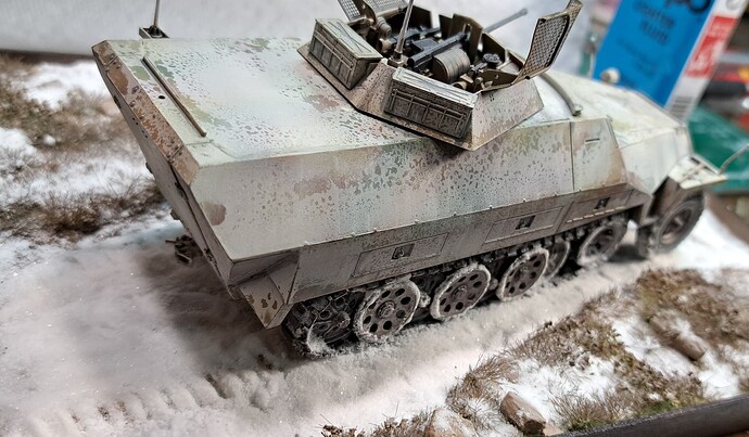

I like the effect you got with the white sand though, I just think that the track marks wouldn’t be as snowy as you made them.

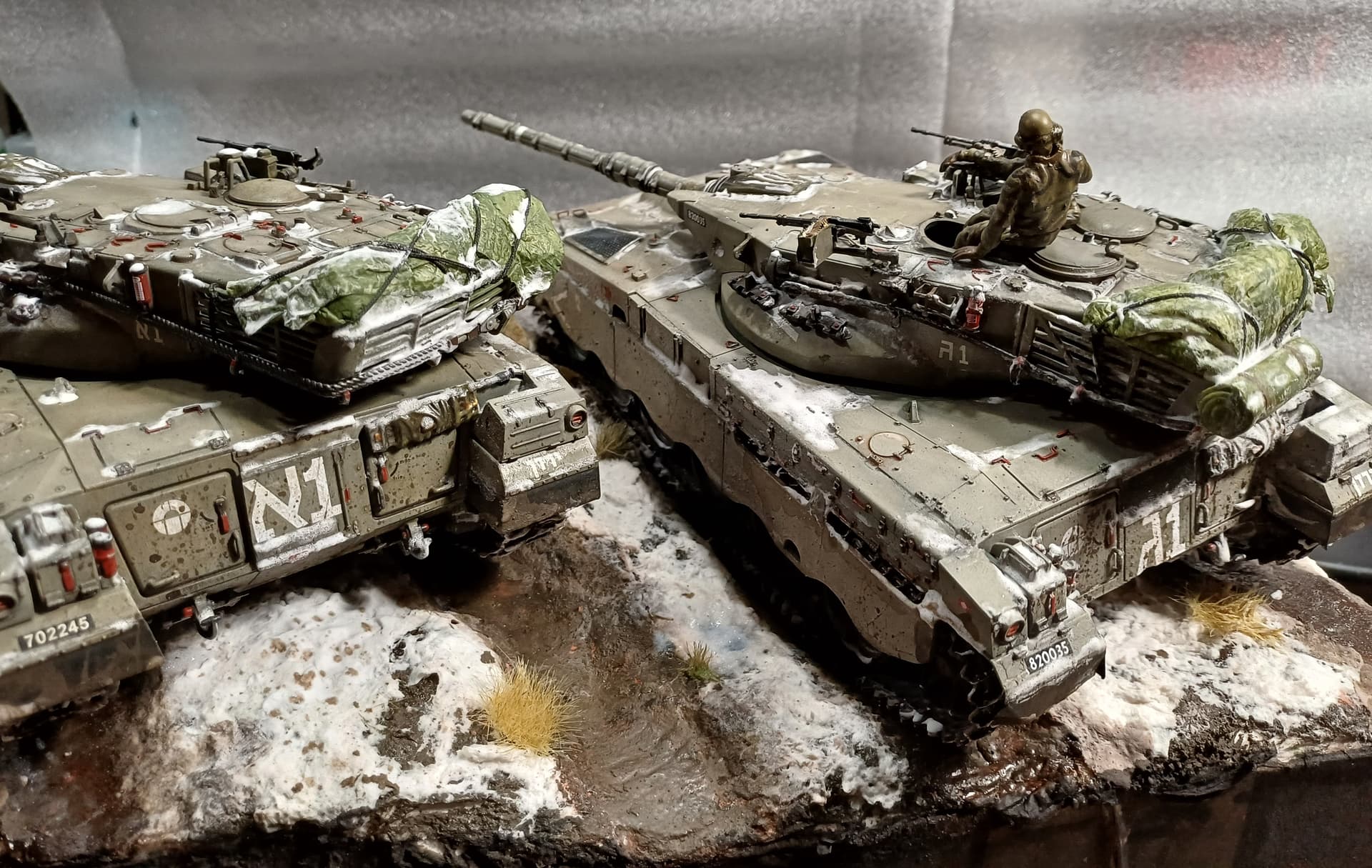

A little Golan Heights vignette? I spent 6 months there (Syrian side).
Bert, that’s an outstanding looking pair of Merkava’s! Very nicely done! The snow looks great. It had to stressful applying the snow!
Agreed, the 251 tracks in the snow need tweaked. Thank you for the AK snow tips, they will be very handy. One of today’s goals to try and work a little snow into the suspension…

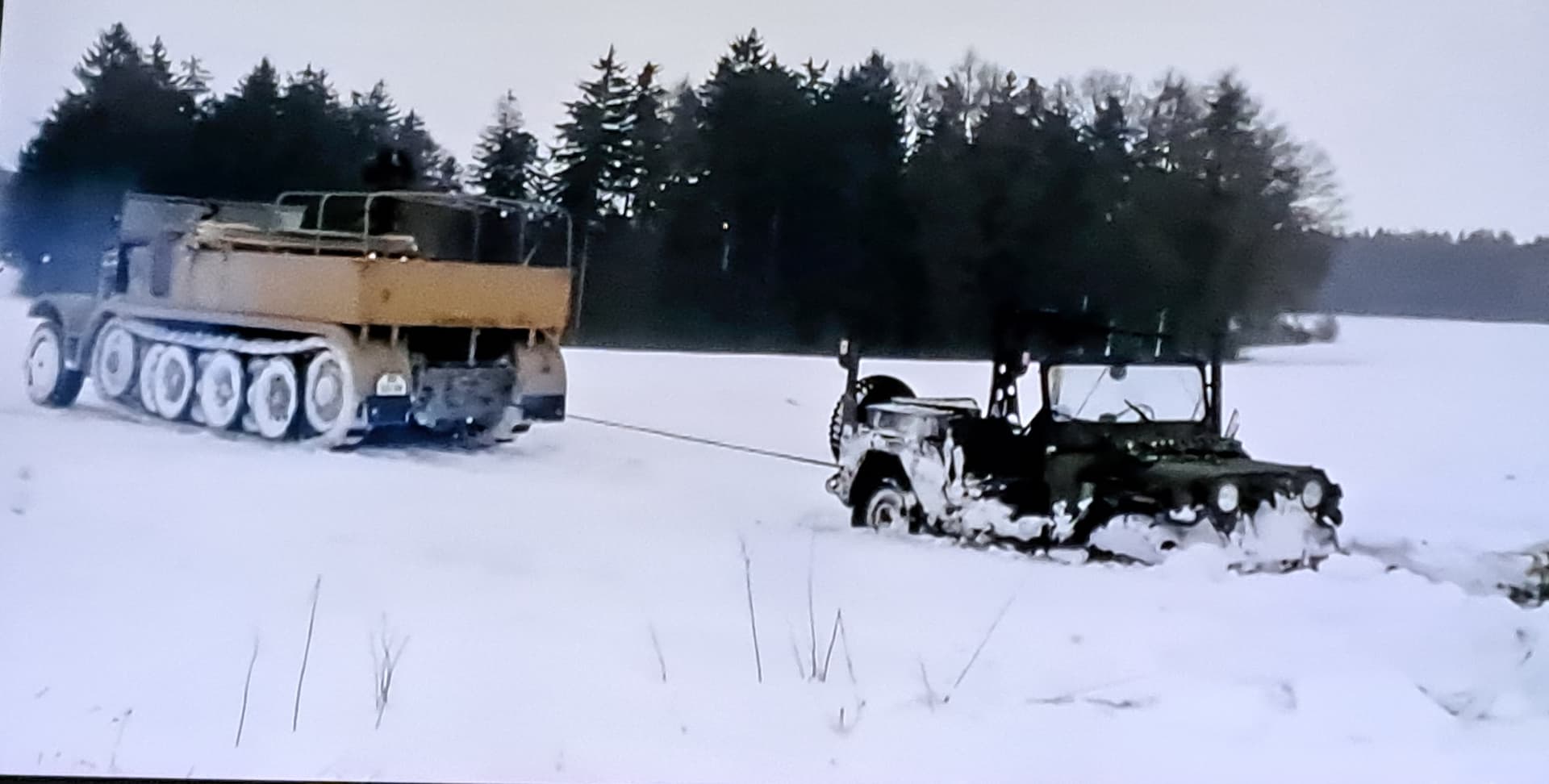

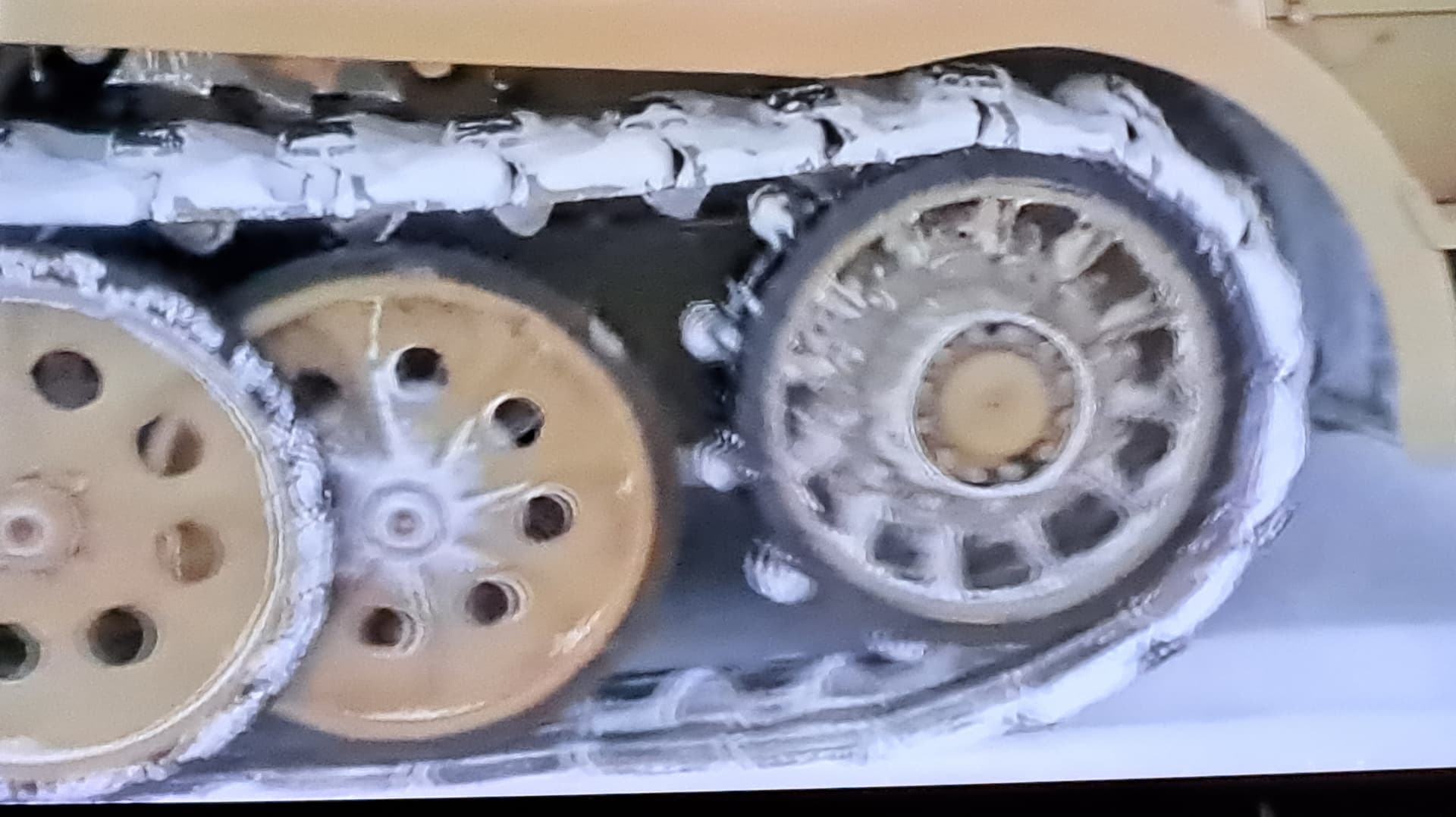

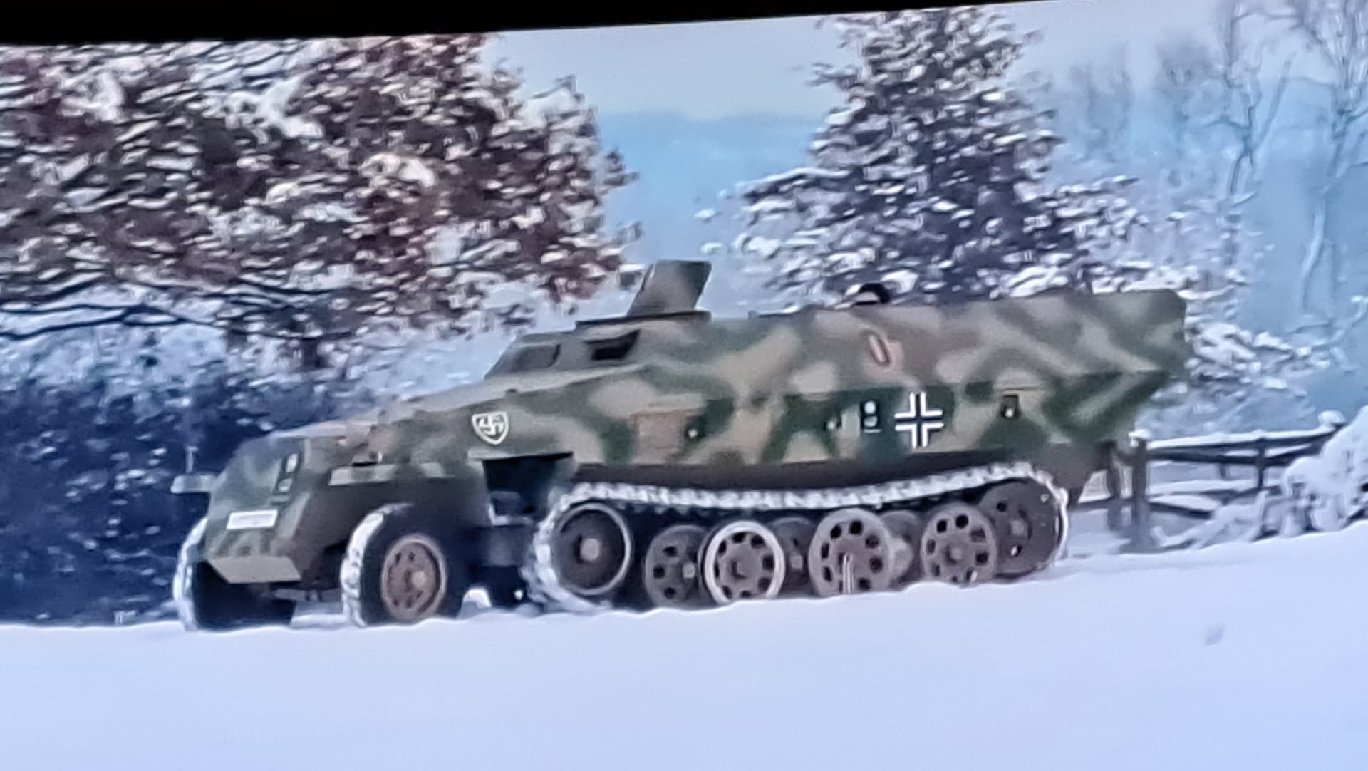

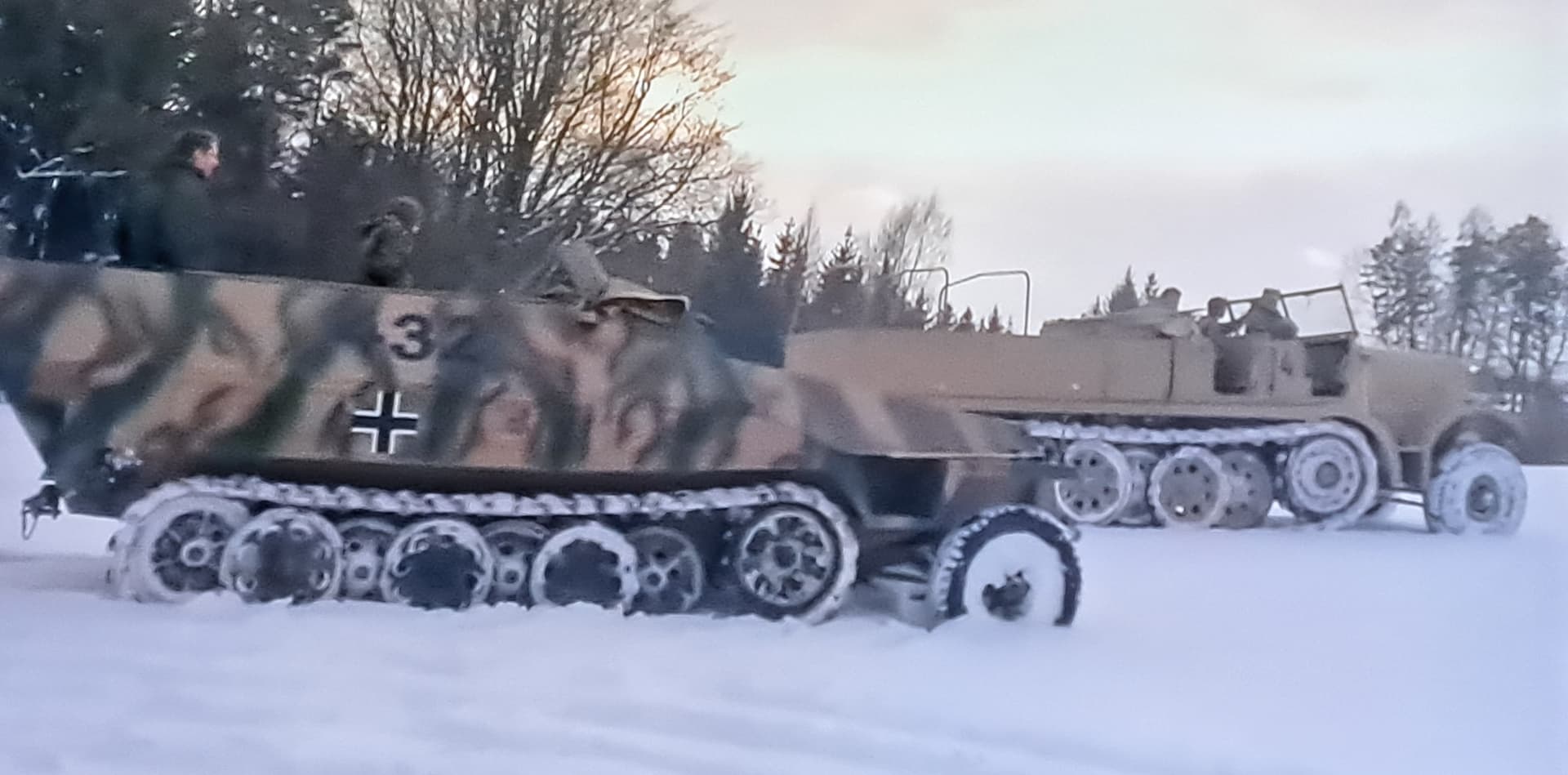

Naturally, if adding snow to rhe suspension is a goal, the question becomes what should that look like? I found these two videos very informative, as one gets to see a 251 zipping around in snow.
Weald: Restored 251/1 in the snow
Vintage Military: Winter Warriors Rides aka Famo & friends playing the snow
A few captures from videoes for reference and discussion.

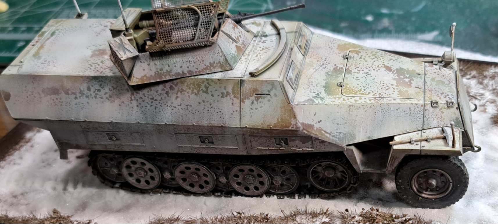

I hope to be a little more conservative given there’s less snow on the base for the 251/23

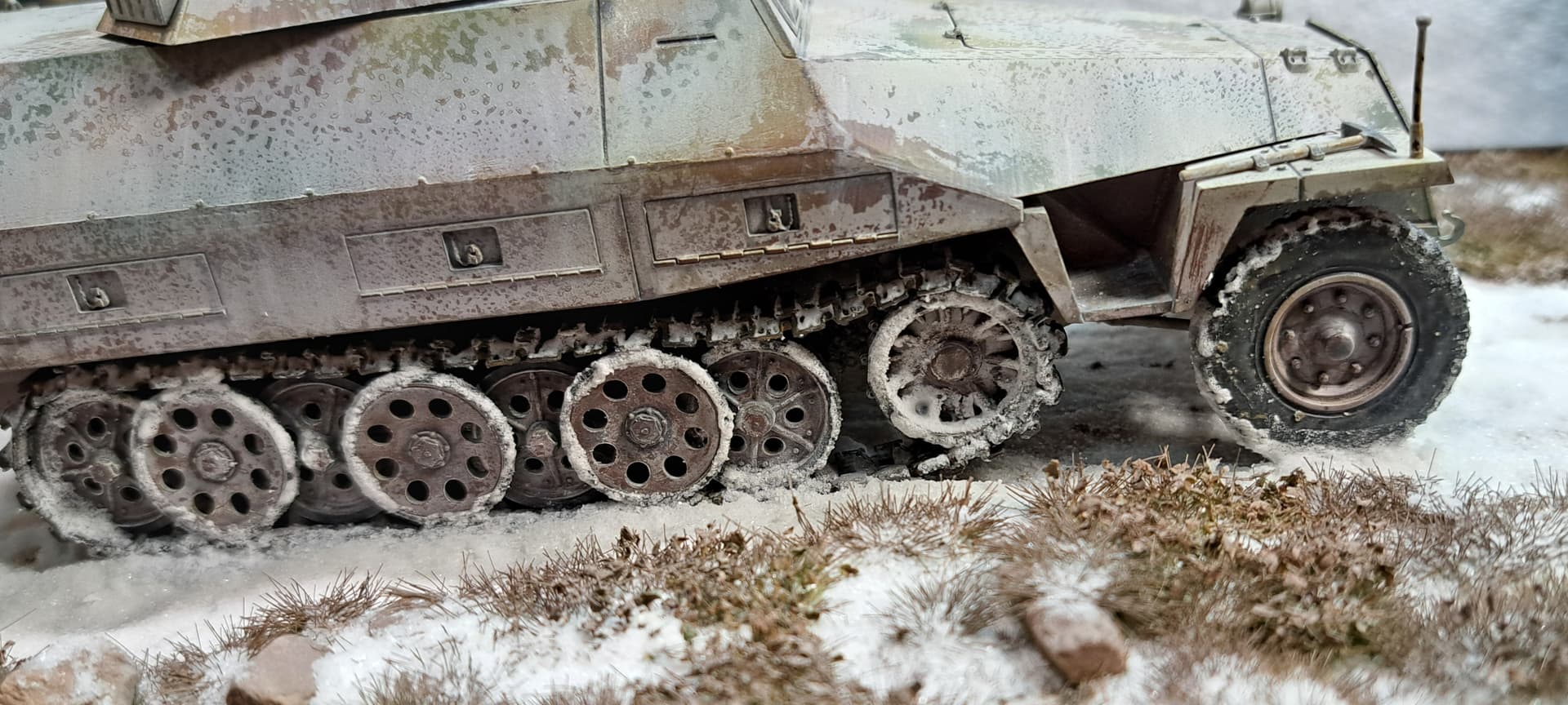

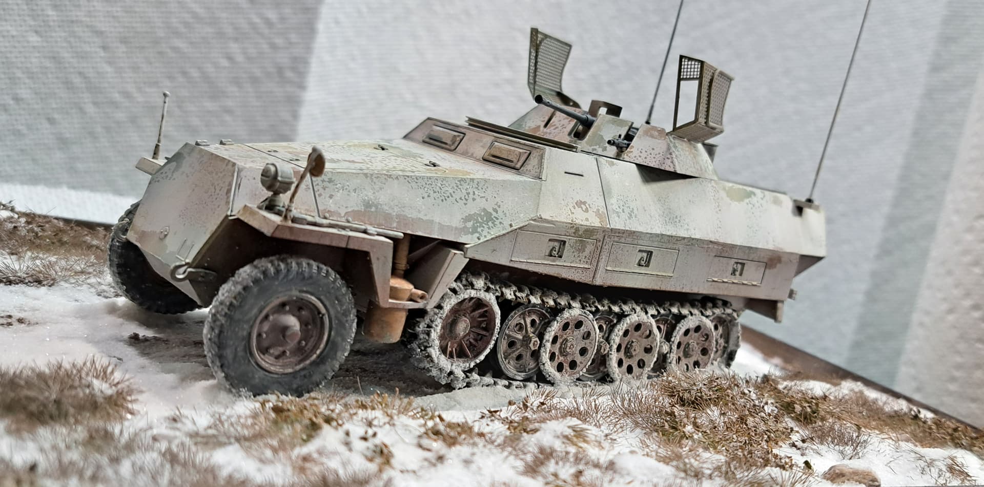

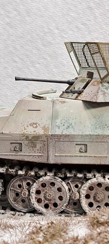

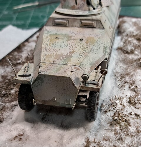

Calling the 251/23 wrapped, making two completed for 2024.
251/1 screen capture provided my key inspiration for adding snow to the 251/23.

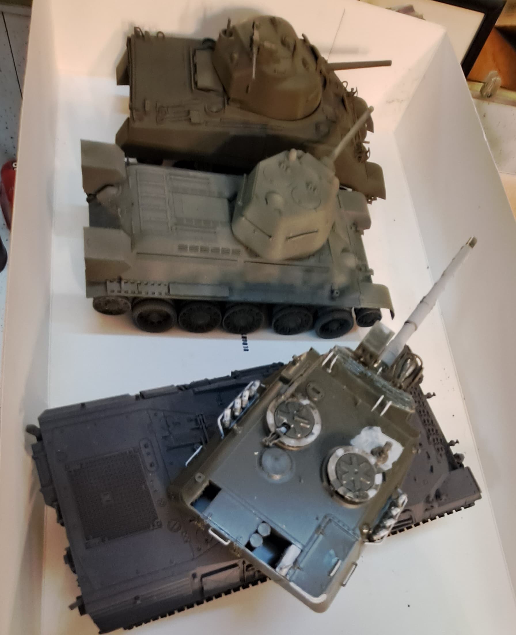

Last eighteen days of building have probably been my most productive model building ever…
…but there’s so much rain, painting outside is off the table…
…with all the new Puma’s released from Ryefield, Mini-Art and Dragon’s updated one, it’s definitely time to slam the stashed Puma together…
Off to the races…

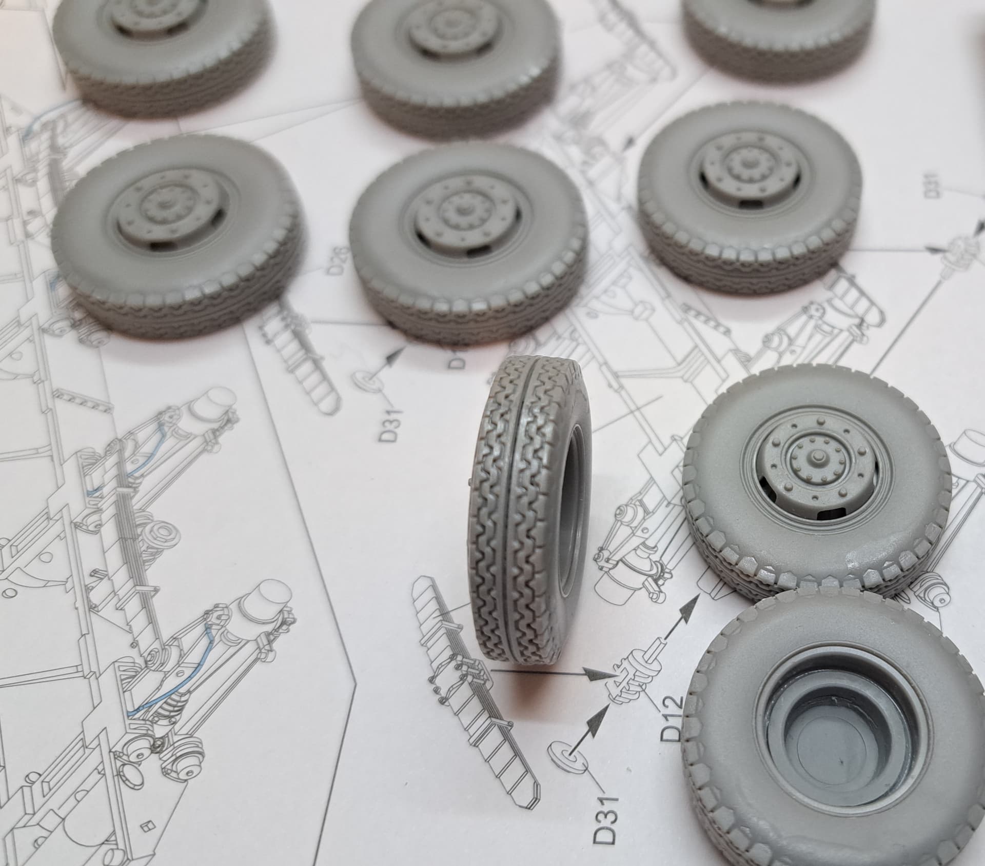

I’ve heard many good comments about this specific Dragon kit over the years and been delighted they seem on the money!
Decided to do the wheels first, there’s two styles to choose between which is sweet. As many others have said Dragon nailed it with their seamless wheel design. A+++

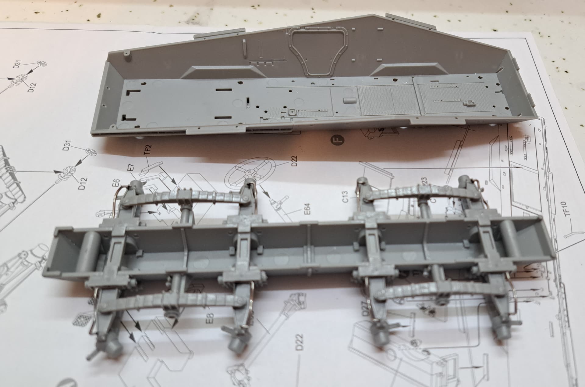

Full throttle modeling…steps 1 to 7 wrapped. Nearly all of the interior parts can be skipped since the model will be displayed buttoned up.
I had to triple check the brand name on the box. Best building 1/35 Dragon AFV kit, I’ve seen to date.
