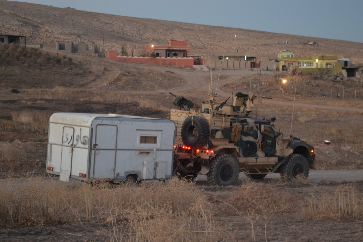

This is the vehicle that I’m taking inspiration from.
It has a partial camo scheme that makes it different from the usual sand yellow painted M-ATV’s.
I have seen pictures of other vehicles with a similar camo scheme, if I’m not wrong they have been used in support of Kurdish forces in the final phase of the fight against ISIS.
There are some very interesting images out there of the 1245 in camo colours, if you go looking… It was a forlorn hope of mine that Ryefield would do the SF version for that reason…
