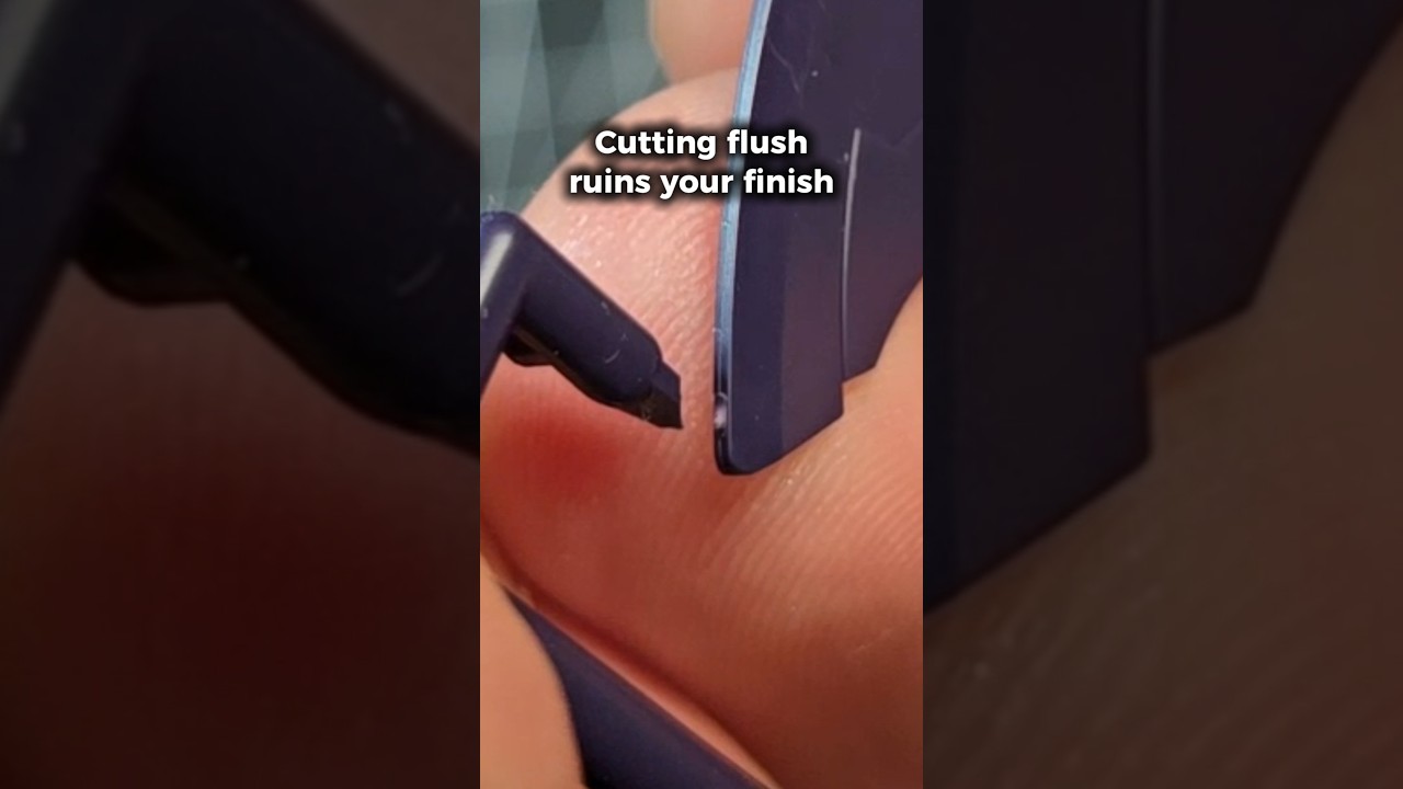

Some dude about why he doesn't cut flush
I think with some parts from manufacturers like Miniart or Bronco you should still use a micro saw to remove parts, imo.
Or just place the nipper slightly away from the part and leave a little nub to take care of with a file or something. I find clear parts dislike being cut flush a good deal of the time.
I do that too. Cut away from the part then file down.

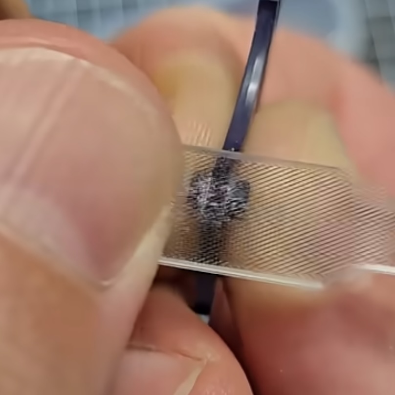

Did he use a clear file?? What was that??
The name of the photo is glass-file …
My wife had one of those as a nail file,
hers was opaque and whenever she
happened to drop one I had to vacuum
glass splinters off the floor …
https://www.amazon.com/glass-nail-files/s?k=glass+nail+files
Those look slick :star_struck: Just a reminder to the members here that my bday is coming up in October :grin:
I’d have a sort of anxiety that if I put too much pressure on the work that it would shatter in my hand.
The only reason for a see-through file is to show the filing action in a video.
Filing with a fine metal file (nail file) works just as well, just work slowly to avoid
filing too deep. After a while muscle memory will take over and know how
much pressure to apply and when to stop.
After a while there is no need for a visual inspection, the finger tip will feel
if the surface is finished when sliding the finger over the place where the
nub used to be

Hm, now I feel odd, I never cut flash, always use the file for the last milimeter… Maybe I like to file? On small parts I scrap or use my Dremel with a silicon polisher grit wheel

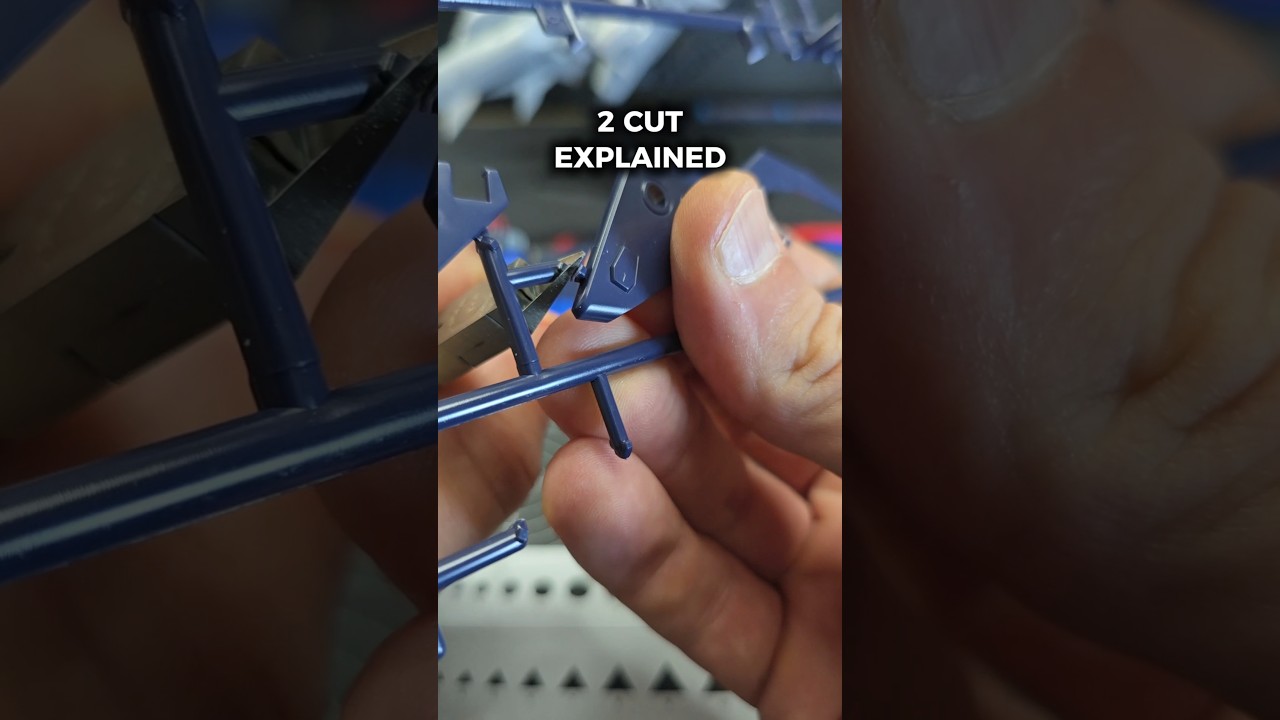

From my experience it is not advisable to cut flush… the first cut. I use these type of nippers, cut leaving 1 or 2mm and cut again flush. Minimal clean up necessary then.
This files are great, quick and easy way to get a very smooth finish

What hasn’t been mentioned is that with certain manufacturers, a flush cut can result in taking a slight divot out of the part, which then has to be filled.
Can you tell us how that works and where we can get it?
When two wedges are forced into a material, one wedge from each side,
the material will get stretched. The flush side of the cutters glide along the
part while the wedges on the other side are forcibly pulling the sprue gate
out of the part. When the cutting edges are halfway into the sprue gate and
have cut half of it the remaining half is still being pulled out.
This will leave a scar, the size of the scar will depend on how soft or hard
the plastic is. If it is very soft it will “flow” and leave a very small scar,
anything can happen if it is very hard (brittle).
I make the first cut with the wedges facing the part, i.e. make sure that the
ugly scar is on the sprue, not the part. Then I can nibble away at the remaining
stump and use a file or sandpaper stick for the last bits.
There are usually mold parting lines to sand down so the extra swipes with the
file don’t add much work.
Try cutting some sprues and take a look (use magnifier if needed) and the cut
afterwards. The outer edges will be smooth and there will usually be a rough
section in the middle where the plastic has been torn apart.
Saws are the only tools that are guaranteed to cut without leaving scars since
the saw teeth removes plastic at 90 degree angle to the sprue instead of forcing
the sprue apart.
along the sprue.
