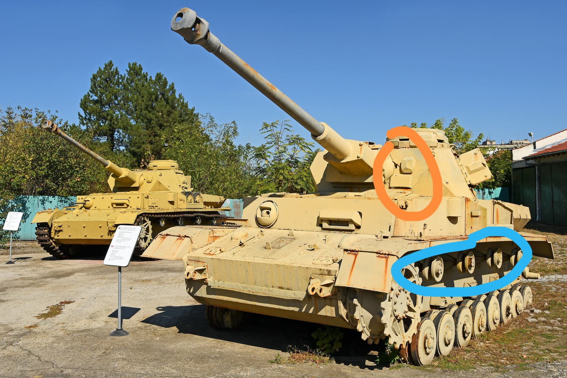

Some questions about pz4 in this picture
Dear friends,how to describe the rollers in the blue circle? I’ve been confused for a long time. And did the small piece of welded armor in the front of turret exist during ww2? Or just used by the museum to strengthen the integrity?
“Track return rollers” or only “return rollers” would be the most common name in English.
That little plate is original design.

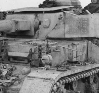

Extract from this photo dated 1943.
This tank also had spaced armour on the turret roof
Edit: Were you asking for the specific type/parts name for that specific design of return rollers?
@Uncle-Heavy Thanks so much​:beer::beer:. Actually I not only don’t know “return roller” but also the specific design. The special roller base seems to be welded too, varies from usual casted ones
Regarding the 2 plates on the turret front, the upper one is a hinged “Observation Port” (per Spielberger), earlier PzIV’s had one on both sides of the gun,note the vehicle in the background has one also. I have no idea what the lower rectangular plate is, have never seen one on a PzIV, and vehicle in background doesn’t have one. Anyone have more info?
The box at the bottom of your orange mark is not usual. I believe it’s to cover a hole.
As for the return rollers, they are the later rubber-saving one introduced after October 1943 (Gummilose Stützrolle).

The return roller supports on the right side are different…
Panzerwerk has a few different rollers
Link to ModellBau König
Check their product images to get some names

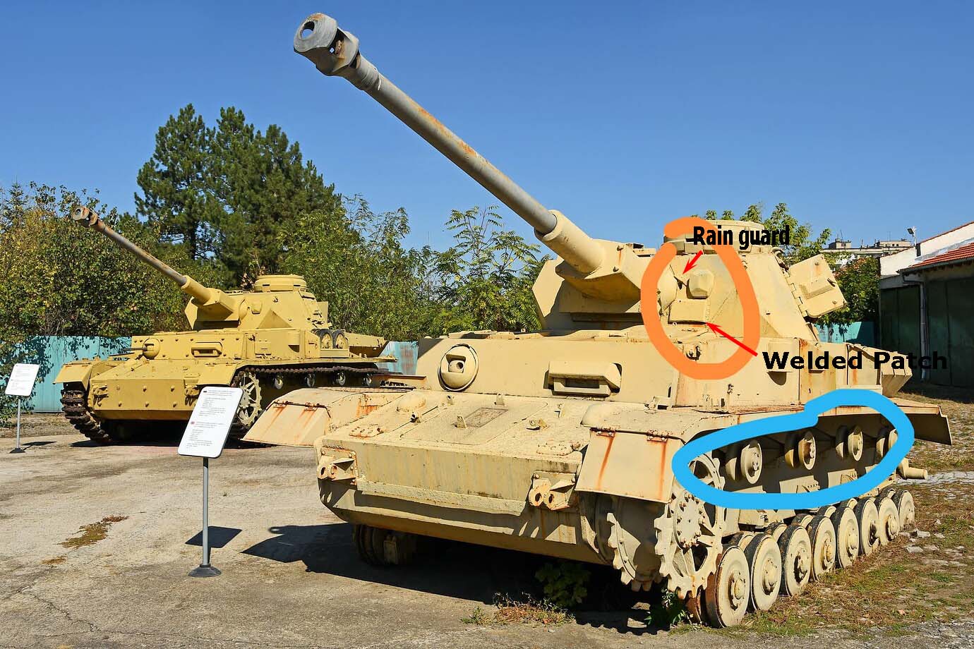

Not exactly sure which object is in question, but the larger rectangle is a workshop-applied patch covering a penetration hole.

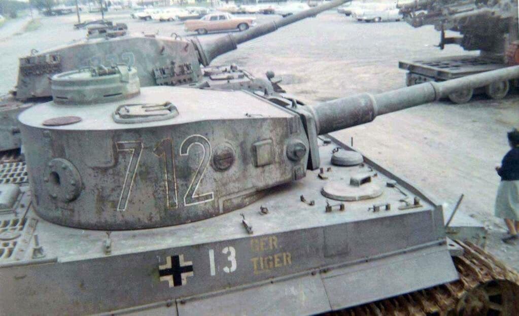

The same as seen here on Tiger 712;
Of note also is that this Panzer IVJ has all steel road wheels. This is unique.
This thing is a cobbled together mess. All steel road wheels, blocked off turret vision port with welded cover plate on one side, late-style turret doors on the other, early-style front tow shackles, late addition rain guard, two different return roller styles, aftermarket exhaust…it has got to be a post-war Frankenpanzer, or at least a workshop rebuild at the end of the war, using whatever parts were available. Note also that it still has all the bolts on the boogie assembly housing, a Ausf H feature at the latest, Ausf J deleted the two top center bolts, final J’s deleted the bolt holes. It also has the earlier style idler wheel housing, found up to Ausf H. No remains of schürzen to be seen on the hull or mudguards, but the mounts for the braces can be seen on the turret.

The armor patch on the turret glacis must be a penetration cover.
